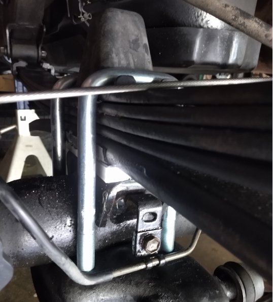

    I put in a shim with AALs like @Blue92. I'll be damned if it didn't smooth out some of the drive train vibes. Somehow I think I just hit the right combination.

    a wedge shim to change the driveline angle? ive got no vibes. just a soft rear.

    Yep.. A set of these in the picture.

    I think I've dropped that tip to absolutely everyone. It's really where the pinion should be stock but the truck sit so flat drivetrain wise that Toyota rotated them down stock.

    i install plenty of wedges at work for 2nd gens with vibes. never needed them on my own trucks though
