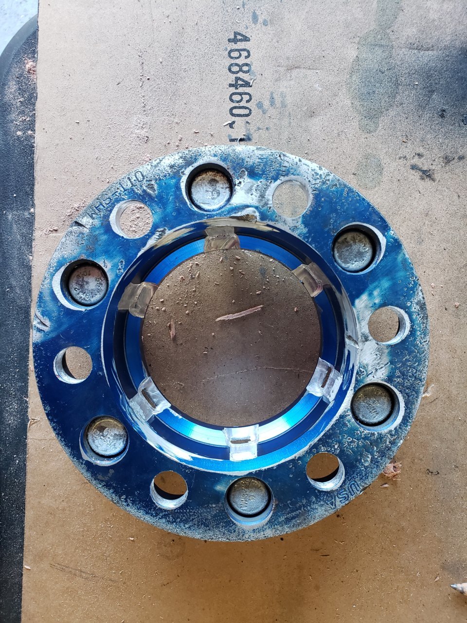

    It's less Tacoma and more mod
    Take em to a machine shop and tell them to open two of the IDs to 107mm prob solved

    Use a router to machine the lip so the hub studs fit and they can still be hub centric
    Running lug centric spacers on the front with hub centric wheels and they aren't great

    You don't have to do that... you can modify them.
    I had to mill pockets for the hub bolts to clear.
    If you want to run spacers without having to modify them, you'll have to run lug centric spacers instead of hub centric.
