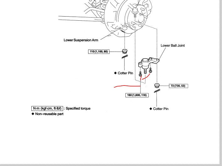

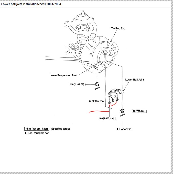

    am confused too. I think it might be a 2 step tork process. that picture is terrible.

    No its all the same spec just different units of measurement. Us the last number in each row

    You are the only one who found a number for the upper castle nut! The number I have for the lower castle is 105. How can this be so hard?

    Oh I see the mixup now with that diagram we were looking at. Thanks for clearing that up

    I came up with 2 different specs, i bolded them above.
    I see what I did wrong with that diagram. That line going to the 116 number was going through the dotted line pointing to the 2 mounting bolts and I thought it was pointing TO the dotted line.
