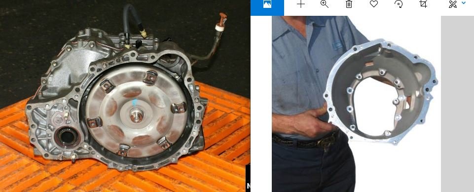

    Left front reman binds bad. Don’t like it. For new oem I might as well bmjist get rcv

    This 3rz bell housing adaptor (Marilin) was the best straight on shot I could find on the w59.
    a140f pulled off of fleaBay.

    Considering I can’t find good info on the 5vz swaps I don’t know how they get them to fit. There’s no mention of adapter plates, just removal of dowel pins on the e153 transmission.

    Also with fwd the engines are tilted back. Starter location on the w59 looks to be in the right spot.
