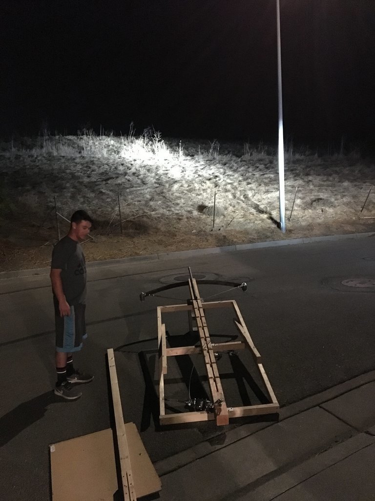

    All this talk of Leafsprings reminds me...
    I built a Ballista (or what essentially is a giant Roman siege weapon, similar to a crossbow) for an Engineering project a while back. I used a 2nd Gen Tacoma Leafspring as the tensioning mechanism.
    I designed it to shoot 1/2 inch EMT conduit. A 3 ton Cable winch was used to tension it. It could shoot a projectile 50 yards.
    We used my KC LED’s fog lights to light up the hill.
    Here’s a different one in action.

    We got a B+ because on the last trial run, the lag bolt snapped and flung the conduit into the air and almost impaled my classmate.

    My original plan was to buy a cheap trailer and weld an over-engineered all steel Ballista onto the frame. But they wouldn't let me drive my truck onto their brand new Astroturf football field, so we had to make it portable.
    Keep in mind in the end, we had a 5x10 foot framed wooden Ballista made from wooden beams meant to hold up structures. Everyone else was using popsicle sticks, Elmer's glue, and bungee cords to complete their Roman siege weapon project.
    Our project was so overkill and dangerous, our teacher actually banned car suspension from ever being used again. Our next project was to create an instrument capable of hitting a certain tune, we ended up building a tube device similar to what the Blue Man Group uses.
