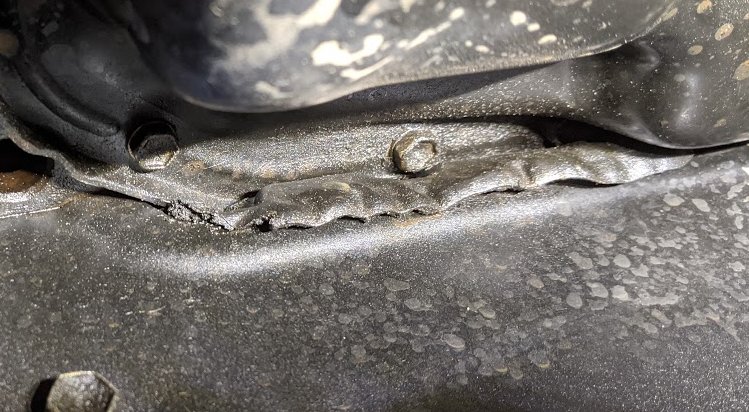

    thanks brother... appreciate it. Can't really look at it today but going to spend some time on it tomorrow. I almost wonder if (back when I was paying someone to do work), the mechanic used some type of sealant to 'cover it up'. It being a leak. Anyone know if there should be a bead of sealant there?
    I did have the oil pump start leaking some time back and he replaced it.

    Last spring when I had a local shop (now OOB) pull my oil pan to look into my rod bearings, they smeared more RTV on the windage tray than they got on part that actually needed to be sealed. So I pulled the oil pan, cleaned it up, inspected the bearings, then put it back together.
    Oh and then they left off the bracket that holds on the passenger side full moon. So the full moon popped out. After that, it leaked 1 qt of oil for every 5 miles of driving.

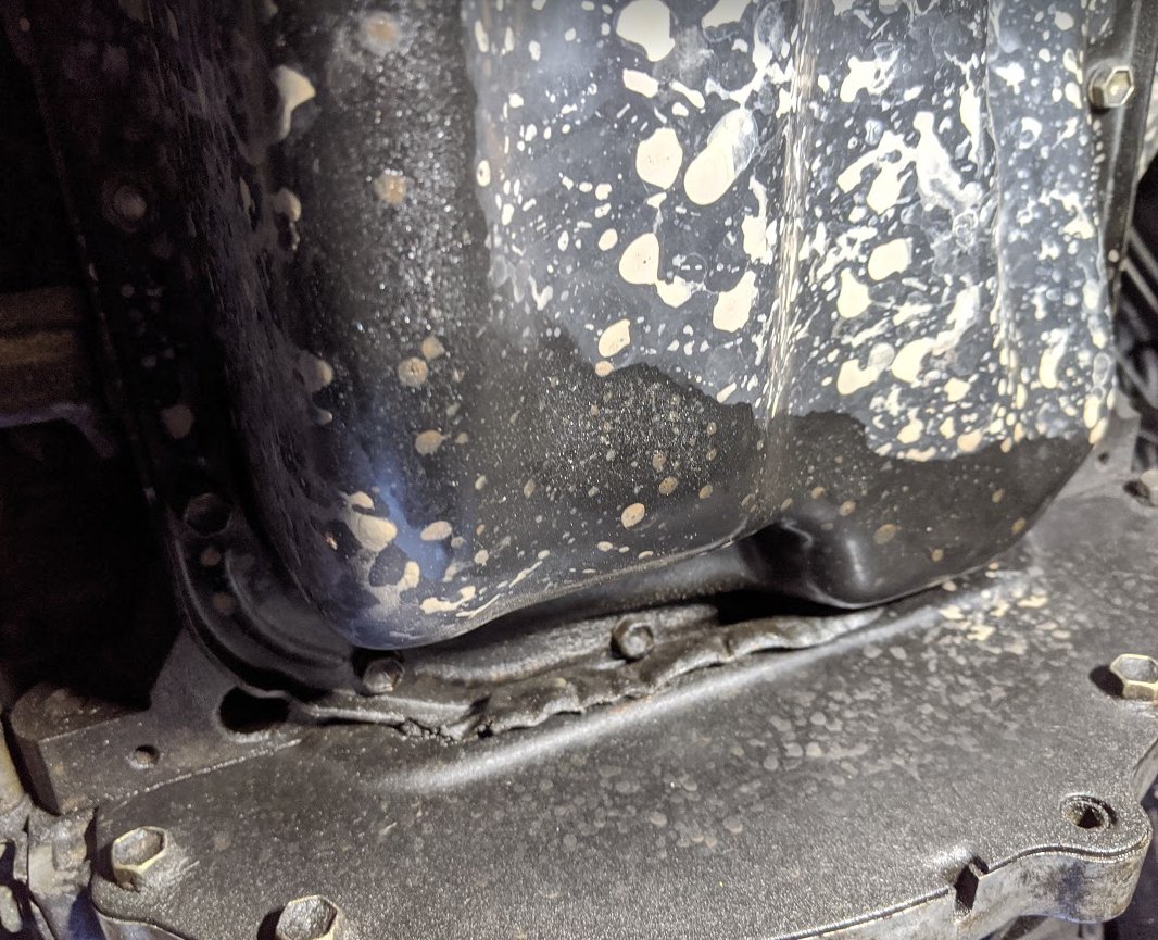

    Starting to think its the valve covers. I do have a slight leak on the passenger side towards the rear. Could also be the 1/2 moons(?). Most heavy around that one ground lead. Looking at the oil pan it appears its all building up at the rear and the evidence of leaking is has worked its way down towards the drain plug.
    I don't know. Last thing I want to deal with is an involved job at this point. I'm tired. I just want to go fishing.

    I would take a mechanics mirror and give the back side a good look.

    good idea. will try that. Here's what I can see now -
    good times...

    Valve cover gasket time.
