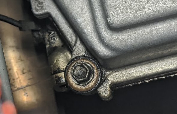

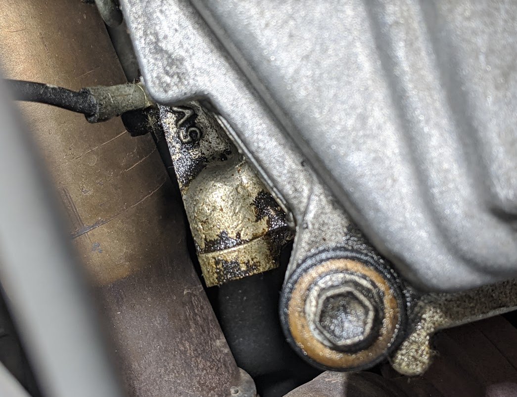

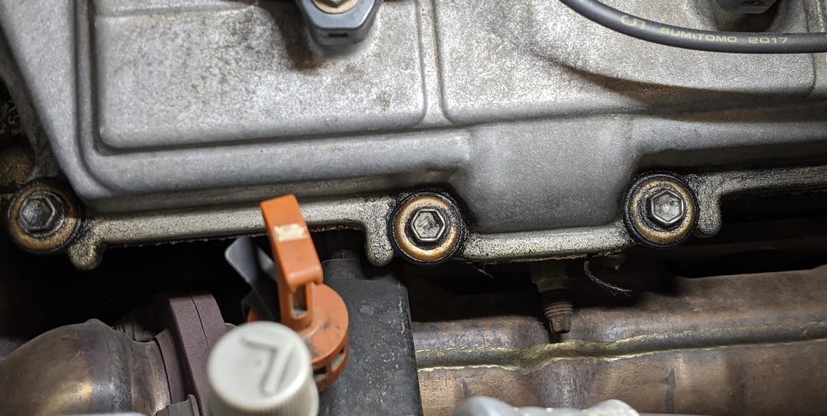

    Mine is the valve covers and collects right where yours is. It just runs down the side of the engine from the passenger and driver rear on mine. It's been doing it since July. I ordered the parts from Camelbak Toyota in November. I've been waiting weeks for the valve cover grommets/washers to get in from another dealer since Camelbak doesn't sell them. Should've just got Fel-Pro on Amazon.

    I've been putting it off :(. It's been done once before but this time, I'm going to do it. Wonder if I could get by doing the passenger side only (?). Driver side is dry as a bone.

    My valve covers were leaking a while back, turns out my bolts were loose. I tightened the bolts a little and the leak stopped. I'm hoping they stay put till spring when it warms up and I'll pull the covers and change the gasket. You might check them, it could get ya by for awhile.

    I don't see why not. If it ain't leaking, why bother it now?
    On four of my cars (now only two), before I switched to FelPro blue, the VC under the intake plenum would always be the 1st to start leaking on the exhaust manifold. The burned oil smell would always make its way into the passenger compartment.

    yep, did that. passenger side was loose. didn't want to tighten too much since it would've just crushed those silly designed seals even more. worked for a bit but now its leaking again. thx though. :thumbsup:
