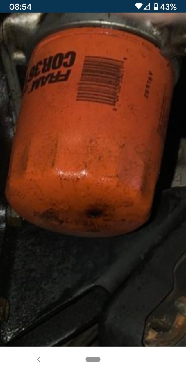

    Do you have any oil on the filter itself? Whoever changed the oil may not have tightened the filter completely. With your hand only, grasp the filter base and see if you can give it a 1/4 turn. If it turns, it was loose.
    Had that happen back before I started doing my own maintenance. Damn filter was loose and was leaking, big time. Had oil all over the underside all the way back to the rear diff. :censored:.
    You could also check around the oil drain plug. Pull the skid plate off and see what you can see. When tightening the skid plate bolts, be careful not to over tighten, they strip easily.
    Edit:
    Looking at your pics, I'm voting filter either loose or too tight.

    Ive had one loosen up on my 3rz. I think its the flat gaskets on the cheapo filters that dont tighten up well. Ive used an oem filter with an actual o-ring ever since with no issues.
    01x4 and Area51Runner[QUOTED] like this.

    Yep, I've switched back to OEM filters as well. Last time I had an order in with Gunny, added a 1/2 case of those things.
