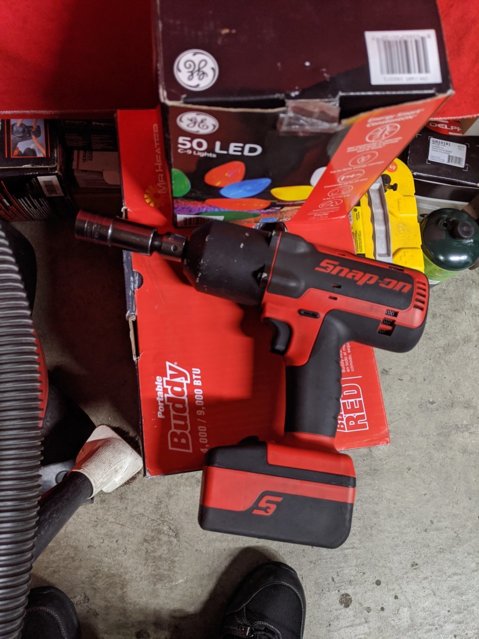

    not mine. iKamper owner. Was catching up with him this evening, planning some fishing. He was doing a brake service on a Lexus F Sport. Dealer had quoted the customer at like 1200 I believe for front rotors and pads. Damn crazy stealership.
    nice impact though. puts my dewalt to shame :bananadead:

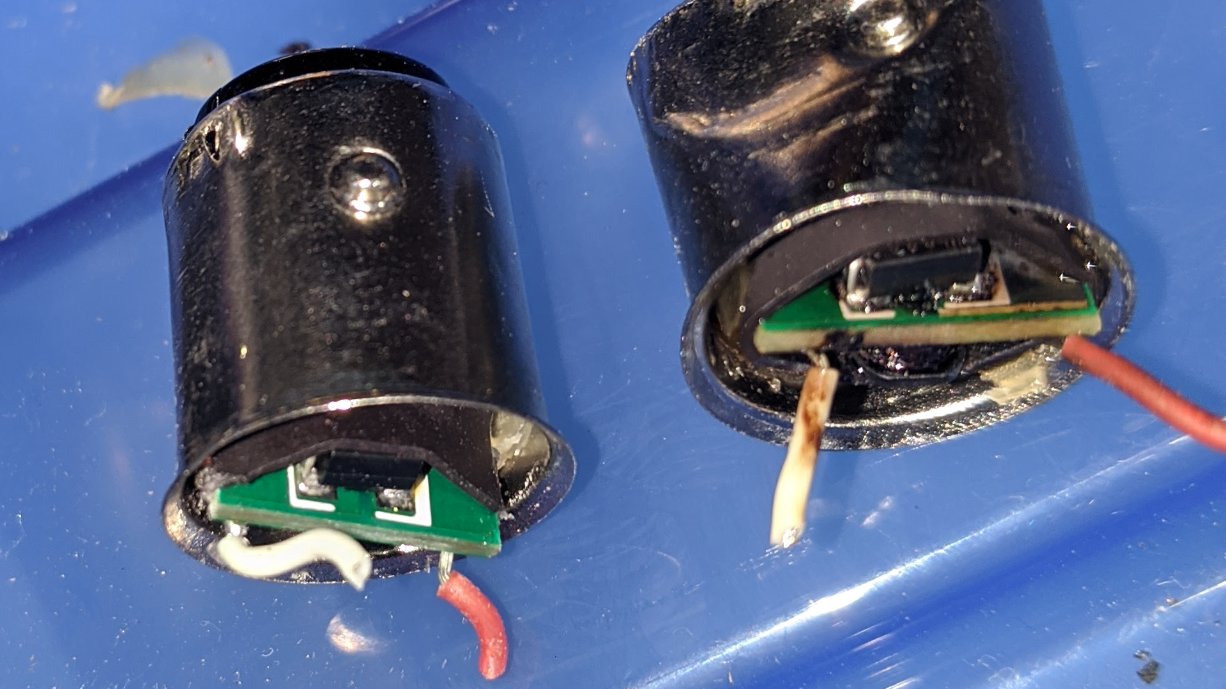

    So wtf would cause the damn taillight fuse to blow in the engine bay fuse box? stop lamp fuse in the cabin box is fine. Brake lights are dead as are markers. Dash lights intermittently flashing as well even though gauge lights fuse is ok. Very weird - multiple electrical issues out of nowhere.

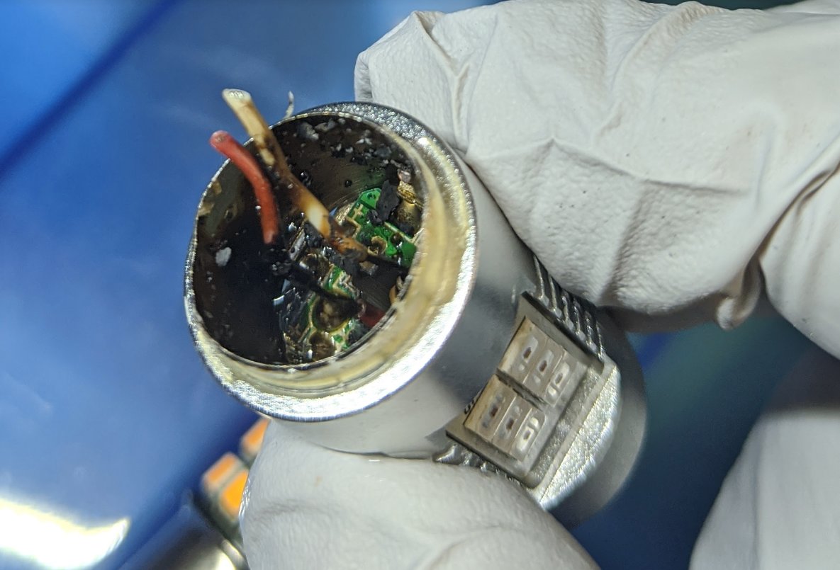

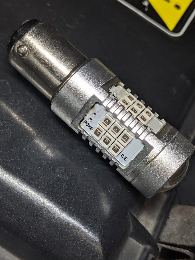

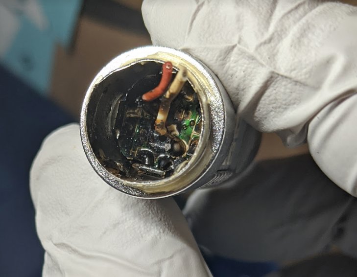

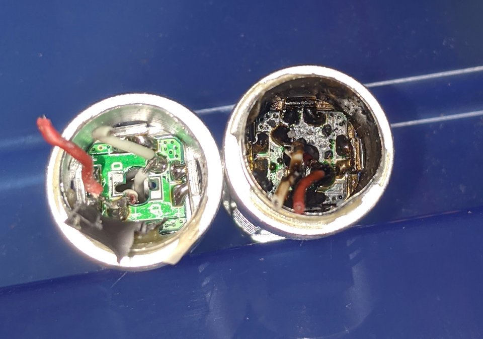

    I'll write something up in the Lighting section on cheap ass Amazon LEDs tomorrow since I'm way tired but some pics for your enjoyment. Yep, this is a stop/tail light LED (1157). Going back to stock bulbs.
    9eRXdQwbYm0uCxCOUVmILzdd1qtiC39469xBRsZN_d4de5f7399f770633e9062ad66a6c21bc0197704.jpg
    bulb on the left is the passenger side (no issues)
    CS_AR and cruiserguy like this.
  20. Dec 18, 2019 at 1:48 AM
    Area51Runner
    Area51Runner Well-Known Member
    Jun 26, 2014
    #132748
    11,978
    Northern California, Bay Area
    02 3.4 DC TRD PreRunner 4WD SWAP
    Yeah me too. Was a bit worried that perhaps all of the electrical I had done (including re-wiring the shell brake light), might be the cause.
    I had bought those LEDs back in 2016. Cheap overseas Amazon stuff but they worked fine. Now this. Not good at all. What was really odd and I do want to figure out why, that damn bulb remained energized. I pulled it from the tail light housing and it sat for some time. I then went back to it and looked at it closer. I could make out subtle discolorations which made me think of burn marks. Broke the LED housing to separate it and sure enough the damn thing started to smoke - not much but it was smoldering. freaky.
    Anyway, point to sharing all of this - anyone have cheap ass LEDs, be careful. Might want to check that garbage.
