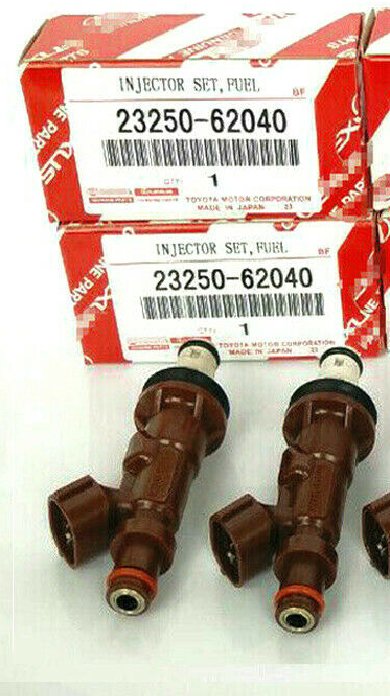

    The eBay injector counterfeiters are growing bolder every day.
    Toyota box.
    The "Injector Set, Fuel" font looks to be wrong.
    Pintle Cap looks to be too light.

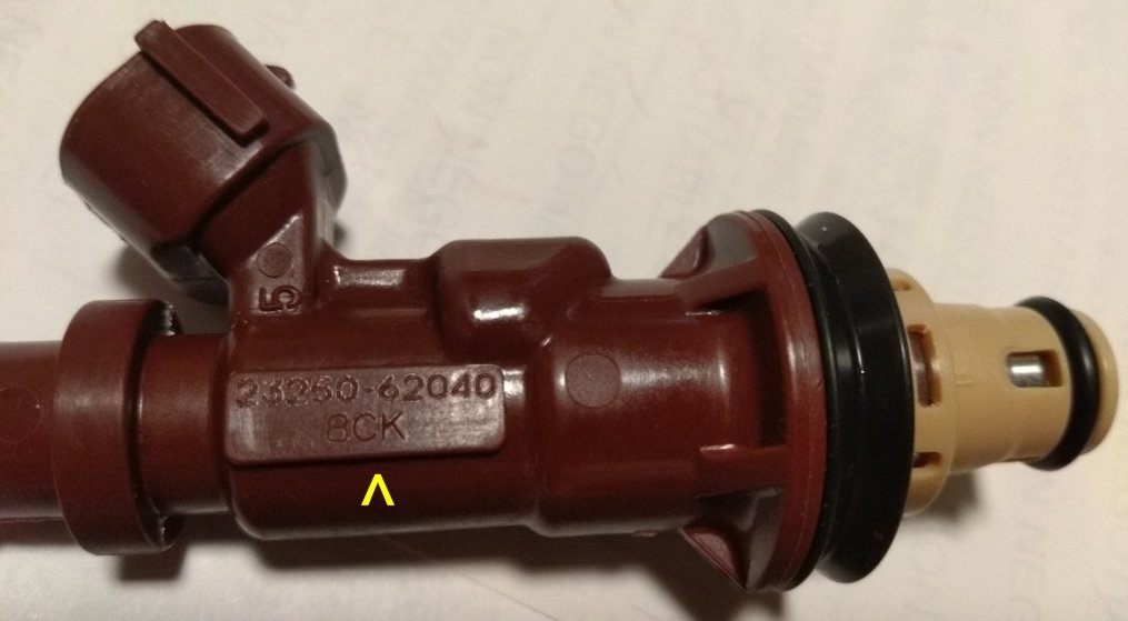

    Missing lot verification code under the part number.
    I feel sorry for the victims.
    We may see a rash of Tacoma fires when this garbage starts melting and leaking fuel.
    Made in China.
    Here's a correct example with the testing lot number code.

    Yup that's definitely a knock off. Why I never buy OEM branded stuff new on eBay usually. Older stuff that's clearly been laying around for a while can be safe though. Lots of parts like that now that our trucks are getting so old. Things are going NLA and they get sold off to the lowest bidder or a parts guy that sees that the part is no longer supported.
