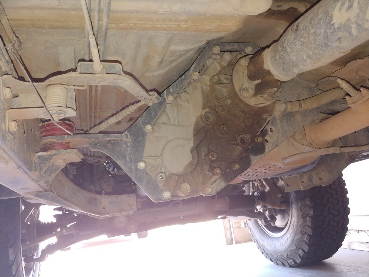

    It's less Tacoma and more mod
    Improvement

    Nice, you make that?

    Whats up with all the oil lol

    Rust prevention

    Front Range Off-road makes those so you can mount custom tcases and crawl boxes. I just wanted to push my trans and case up higher so this is perfect and easy to weld in.
    @Sperrunner the oil was from my output seal on the tcase, I fixed it a day after that pic.

    I need to do mine, it leaks worse then that

    @Speedytech7 Will it be best to replace while its off the truck lol

    It's a really easy job, takes like 30mins. But buy the OEM seal, it is worth it.

    Not really, it is best to do when the driveshafts aren't in the way though.

    Hopefully that's what's wrong with mine haha, whole case is wet with flyid
