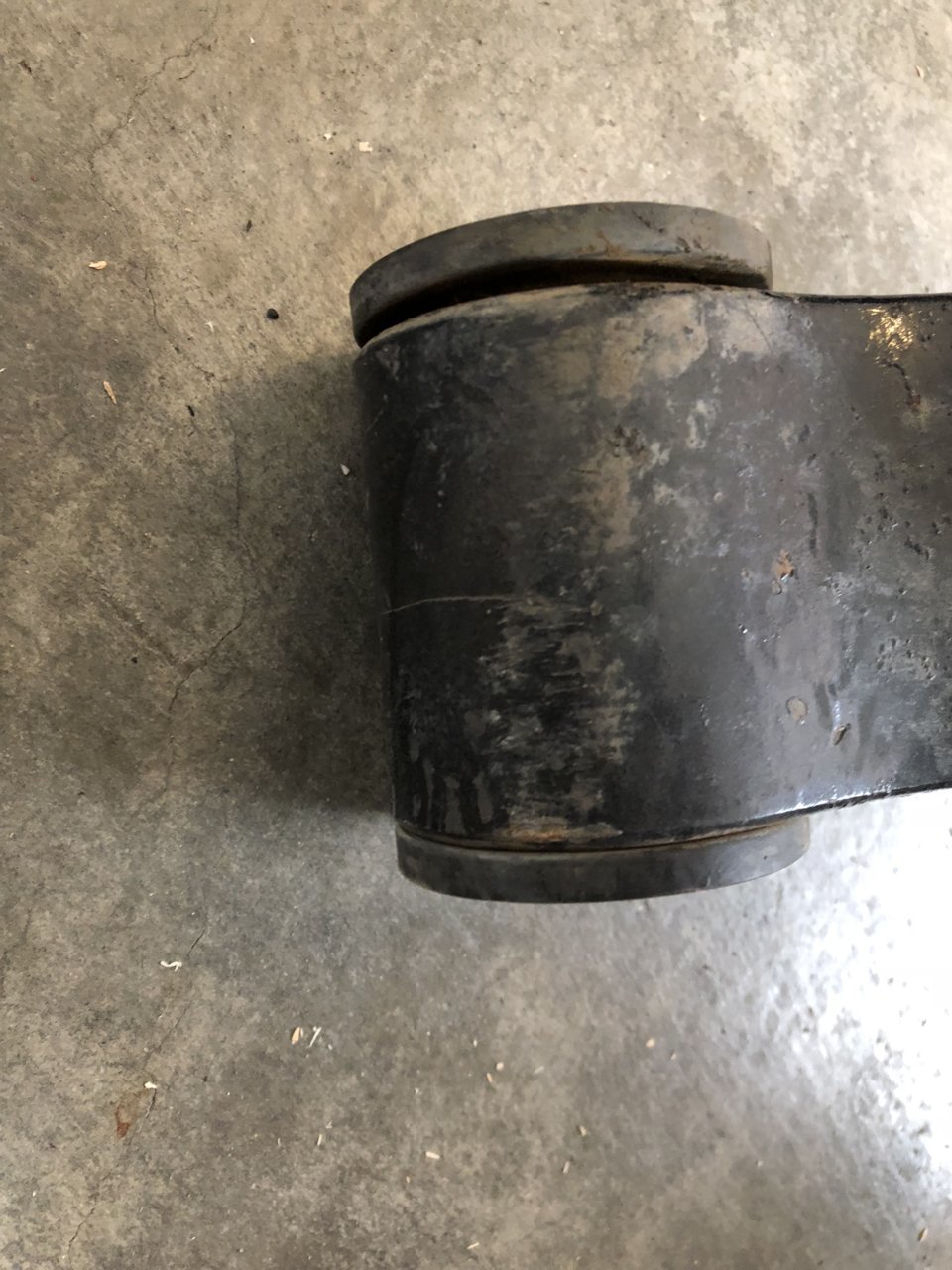

    Which part of the leaf spring faces the front of the truck?

    The main eye, take a pic of the top of the least, they usually have an arrow. Usually the bigger hole goes forward tho

    smaller bushings are for the shackles. Shackles have two diff size bushings. the front eye-lit bushings will be big and you cant mistake that package
    No
    no put the fromt eyelit bushings in first on the leafs. Attach that to the frame then attach the shackle to the truck and the leaf pretty much at the same time. When you get there you will understand. DO NOT attach the leaf to your axle prior to any of this

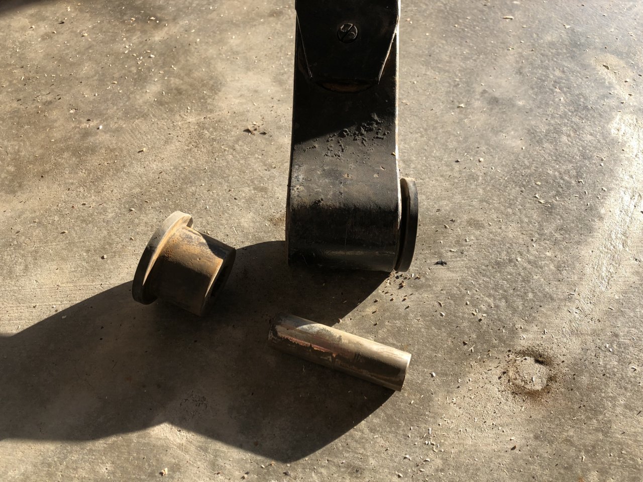

    And how the hell do I get the old bushings out?

    Press the metal sleeve out then pull the rubber

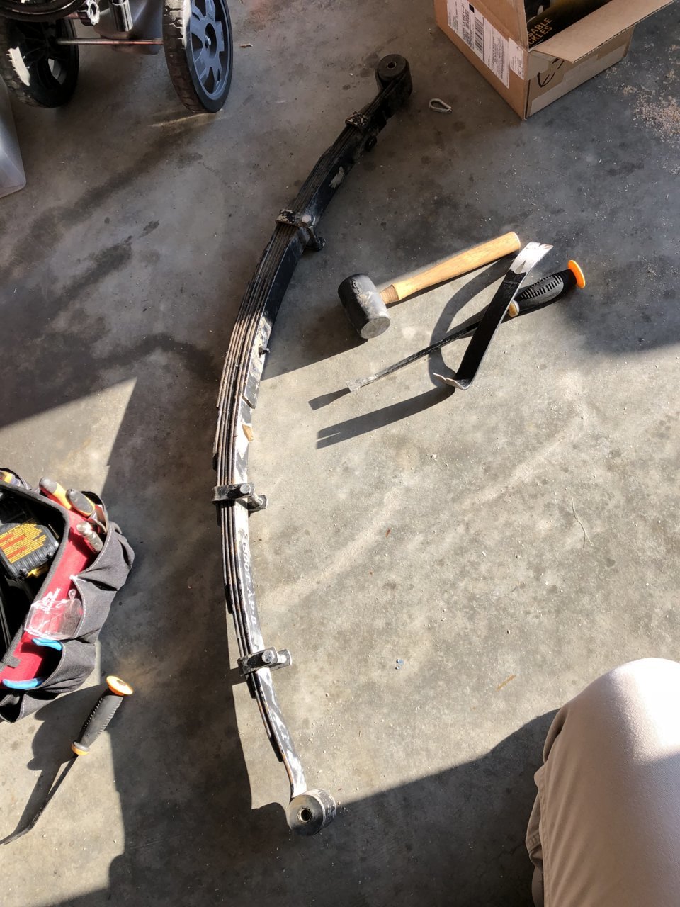

    I’m running out of daylight to put the lift on today. I’m just prepping the leaf springs in the meantime.
    Look, I did something!
    And where is the front of the leaf spring? I can’t tell.

    They came out pretty easy once I started hammering the shit out of them. Haha.
    Still can’t figure out which part of the spring is front.

    Isnt the full wrap go in the front
