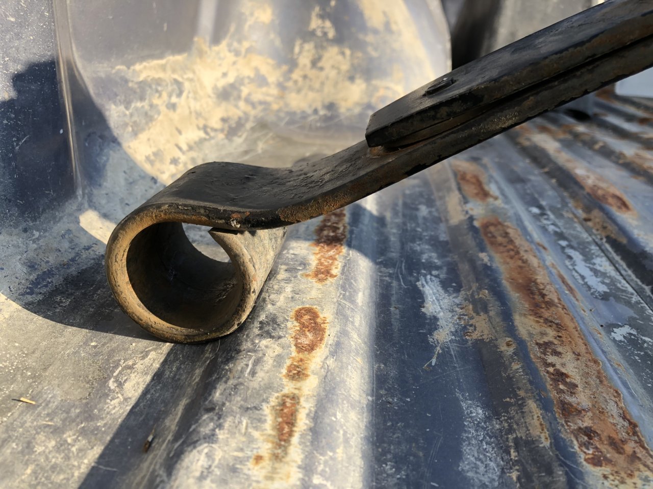

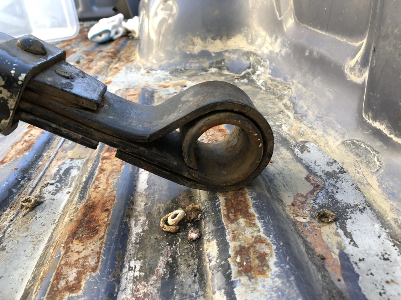

    Looking at this(2nd pic), the side thats near the box is the front unless im remembering wrong

    @BartMaster1234 the side with the leaf wrapping around the other leaf is the front

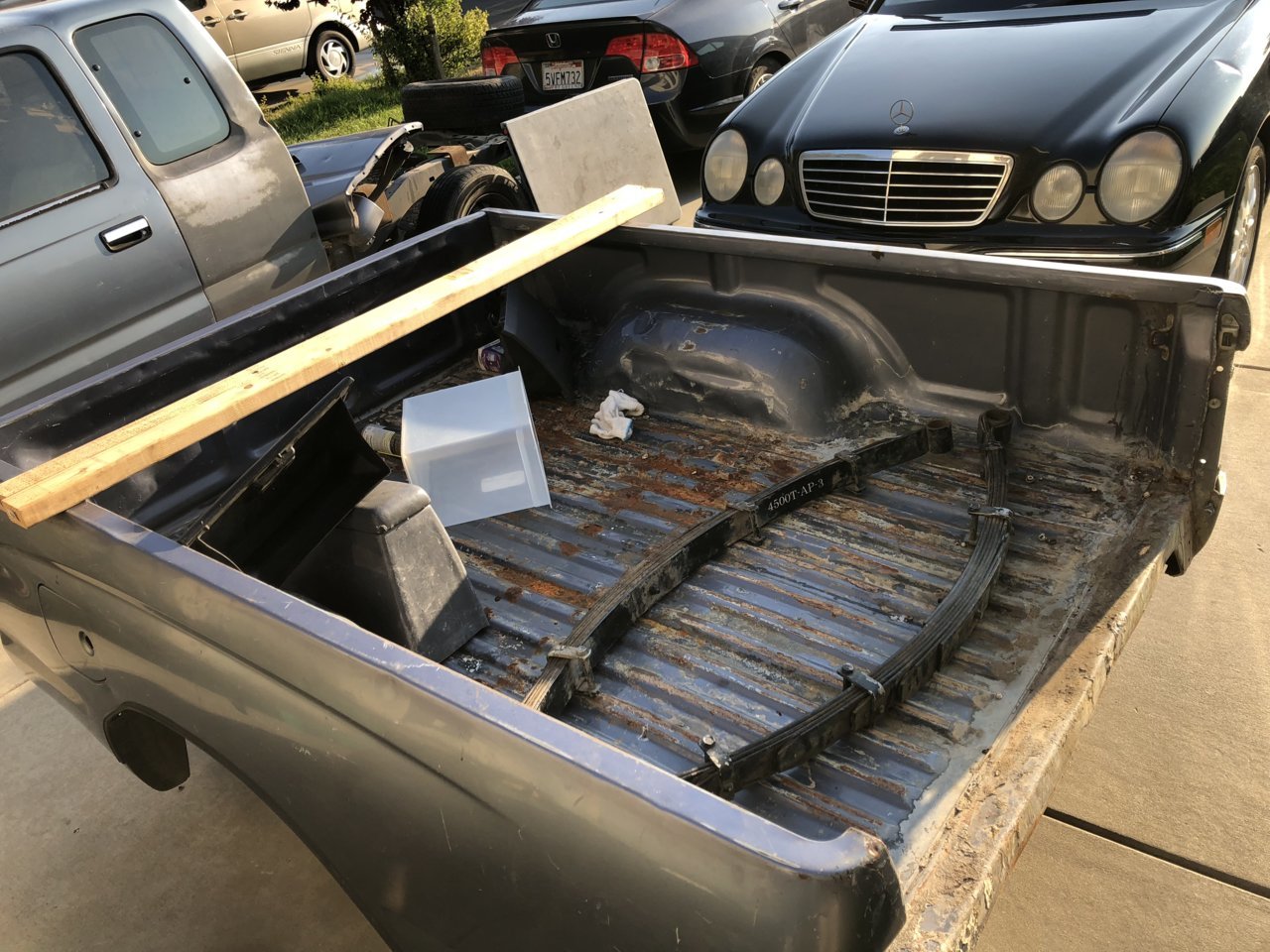

    So this is the front towards the engine:
    And this is the rear towards the bumper:
    E30325 and Sperrunner like this.

    Yes

    Yes
