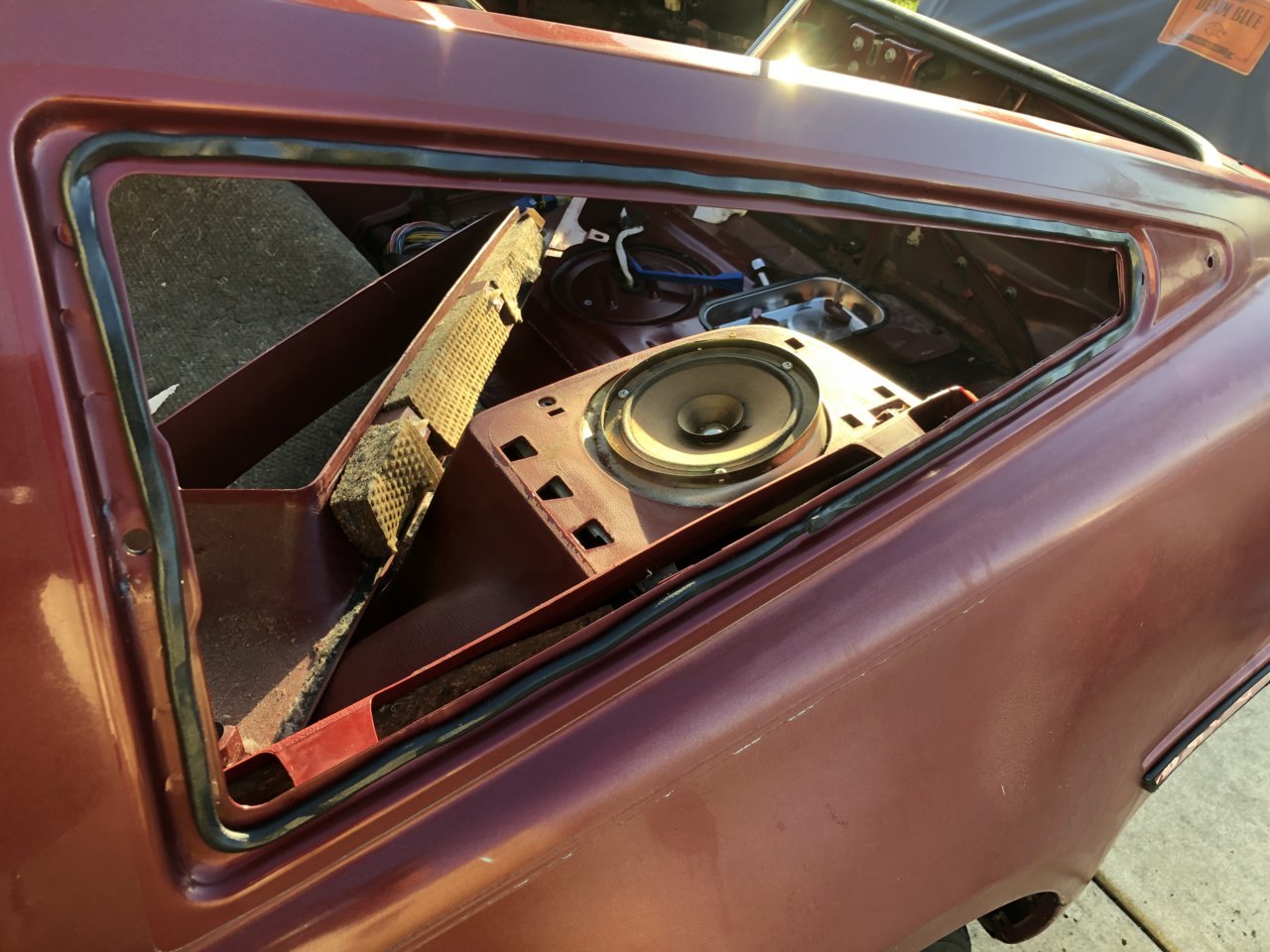

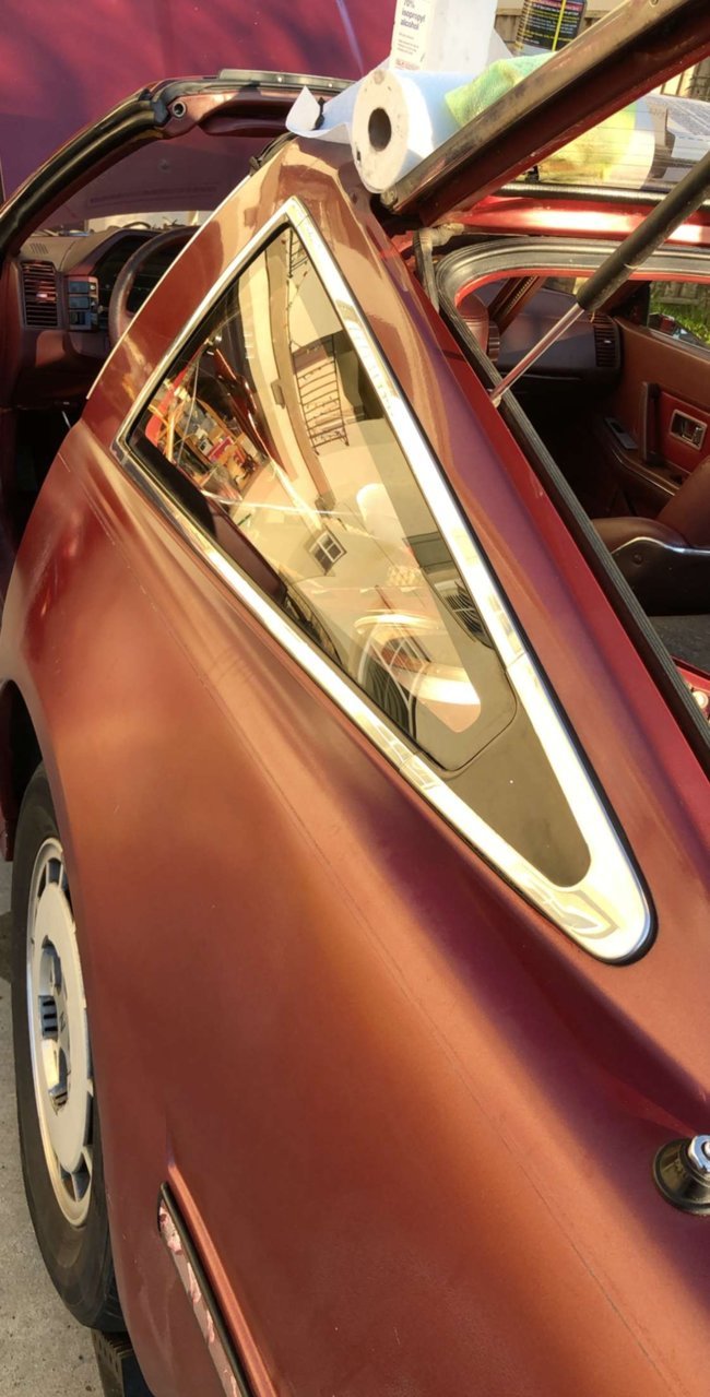

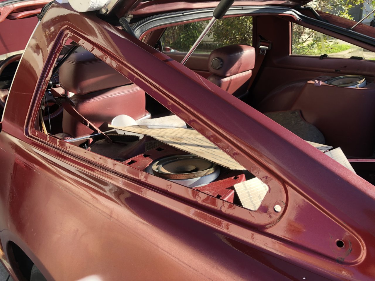

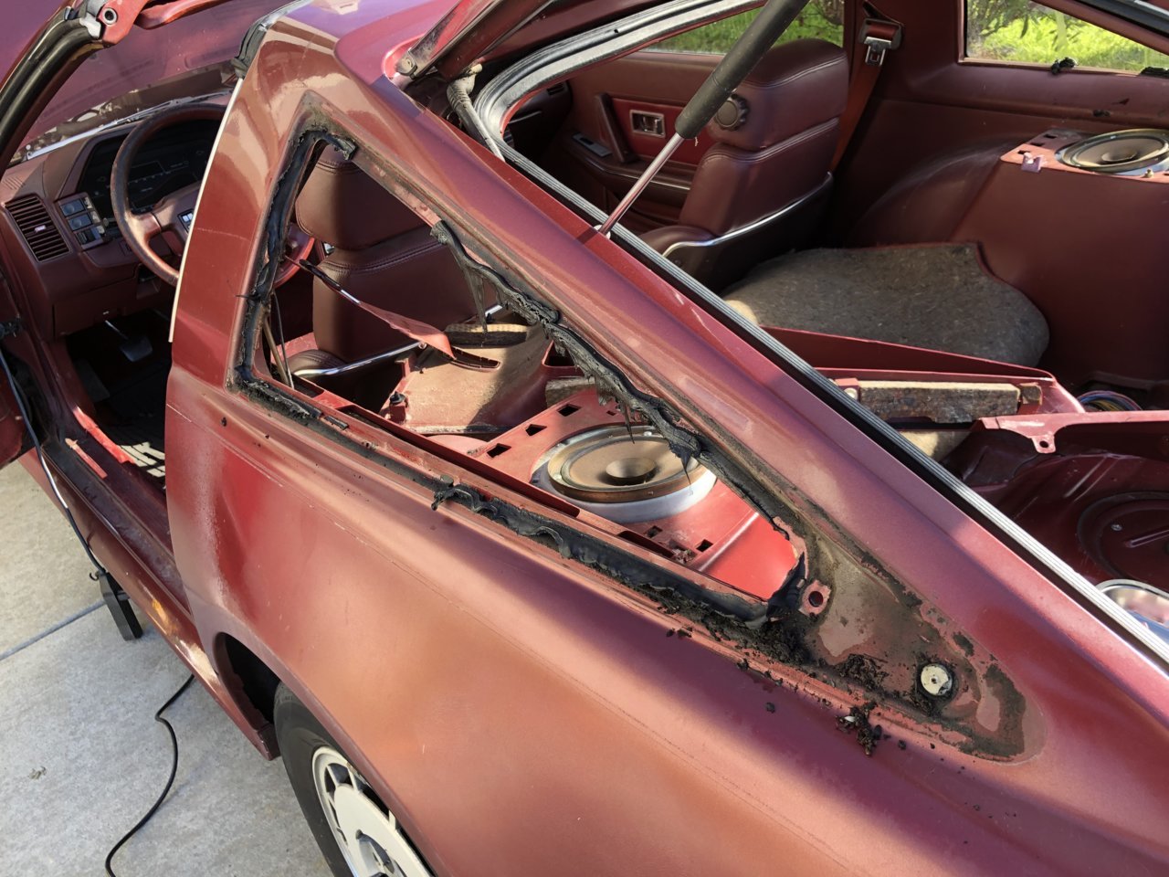

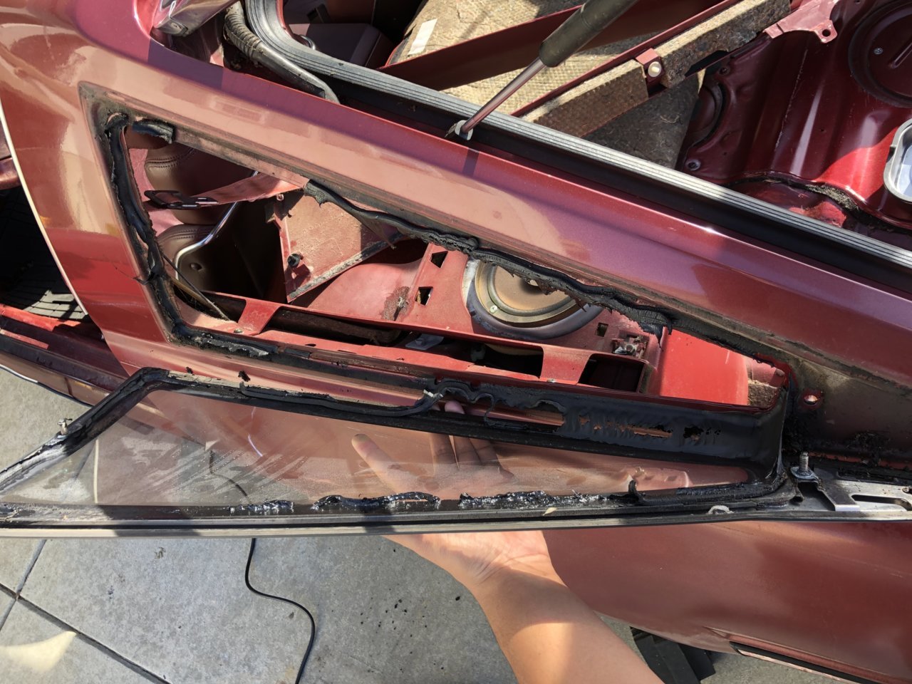

    WD40 straight up liquefies Butyl. What can’t it do?
    I resealed the rear quarter window with 3M windo-weld Butyl rope. Was leaking pretty badly.
