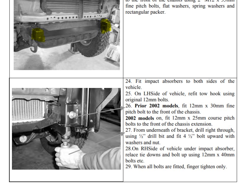

    wasn't talking about the 'wings' and sorry if I wasn't paying attention when you both started talking about cutting. I was talking about -
    The above is the re-designed process I guess. Before, they had you cut it (as in Tim's video)

    4 run, 2 don't
    Ah, good thing you posted that.
    I don't have a drill strong enough to drill through the frame nor a step drill bit.
    I've got a CA-strong frame :muscleflexing:

    @Kwikvette I imagine your bumper is going to come with hardcopy instructions. This is the most recent I have come across. It is the same process that was used when mine was installed.

    Saved :thumbsup:
