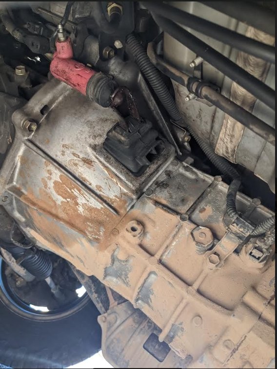

    but mine is green(ish) or maybe its weathered IDK, found a recent pic from when i was undercoating it all,
    + i have a cap like what you would find on the tire valve stem from where i guess you would bleed it at?
    Das it mang[QUOTED] likes this.

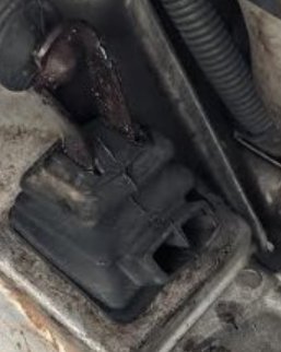

    Is this supposed to spin freely?

    wheel bearing?

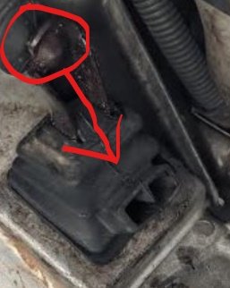

    no that's normal. U can have a red or green one. Maybe bc u have v6 or bc u have 4x4 it is the green one. Don't bleed anything. Use a thick goopy grease no spraying. I got generic high temp grease and put it on with my fingers. slather it on the metal part that connects the master cylinder slave to the metal piece. (seen on left side of image, the metal piece connected on the right leads past the boot into the tranny for a second pivot angle) U pull on the boot and it pops easily off, follow that metal piece back to the next pivot angle and slather it on that one too. that's all I did and it fixed it. Just drove it on lunch break to get gas and its still gtg, silent af

    I can't quite tell from the pic and without a diagram in hand, is the part your talking about the outer bearing race/piece? If so, that is not supposed to rotate in the hub/knuckle.
    If you put an arrow on a diagram it'd be easier to see which part you're talking
