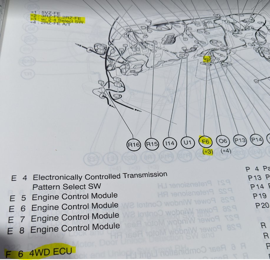

    This is what I was getting at with this diagram from the wiring diagrams (page 35). F6 is designated as the 4WD ECU. It should be located directly above from the Center Airbag Sensor Assembly (C20,C21,C22 - page 34). It specifically states it would be present for vehicles with the 2-4 Select SW. Don't have it of course and from what I can see that plug off the harness is not there. Unless its wrapped up along the main harness tucked in near the steering column. I'll take another look tomorrow.
    Now that I think about it, I wonder if the ADD Actuator plug is present on the harness at the transmission just to see if its wired for it - if it is, then you're right about them being wired for everything. Should be an easy check.

    chances are prerunners are setup with the jshift harness because less wires.
    So you probably don’t have the connector for the computer. Just the relay.

    You do need to have a 4x4 ecu though. Easy to check. Just pull the glove box, and the vent. A 4x4 ecu will say 4x4 on the sticker

    you're talking about the ECM right? See thats where I was confused initially when you mentioned it before. I was looking over the docs and it was talking about a "4WD ECU" that being in the center of the console. Then there is the big module behind the glove box - in the diagram that is listed as "Engine Control Module" and there are I believe 5 connectors.

    The engine control module.

    When removing that thing, do I need to disconnect the battery? Last thing I want to do is accidentally activate the damn passenger airbag squib or fry the ECM. Just a thought.

    No you shouldn’t have to remove it. I think you can read to top of it once you pull the hvac duct out of the way.
