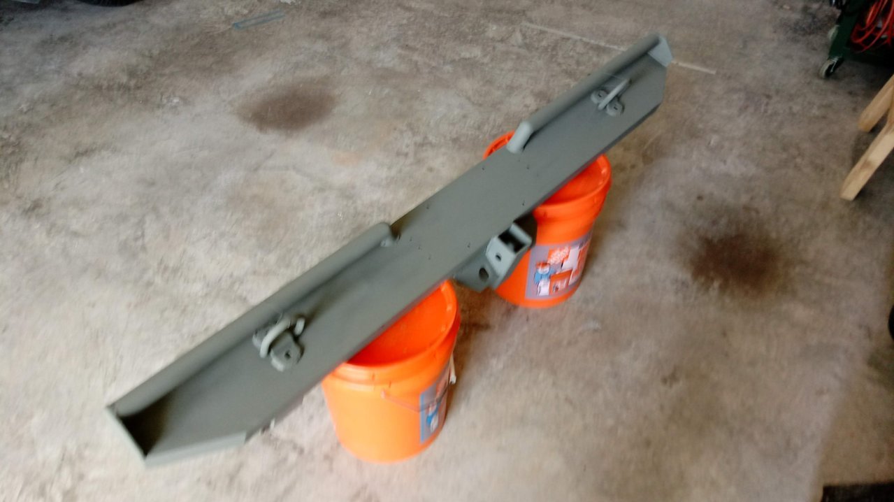

    2x4 channel rear bar, going to cut and box the ends internally so that instead of mounting on the top the swingouts are frenched in. Chamfered rear corners meeting another section of 2x4 tube to go straight from the back to the wheel well. Chopping the bedside in the process. Plate curved underneath for some style to maintain at least a moderate curve underneath, that way it isn't just a blocky shape.

    Ah so a lot more complex then mine. I used a piece of 2x6 channel iron for the bulk of it. Just capped the ends and threw a receiver tube underneath. Think it was like $120 all said and done.

    Yeah there's going to be a bit to this one. Not sure if I want to chop the bedsides yet, but I'm kinda planning on it.
