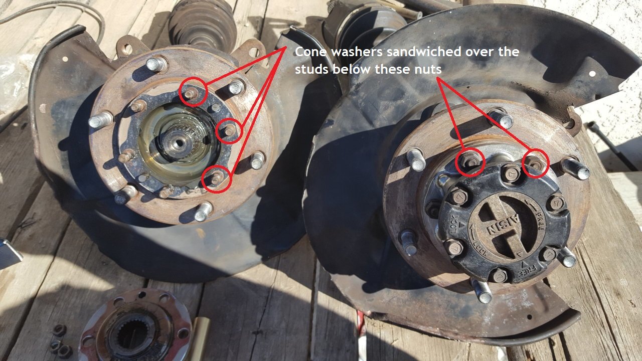

    @Colton317
    The hardest part is the removal of the hub assembly from the hub. I've circled the area to focus on, and you can easily take care of this with a hammer and a brass drift.
    Undo the nut until it's flush with the stud, place brass drift on stud/nut surface, and hammer away. The cone washer will get knocked loose after a few tries -

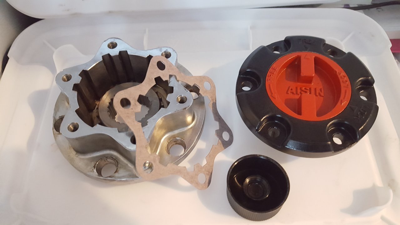

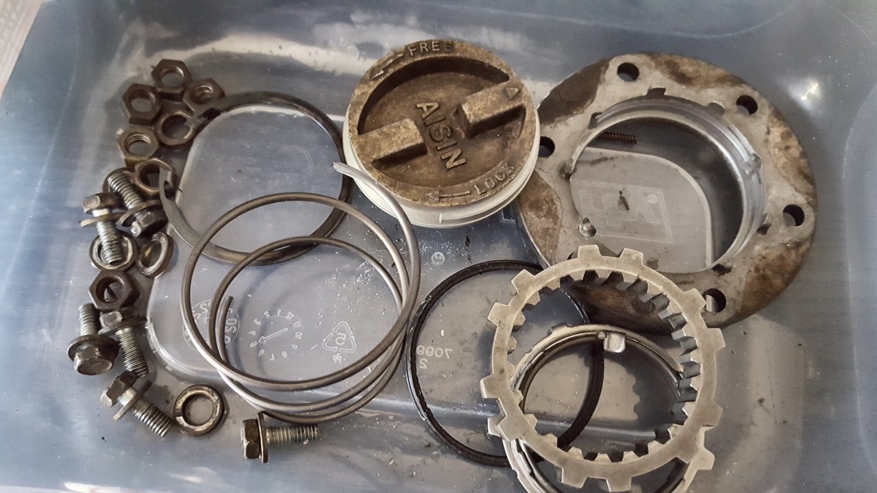

    I think there was a snap ring in there somewhere; just make sure you have snap ring pliers. You'll need them when you disassemble and reassemble your manual hubs.
    If your hubs have never been rebuilt, expect a bit of a nasty mess -
    This was after running the parts through some brake cleaner and wiping off the excess sludge build up. The o-ring in that picture needs replacing; it keeps water/moisture.
    Cleaning this is pretty self-explanatory.

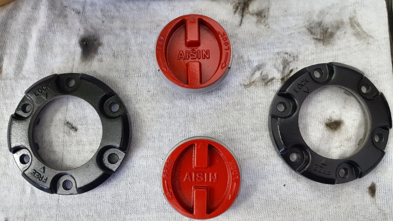

    If you want to add some "wow" factor, you can do like I did and get the hub cover and dial media blasted. Repaint with your favorite enamel paint; ensure to only paint the outer surface.

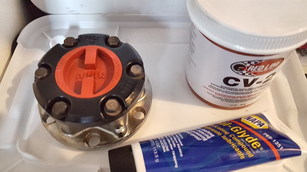

    Reassembly is the opposite; ensure you only lightly lube where the o-ring sits. Use your favorite grease, lightly, on the mating surfaces.
