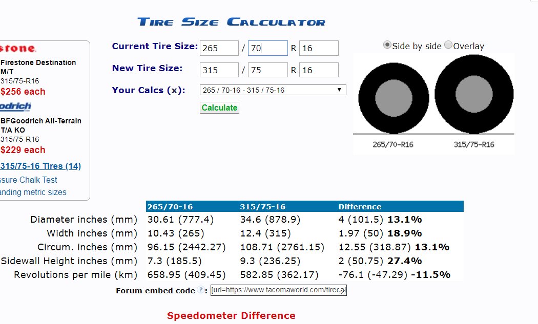

    Is it possible to fit 315/75r16 tires with a 3in lift? What is the stock measurement from the ground to fender or hub to fender? Thanks

    3" lift, sure, if you are willing to cut and move the firewall

    It's less Tacoma and more mod
    Yes and no, you'll be running a very offset wheel and cutting your body back to make room. Biggest without cutting is a 285 75 16
