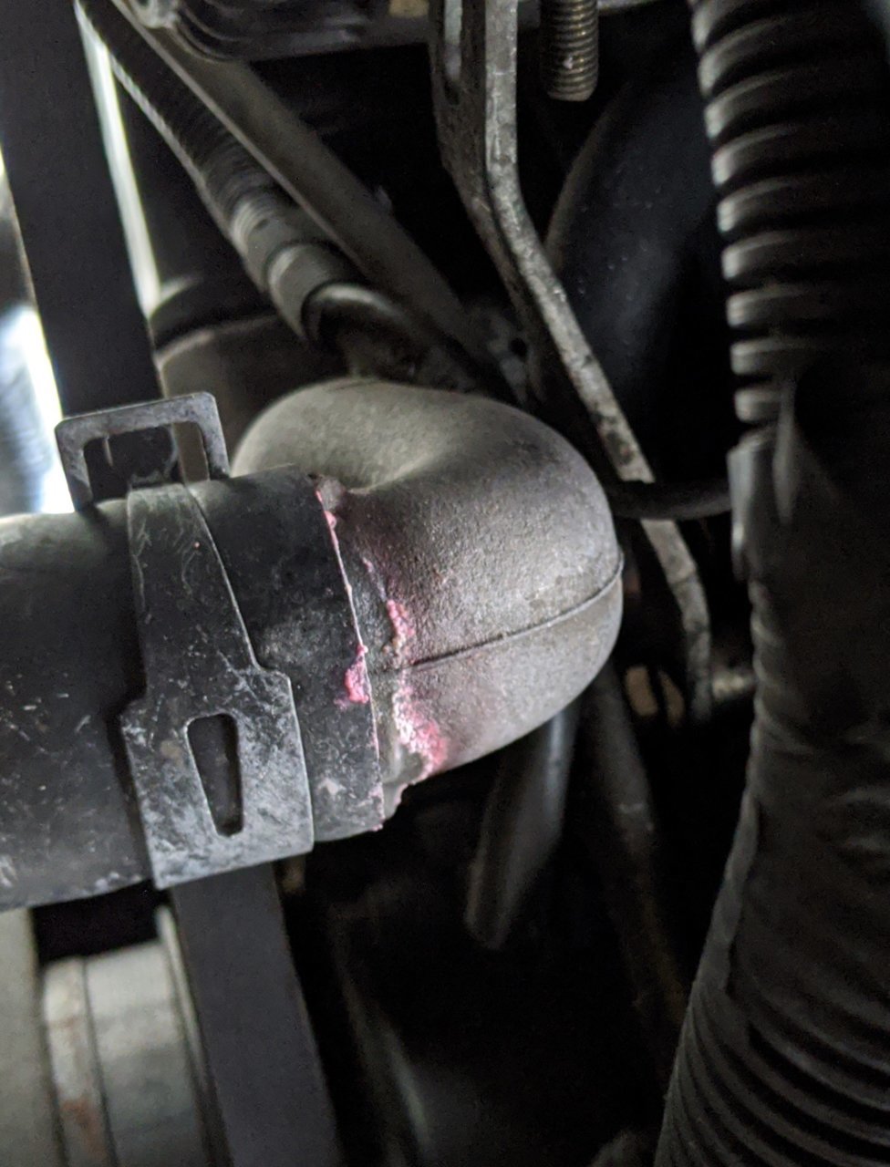

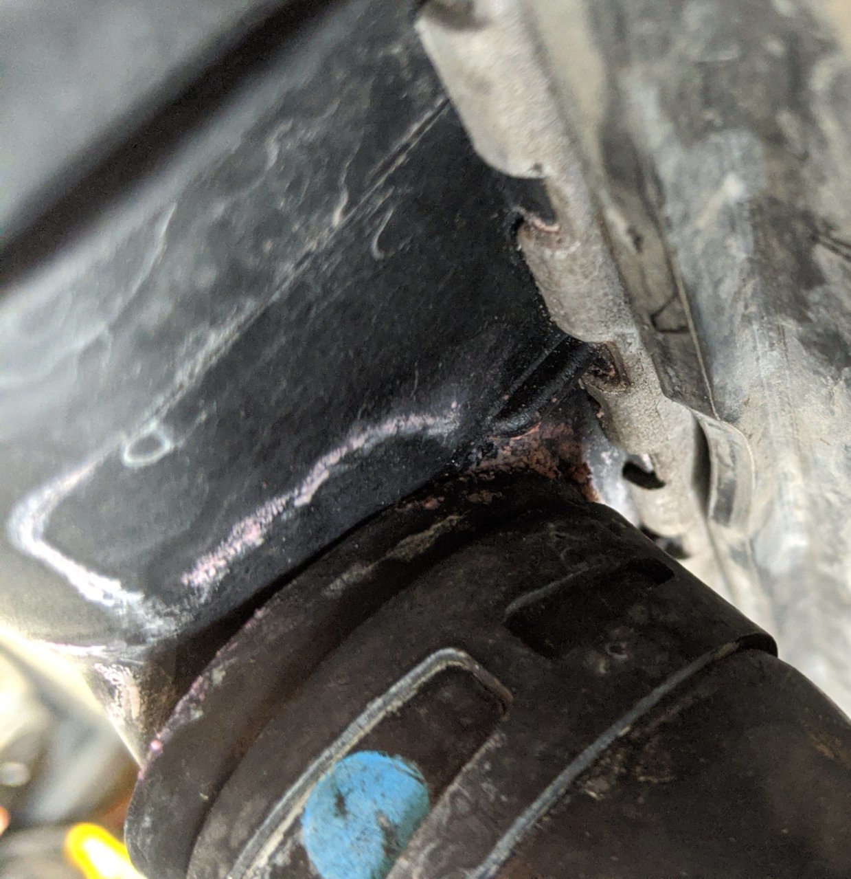

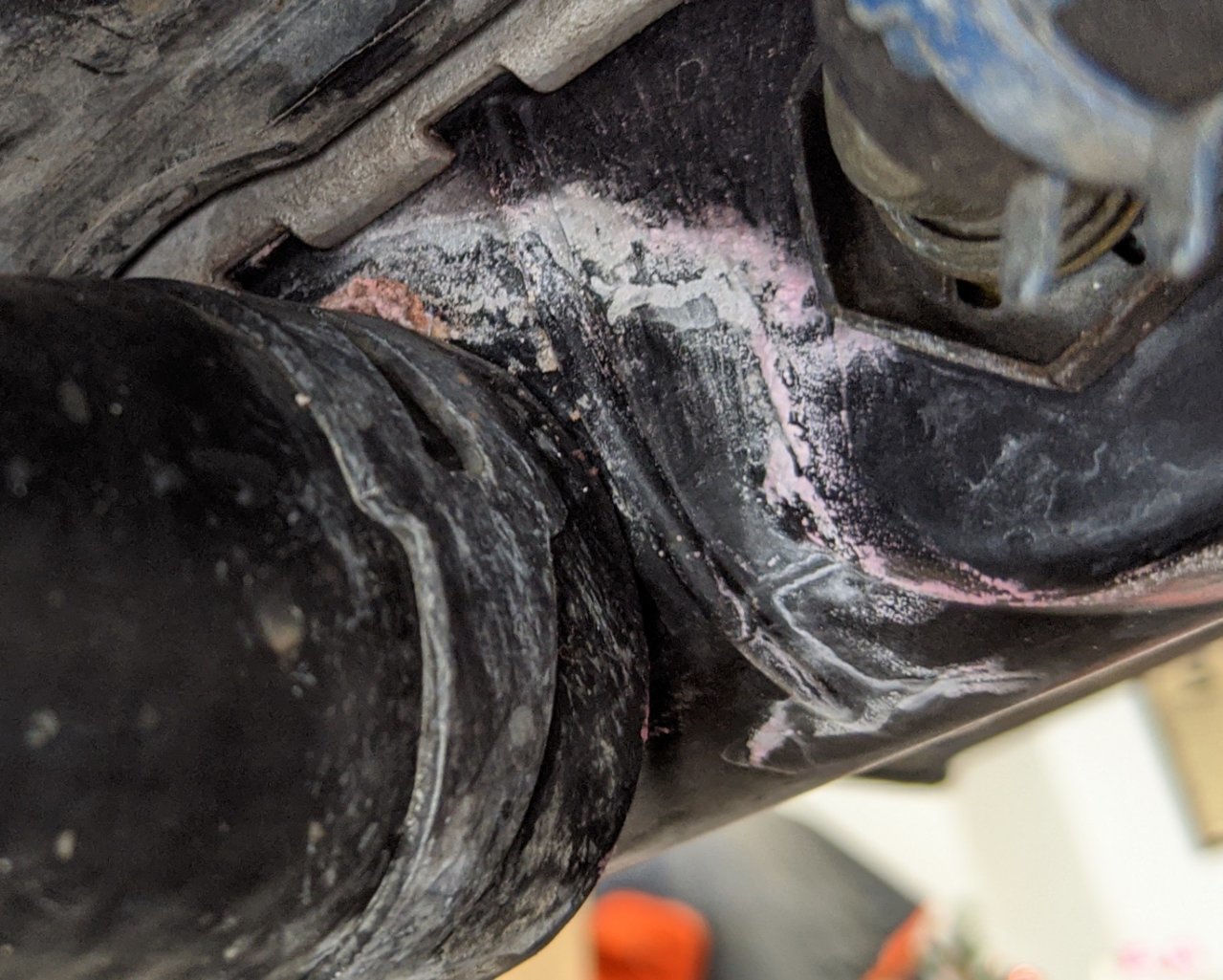

    That and $5 rad cap after 3 OE cap failures. Was given 3rd gen rad caps.:thumbsup::rofl:

    We’re the clamps replaced with the hoses?

    The part #s matched the one he was running when leaks at hose ends started. You were there you should know:confused::mad: The $5 rad cap was 1st gen aftermarket and overflow was mud dauberred shut:rofl:

    Probably a good chance they’re sprung.
    get new ones. They wear out over time. But do not use worm
    Drives for the love of god

    Good to hear from someone that sees more of those clamps than I do. I've never had one lose enough tension that it wouldn't seal off. I've been curious to know if they do. And that answers it. :D

    Already ordered and received. Been sitting in my parts box for a bit now. They definitely have more tension than the originals.
