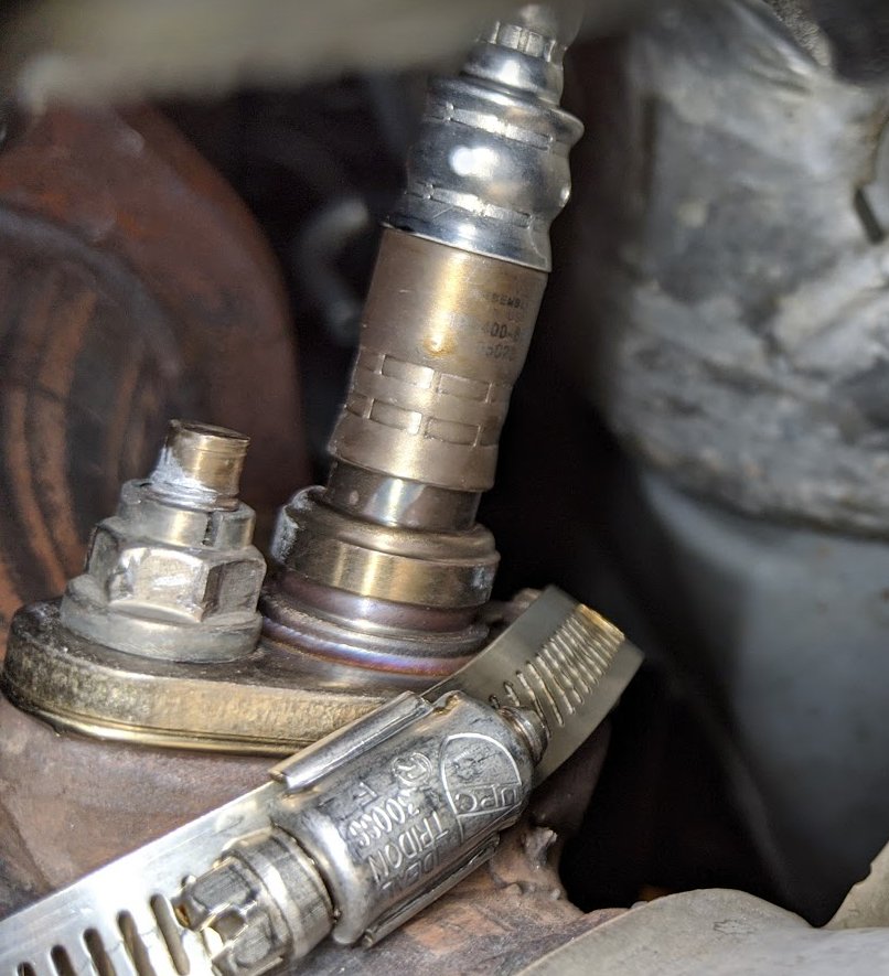

    Definitely need vise grips and get the exhaust nice and HOT and soak it good with penetrating fluid before getting it hot and after. I'd think that's the best shot at getting a little stub like that out

    Enough left showing to tac a bolt onto it?

    that's a good idea actually. I was planning on pulling the clamp tomorrow and seeing if I could get a bolt on there. I didn't try when it broke, just clamped it and left. Happened when I was heading out to Don's to drop off the original sensor.

    Will probably just take it in. Last thing I want is to make it worse. @Empty_Lord do you know if that piece (with the sensor bung) unbolts before the cat or is it part of the cat? Couldn't tell because of the heat shield.
    I don't want to buy ANOTHER cat. lol

    It’s just a stud. Usually I can get those out with vise grips then replace with a bolt
    just pull the sensor out
    Area51Runner[QUOTED] likes this.

    Happened to me with the ball joints. Cut a slit in the stud and use a screwdriver to get it out.
    Mine was really stuck so I used an impact bit on my gun.

    Yeah, sensor is fine - what I was wondering if that bung is on the same piece as the converter.
    good idea. might try it.

    Use a dremel. It’s most likely stuck, go pick up an impact screwdriver.
