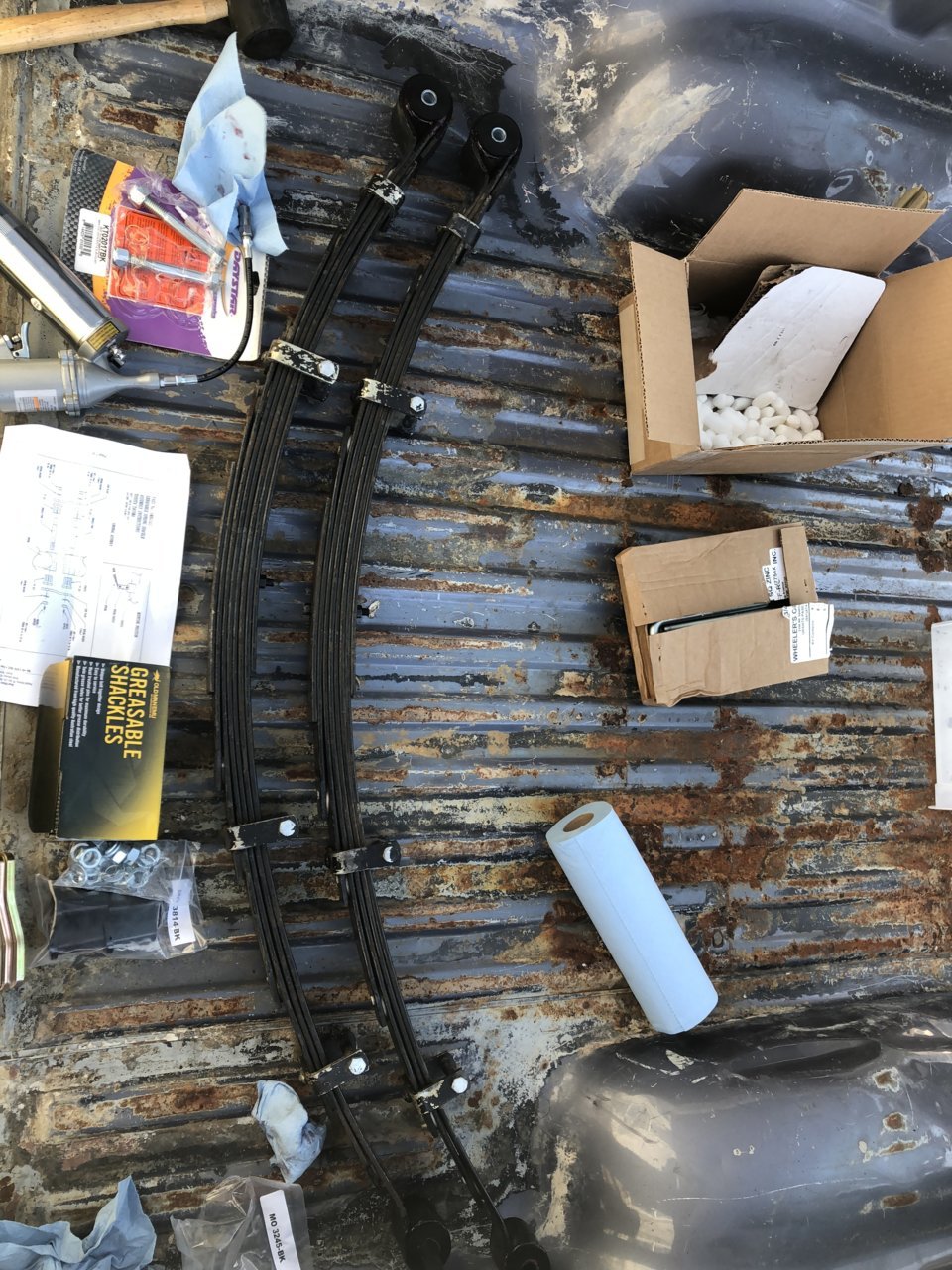

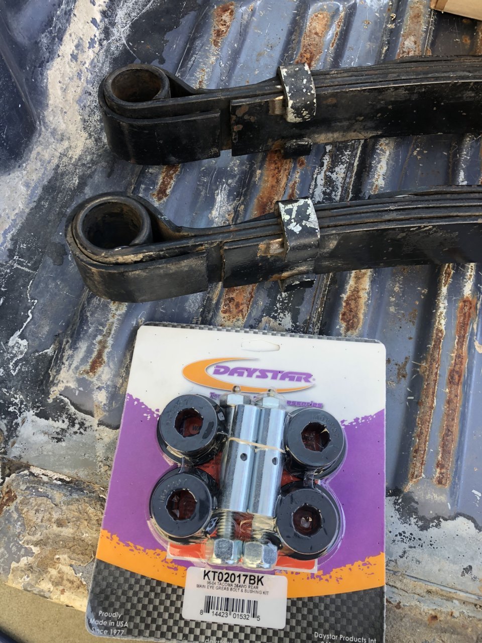

    Just want to make sure. The Main Eye goes on this side:
    And the shackles go on the side:

    Just want to make sure haha

    the bushings dont matter on side there universal. the shackles do matter. give this boy a "how to lift your tacoma for dummies" please

    Yes, and I used those same bushings on both ends so it doesn't matter which end they go in. But that is the main eye.

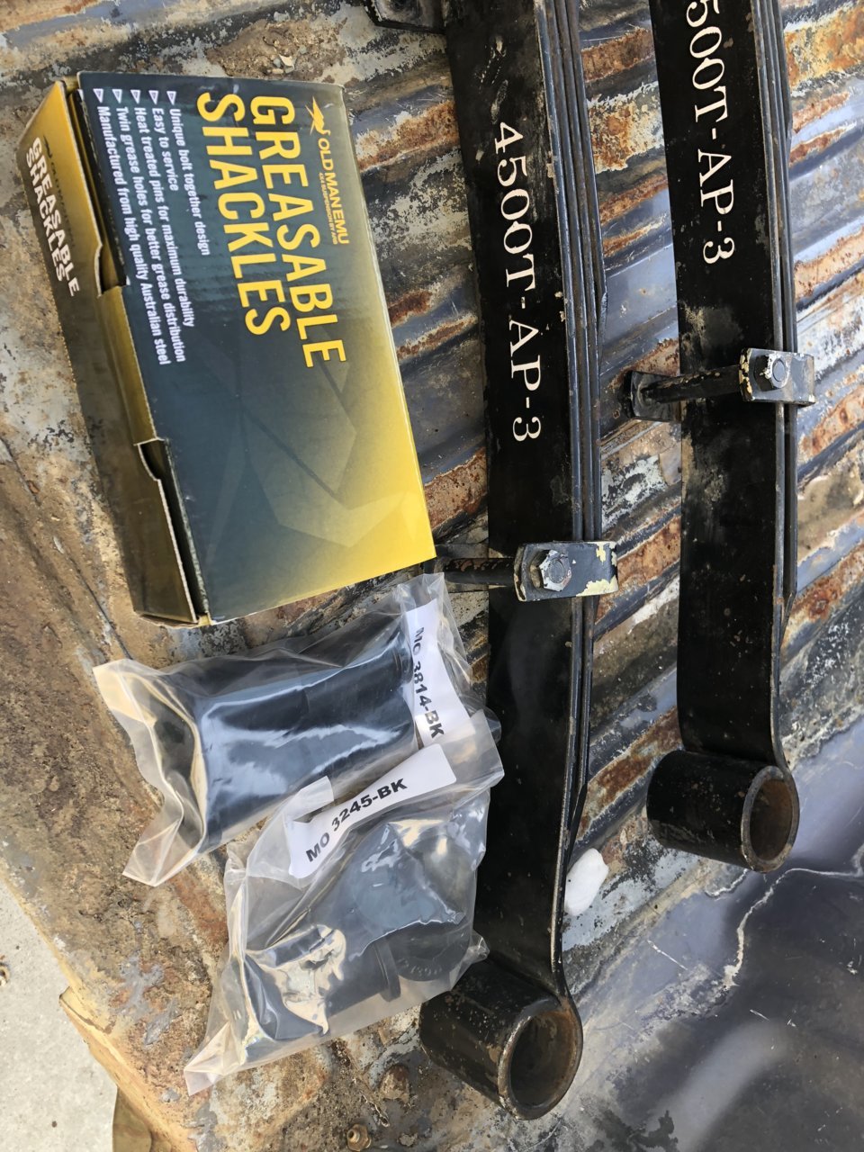

    Now which pin goes into the shackle eye?
    The short one or long one

    Shackles are wider apart at the frame side. So I'd assume short pin goes in the leaf spring.

    Leaf springs aren’t side specific right?

    STock ones are and i think dakars
    The side with more arch is the driver side. If thay are the same then no
    Or unless they have markings

    Top of the shackle is wider than the bottom so the top is the longer one.

    Really?
    They look exactly the same to me.
