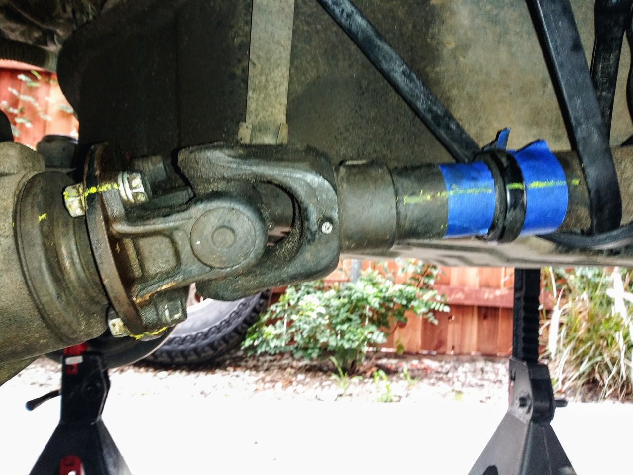

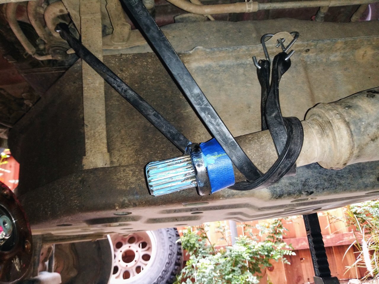

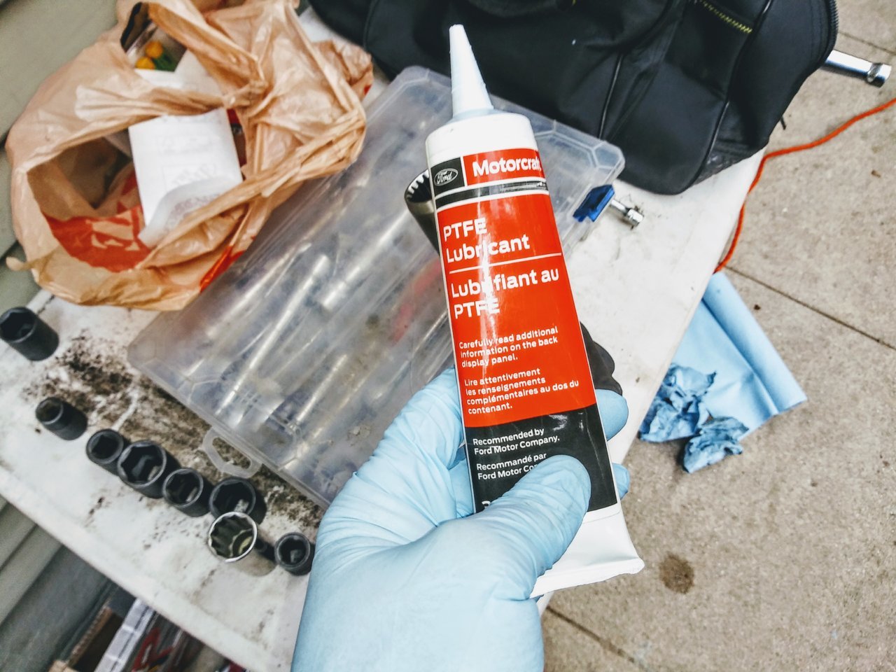

    Been meaning to do this forever...finally got rid of the obnoxious driveshaft ping when letting off the throttle and coincidentally got rid of the harsh clunk when shifting between 1st and 2nd gear at higher rpm.
    Greased the slip yoke by hand using the blue Ford XG8 driveshaft grease, stuff is definitely worth the money

    Stuff is like $15 for 3oz but I only used half of it, so I'll get another use from it when the time comes again, not too bad for fifteen bucks

    Yeah sticker shock is real but the quality makes up for it
    Glad that it's working out well
