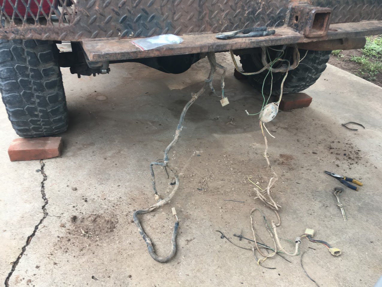

    Throwback to week 1 of owning the flatbed. Previous owners were idiots.

  3. Jan 22, 2020 at 8:11 PM
    Empty_Lord
    Empty_Lord Toyotaholic
    Mar 13, 2016
    #181186
    28,297
    Dan
    Northwest Indiana/Chicagoland
    you need the one from a access or regular cab. doube cab systems are Body ecu controlled. Not integration relay like the tacos and access/reg cab tundras

    i have to deal with electrical gremlins from remote starts and alarms all the time... they drive me nuts. the only remote start ot keyless i will run other than factory is one thats plug and play.. which isnt a thing for 1st gens. (i could make it plug and play. but why?)

    One of the things I specifically check in a used vehicle purchase is what has been messed with in the wiring. If aftermarket stereo harness was spliced into factory harmess instead of adapter into factory harness, I walk. Bad experiences with wiring thats been jacked with by incompetent MFers
    Anyways back to your jacked alarm. That sucks bad. Wouldn't blame ya for replacing the harness
