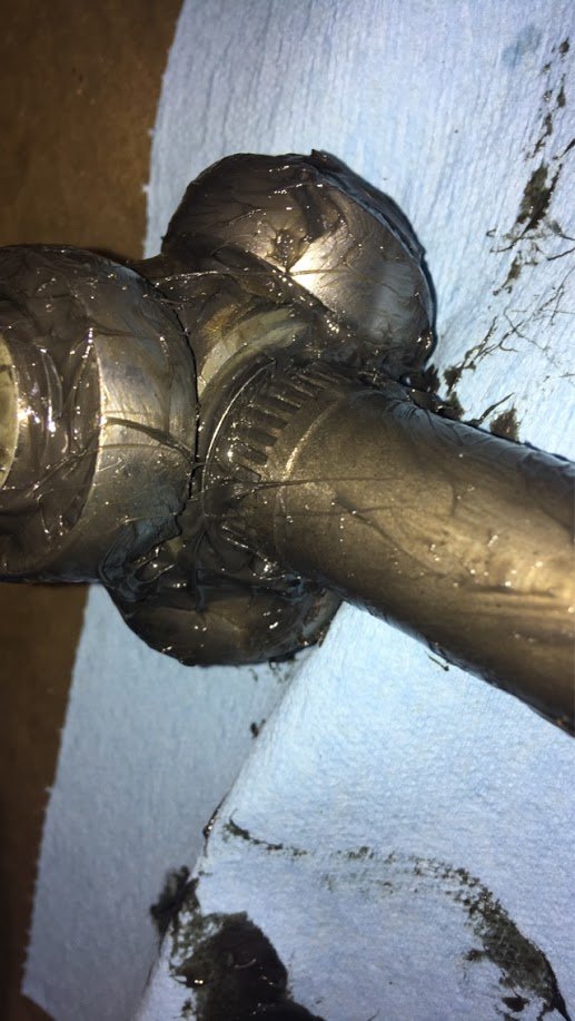

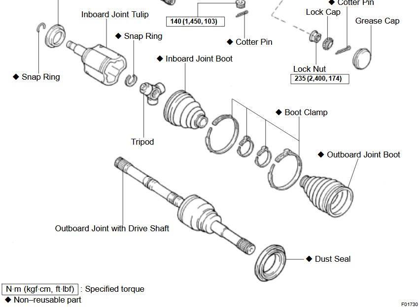

    So it appears that CVJ assembled this CV incorrectly. The snap ring is below the tri joint while it's supposed to be above. Going to go tear the other one open to see if it's the same. And then check one of my broken OEM CVs. This CV was off the passenger side of my truck that had the brass hub shavings.

    I just tore open another broken manual hub OEM CV (one that was seized inside a blown up diff). And found the snap ring in the same spot contrary to the Toyota diagram. I no longer have any ADD CVs sitting around to compare to. I've always been told the only difference is the outer ends. This is just confusing. Doesn't change my opinion towards CVJ though. Some shady business practices with them. People have received CVs with aftermarket parts and couldn't get a refund.

    Now that's got me wondering if these are even the correct axles, since they don't match the diagram? Or maybe they aren't oem axles that they are rebuilding and selling. Can you tell if it's a Toyota or aftermarket axle?

    The one I just took apart is 100% OEM. It's got the OEM part number sticker still. The previous owner of my flatbed told me he couldn't replace the driver side CV because it wouldn't come out. This is because he ran the diff dry of fluid. It's inner shaft is one with the blown up front diff.
    Now back to the CVJ axles that my silver double cab was running. I've disassembled one of the CVs and it's c clip matches the OEM axle I took apart from the flatbed. But according to all the Toyota diagrams and Timmy's CV axle reboot video the c clip is put on wrong. The CVJ axles appear to be using all OEM parts. Might be an ADD vs manual hub thing?

    Ahhhhh thats a good point. If I memba right the CV axles aren't identical between the ADD and non ADD
