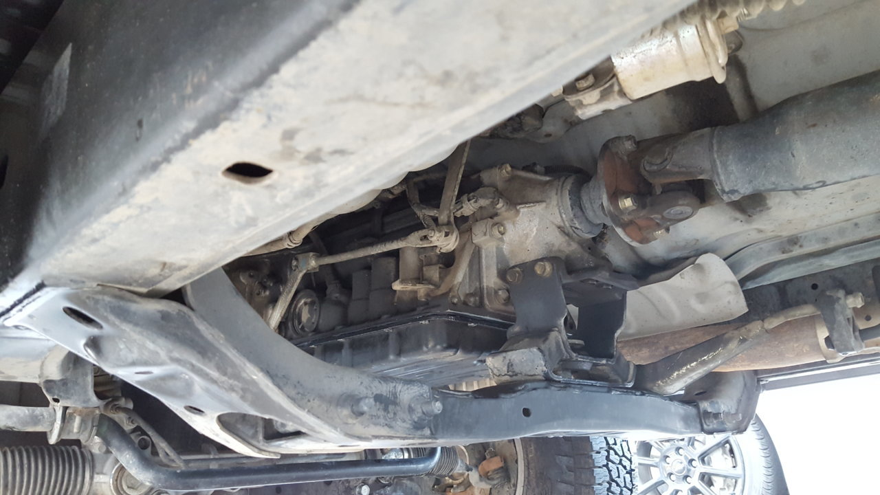

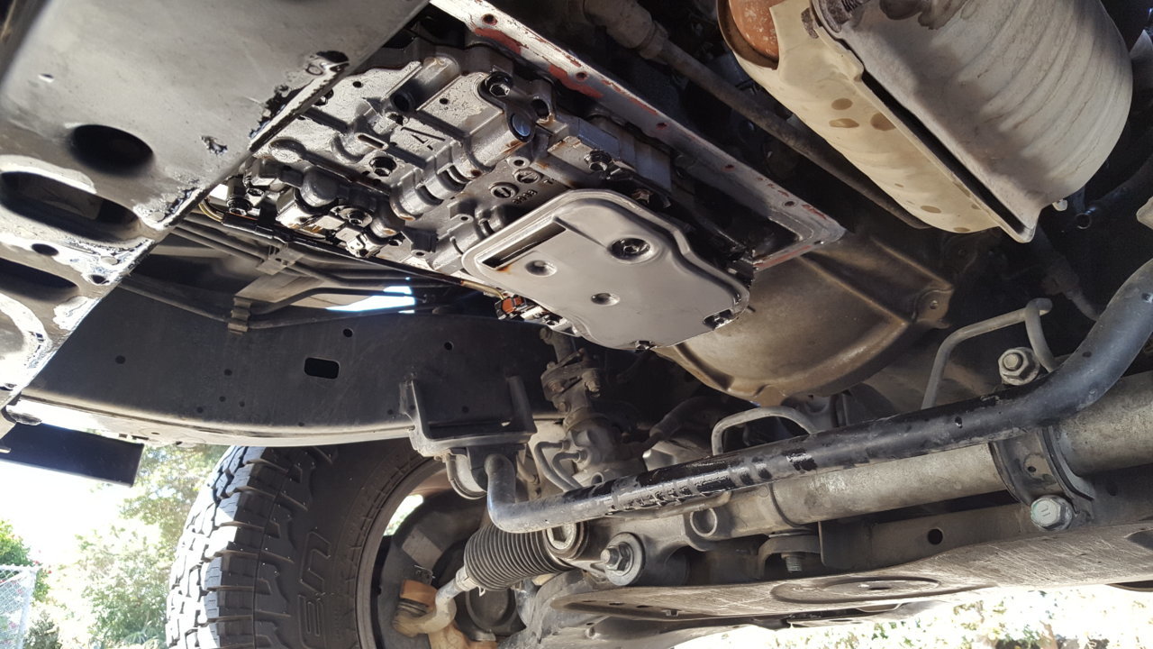

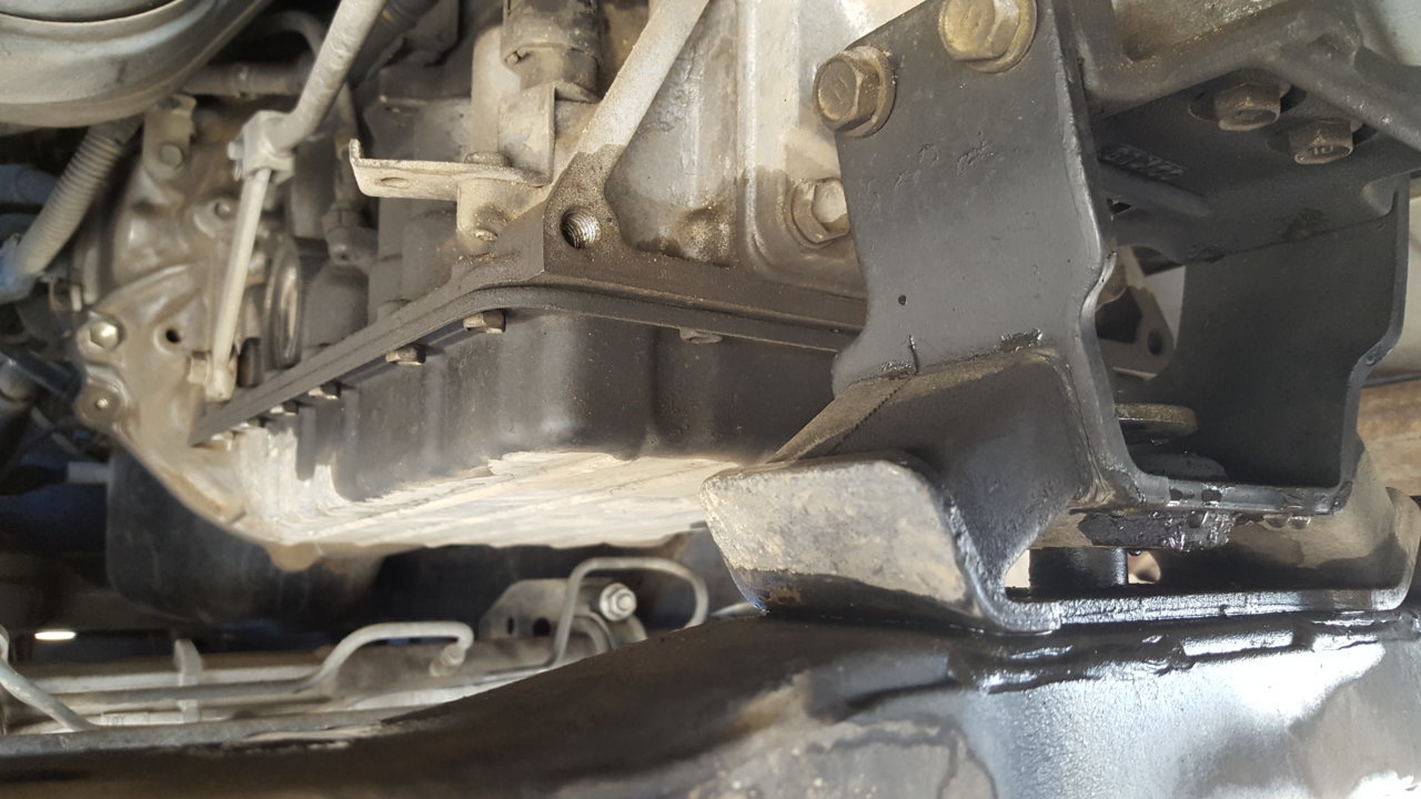

    Wait did you use a gasket? The a340 is just fipg if I remember right
    the orange stuff. Black won’t last
    Running Board Man and CS_AR like this.

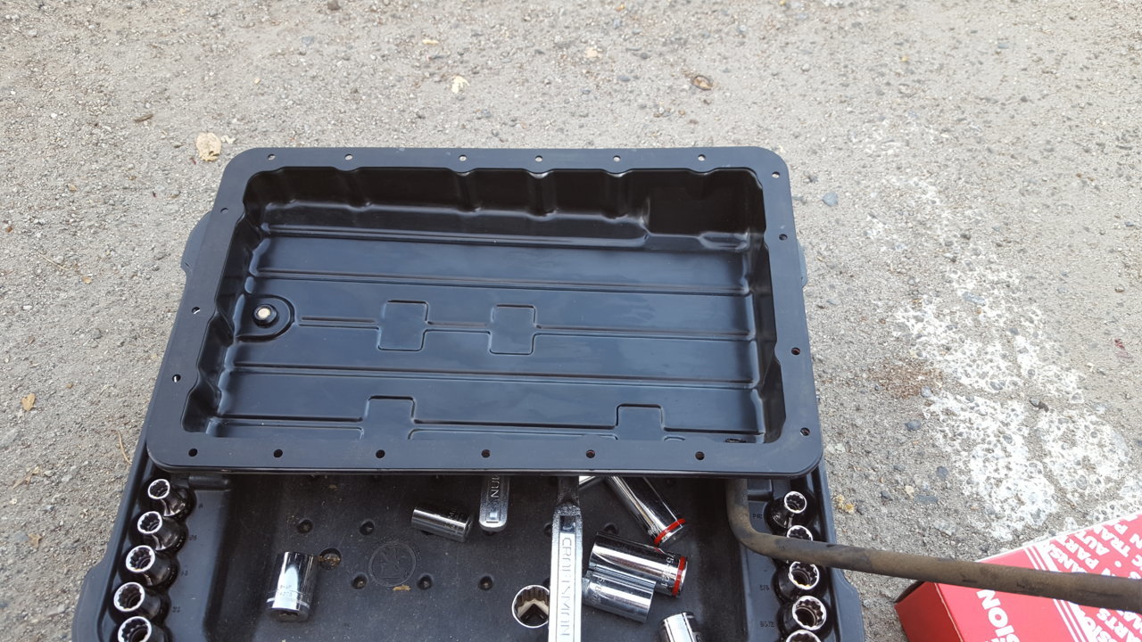

    Hard to see but thats a gasket on the pan, just happens to be black as well.
    When I took it apart, I remember posting about it and asking if the gasket maker you squeeze out is from the factory and many confirmed it was.

    Get the orange stuff from Toyota, lay a deacent bead with it slightly towards the inner part of the pan
    cruiserguy and Kwikvette[QUOTED] like this.

    I know you didn't ask for me specifically, but a couple things came to mind(that you might've already done), until the pros chime in:D double check the drain plug; and if it is in fact the gasket/pan leaking maybe snugging up or double checking the transmission pan bolts.

    Yep. The orange FIPG has held up great. I figured anything that was that hard to get off would last. Black is for lower torque rubber to metal applications.

    Gotcha; probably the same stuff that originally came on the truck I take it?
    Lol I'll definitely check on Wednesday since it's my next day off.
    It's not actively leaking; seems it only leaks the way it did when I went up the grapevine in LA. Steep climbs and constant downshifting of the transmission.
    I took some steep climbs today since everything was dry ...for the most part.

    So AT or something that sees ATF should be the orange stuff huh? Dunno if I knew that. Gotta make a mental note.
    Anything else off hand that needs the orange specifically? I can Google too, but since you're here tho and someone with first hand experience is good:D

    You know, I value everyone's opinion until this comment
    :luvya:
    I'm going to go with Dan's suggestion and use the Toyota gasket maker since I'm already having an issue with the 2 month old gasket
