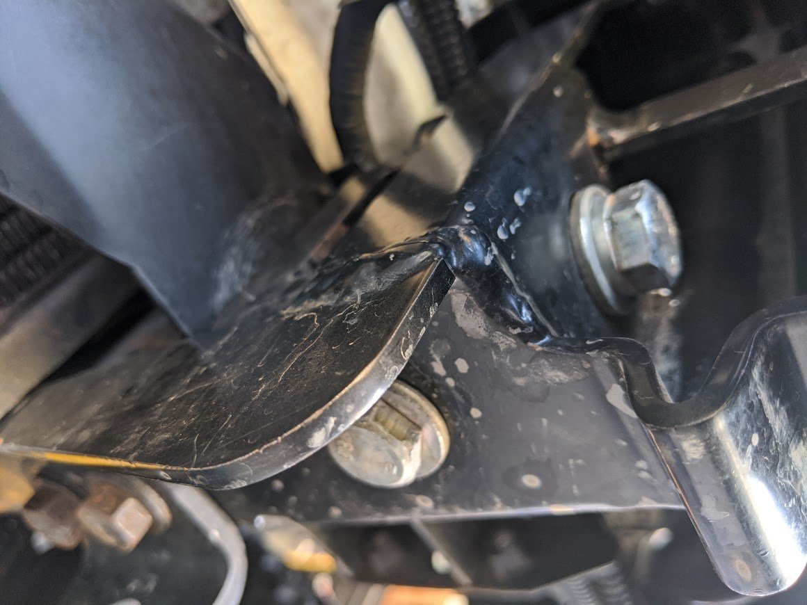

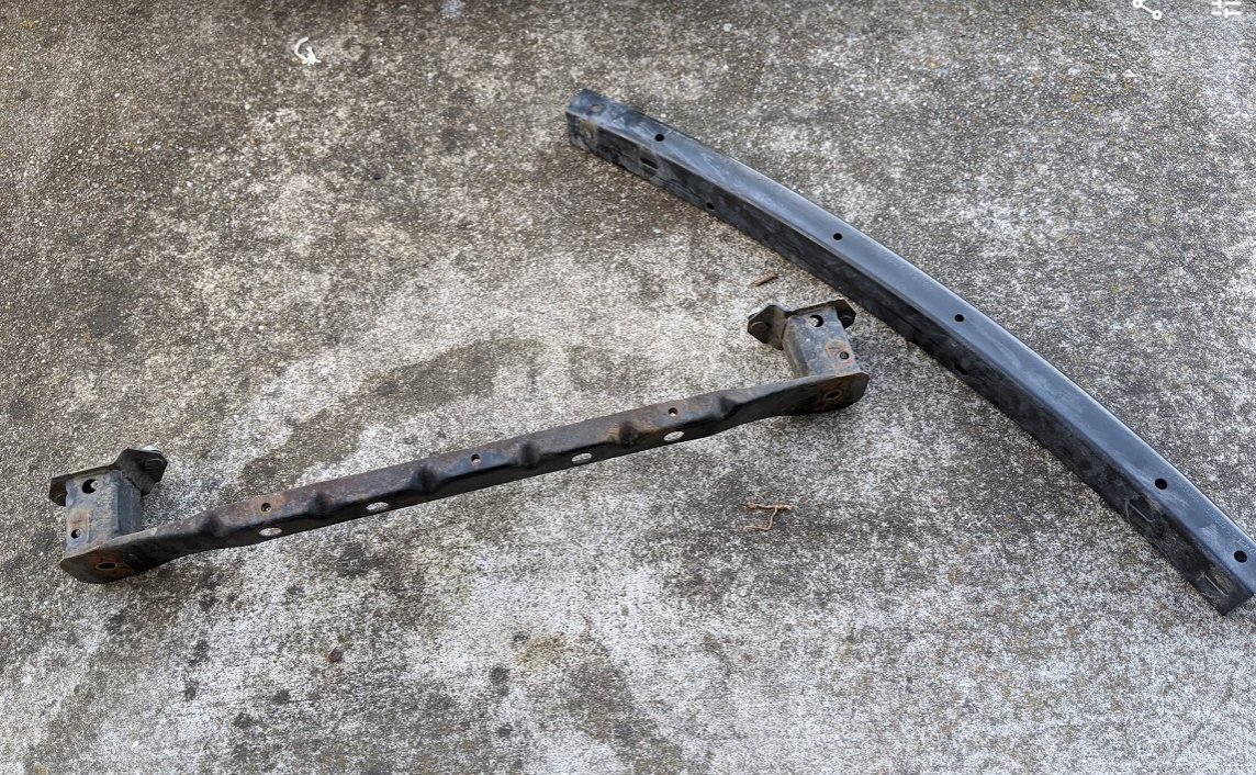

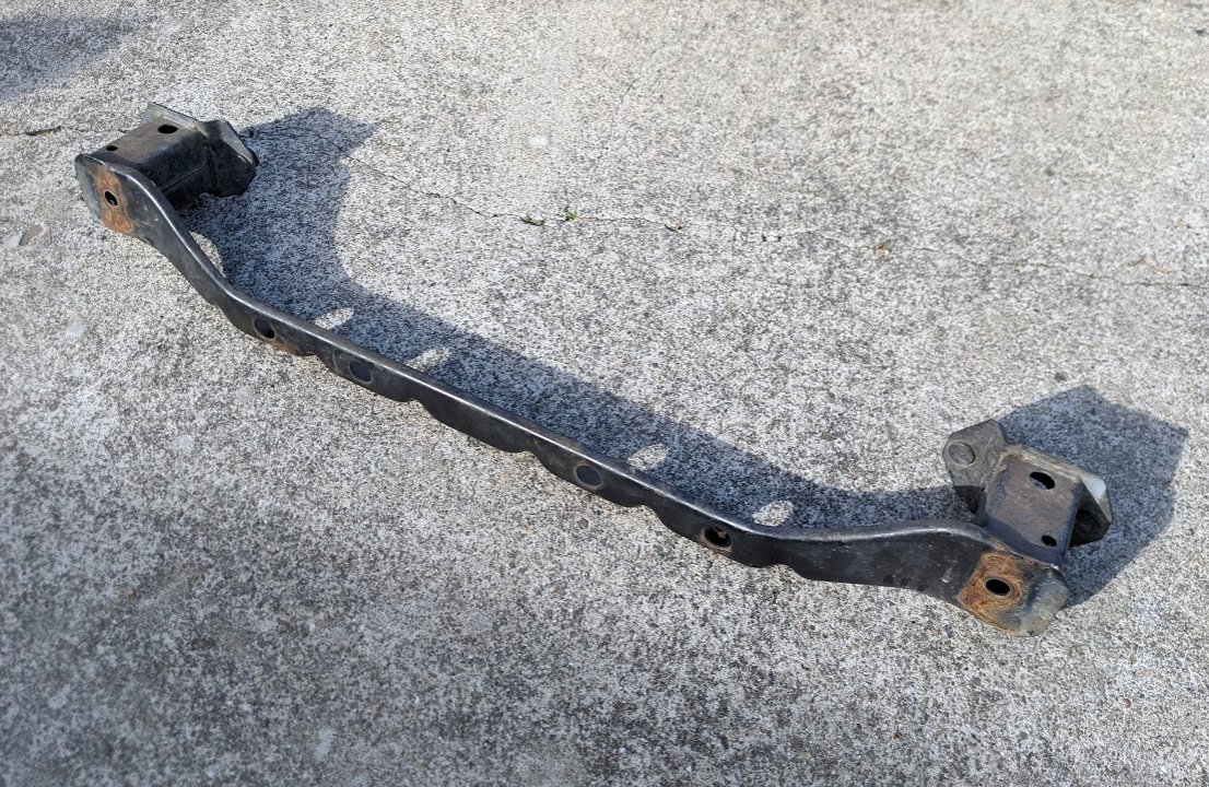

    I understand that I'm not going to follow old instructions.
    I guess I'm saying "why do I have extra parts" unless this fits between the mounts?

    if I had to guess those are for older trucks which have shorter frame horns than yours does
    cruiserguy and Kwikvette[QUOTED] like this.

    YES. Perfect. Just like that. When I said you aren't I meant cut to remove.
    No cutting needed at all. Not a word about my driveway either - I know I need to get the pressure washer out.

    I bet they’re for 98-00 that have the longer frame horns.
    You have to cut them off to get most bumpers to fit, I’d guess those pieces are weld in replacements

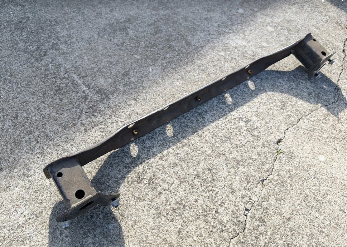

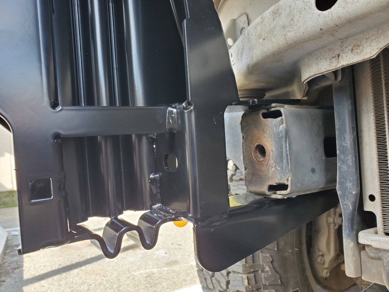

    you have it right.
    now here is mine:
    npKALEST7lw_unFUx8tyna3DcnUKEZDeuQj_b7q8_0bffede4f2a60a9ec90de8397810f10d6d43a6e3.jpg
    NaYCuq4IJy2kLnWRAllkYB1GgUA3j32fC_yjMWxR_61d4eaa7f739f6c499bd801fdaae3677847a58c2.jpg

    so yes, you WILL use those. :thumbsup:

    dont forget the cross piece which came with the bumper. be sure to put that in when you bolt up.

    Mike, trust me I know, no cutting. My impact did away with the piece you pictured easily.
    So if I'm not using it, it seems odd to have this gap

    i think you didn't see my 2nd reply when you posted this - yes, you have it right and WILL use it :thumbsup:
    you got it, no issues
