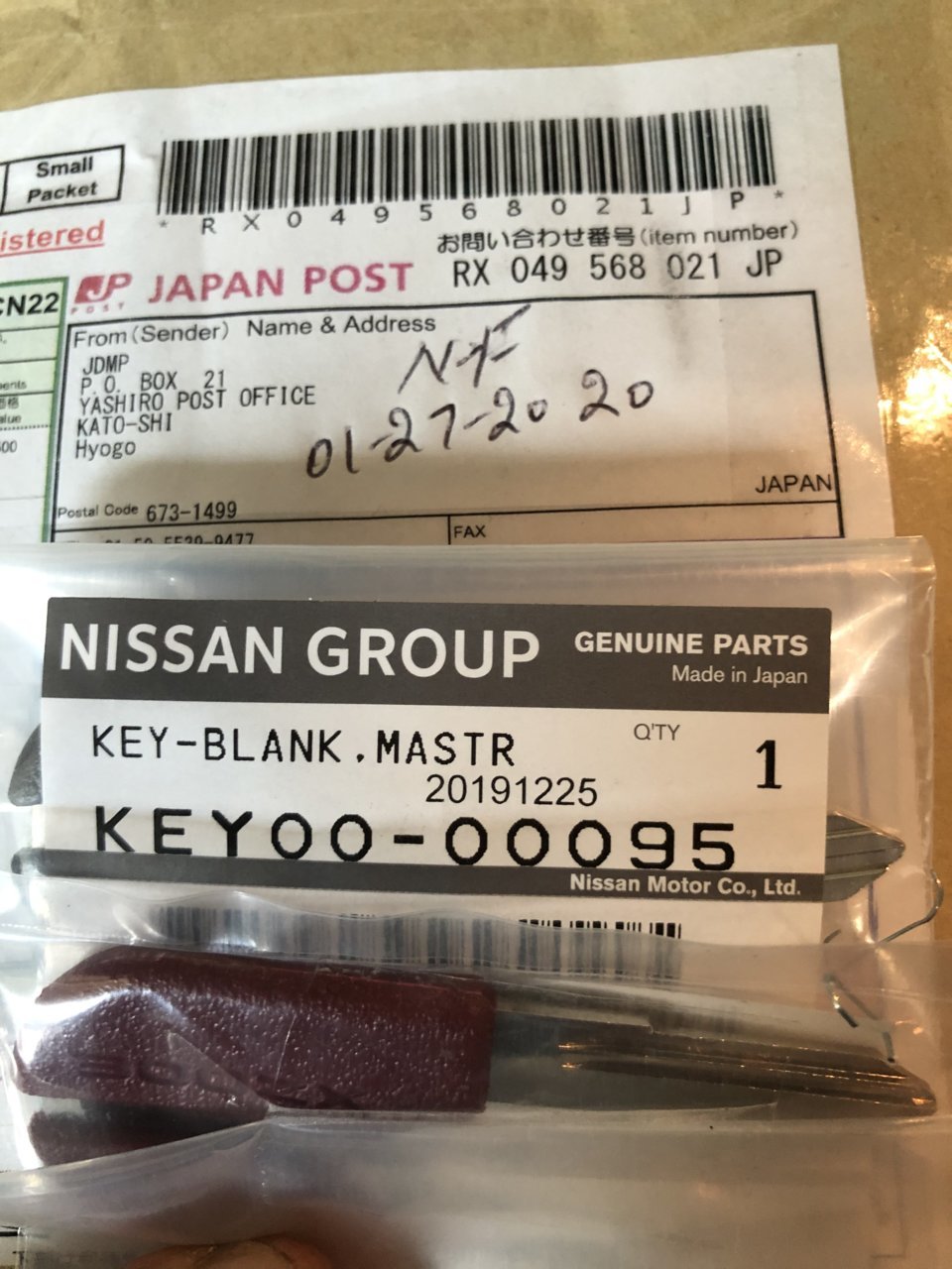

    The first set of keys I ordered that got lost in the mail finally showed up. Now I have four keys.

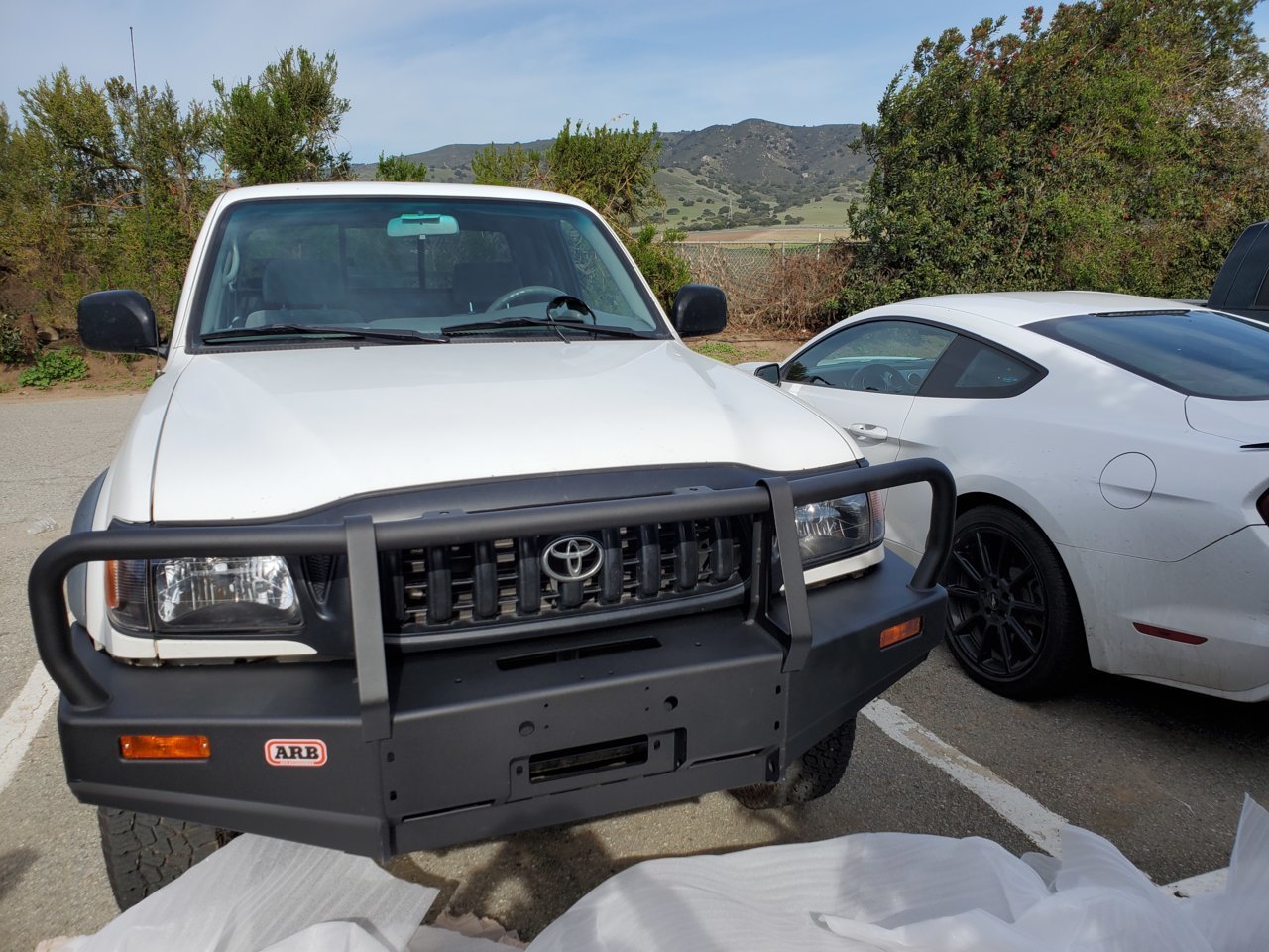

    Looks sharp!
    Use the instructions bro... I know they didn't label it but you'll figure it out. Worst case, measure them.
    The real fun begins when you place those capture nuts lol.

    Haha WTF, why does that look so complicated. The Predator bumper just bolts to the frame horns and tow hook bolts

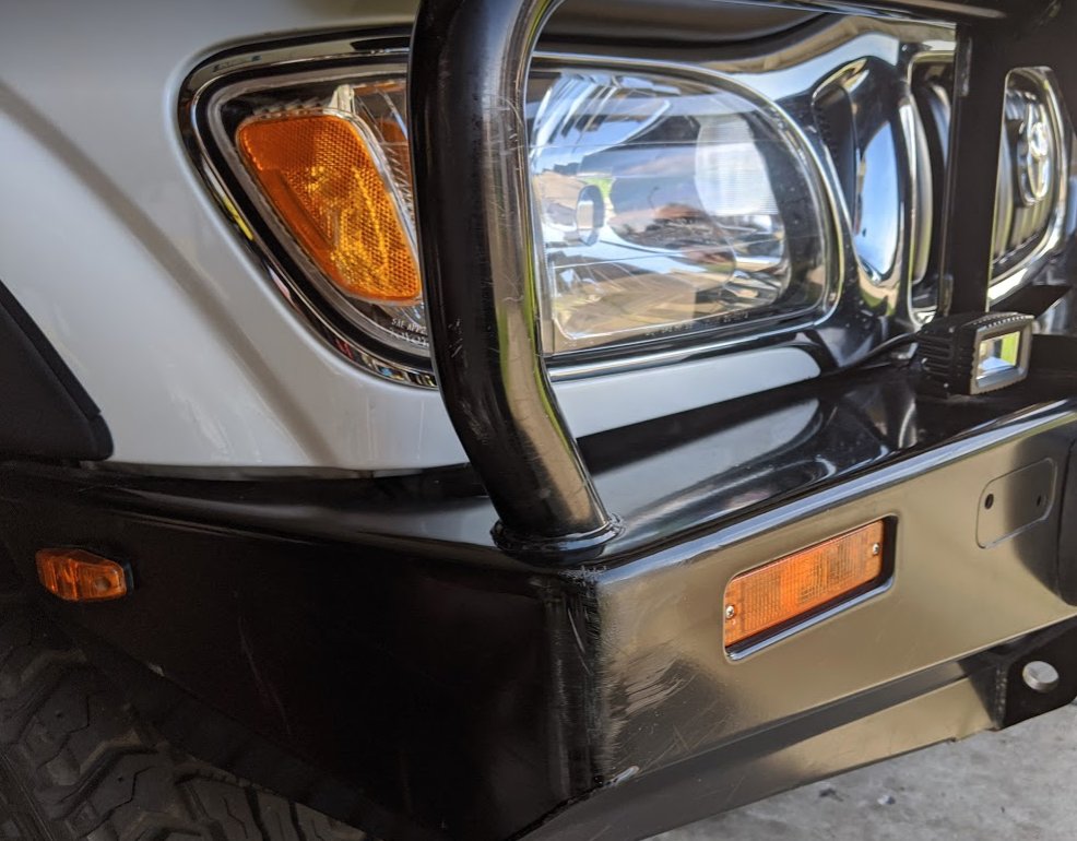

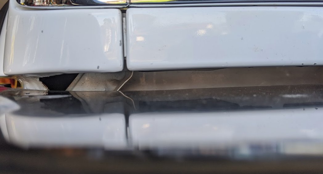

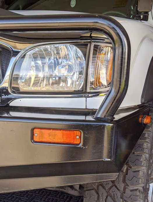

    you'll notice, when you have them in place and the bumper is resting on the mounts, you can adjust the amount of gap between bumper and fender once you have the bolts threaded in. About a 1/4" gap between bumper and fender should work. This is where the big chunk of wood (about 2.5') and the floor jack comes in handy.
