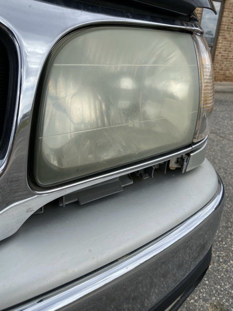

    What's the best way to clean factory headlights to get them back to clear instead of foggy?

    I mostly just repaint mine because after the cutting and trimming and smashing the hell out of the driver's side one, I just don't care enough about them to take too much time on it. Just pull them off and spray paint them then pop them back on, I just use basic black spray paint nothing fancy

    I just use the basic headlight restorer kit that the auto parts stores sell. Some are more expensive than others but they all work about the same. If your headlights are too far gone though you might need something more professional, or replacement, IDK.

    Either the 3M or Sylvania restore kits. Won't save you money, just time. Eventually you'll need to do it again or replace.

    2000 grit, 4000grit, with soapy water, plastic polish+ elbow grease

    Plus a UV protectant coat of some sort.

    Did the same on the Taco, see my pic above. The 4runner headlights cleaned up amazingly with those 3M polish kits and a cordless drill.
    Driver's side cleaned, passenger not.

    The kits have a few tiny round wet sanding pads, a small packet of polish. I use 3m pro foam pads cut small and 3m polish. Coppertone greaseless sun tan lotion for uv with each hand wash.
