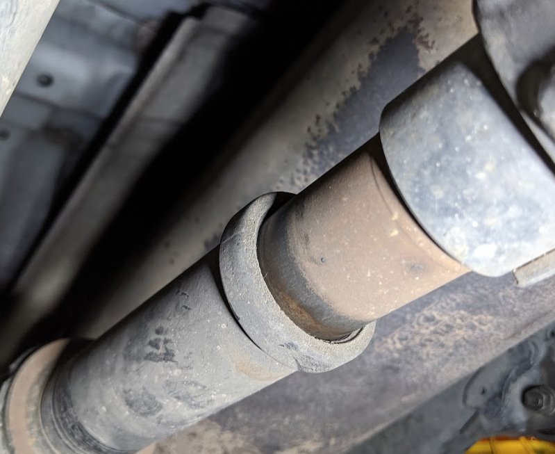

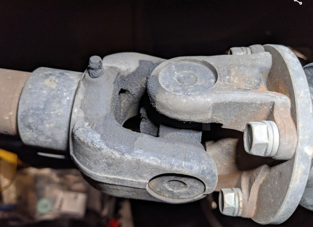

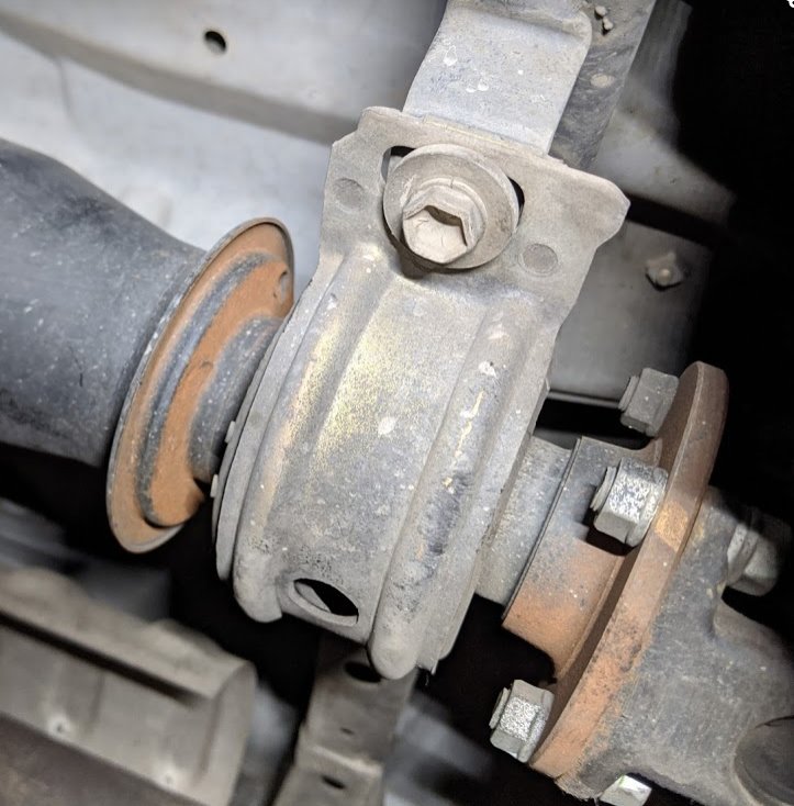

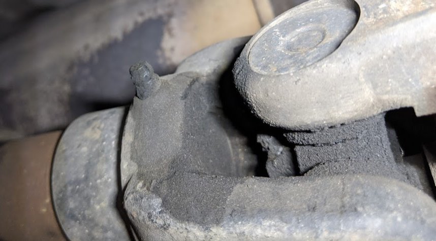

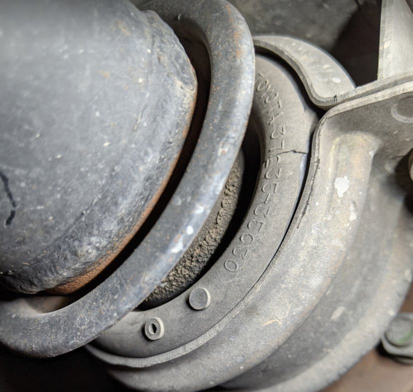

    02 3.4 DC TRD PreRunner 4WD SWAP
    Definitely some play - not sure about 1/2" I'd say at least 1/4".
    Some pics although they don't say much at all I guess

    Even a brand new one will have a quarter inch or so of play.
    Area51Runner[QUOTED] likes this.

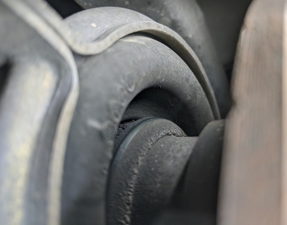

    Looks like the rubber is split and cracked in that first pic.

    Put the truck in neutral (block the tires) and shake the shaft at the joints

    Good eye. Didn't even notice that.

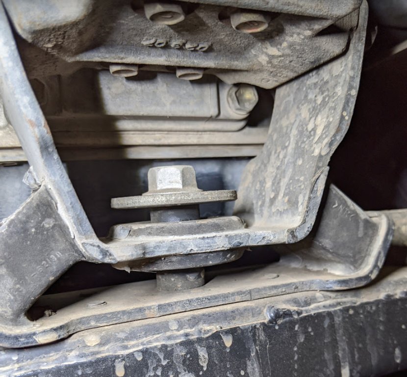

    trans mount - I thought there should be a bit more of a bushing there... there is play but I think that is to be expected. Just not sure how much.

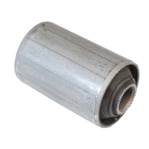

    Did you replace them with these OEM rubber bushings in the metal sleeves? Wondering if they need to be pressed in or if you can whack them in with a BFH.
    I have a couple of these at home just chilling in my desk brand new.

    yep, those were the ones I pressed/hammered out that came with the dakars. should never have removed them. :(
