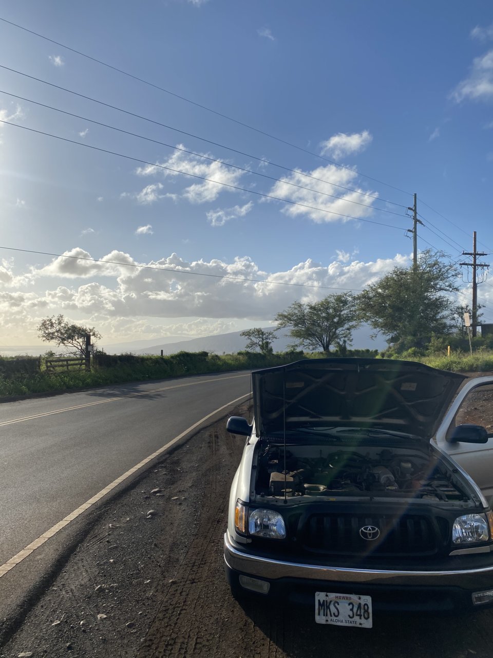

    a dropped one and a high one
    hose running to thermostat is hot but I can grab it with my hand

    My resv only has a few drops in it. I’m waiting till it cools down and it’s probably been a slow leak somewhere is my guess

    Least i have a nice view while I wait for my girlfriend to bring water.

    Unless my scan tool is fucked it got to 220-215. Mother fucker I am worried this is a head gasket oil is clean looking

    At what temperature should I be of concern, I’m gonna top it with water and fill the res as well, but I’m gonna keep my scan tool plugged in to monitor it

    Well I had hot air last night so I’m thinking bad radiator/ or bad water pump
