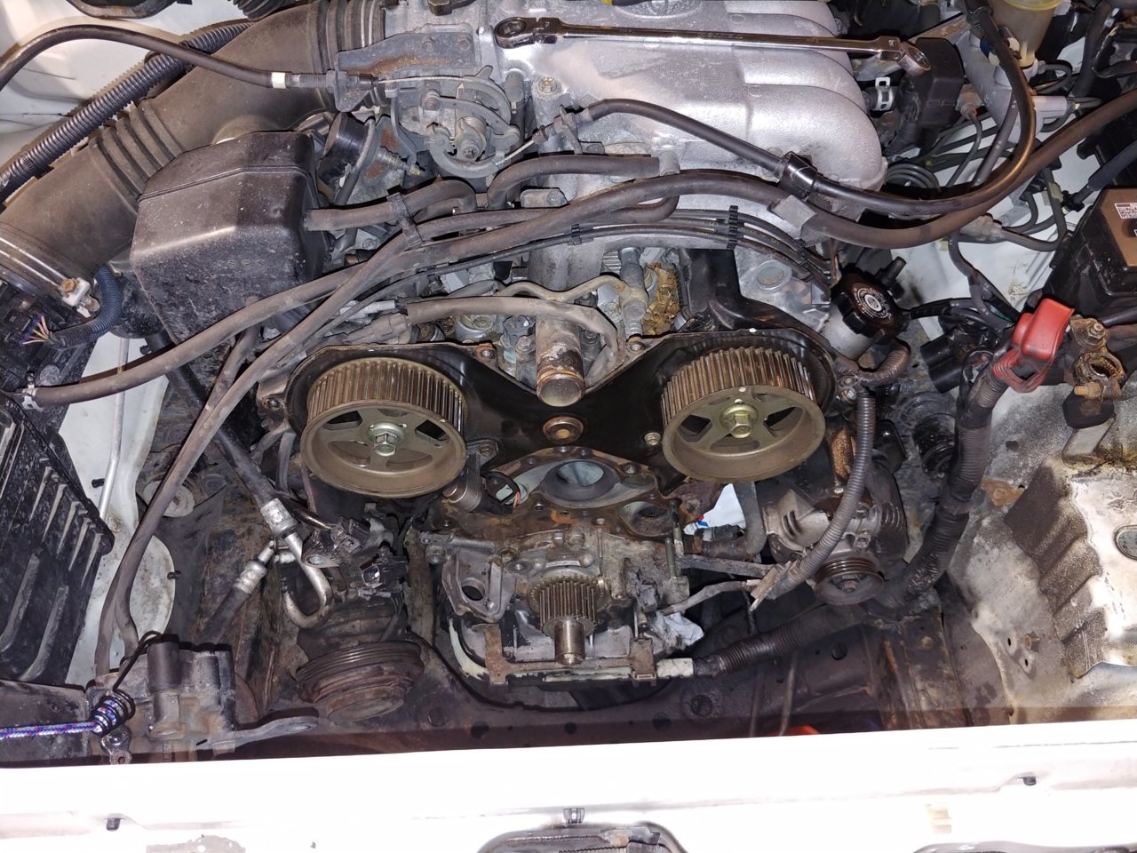

    Ah shit, I meant to take the bumper off and the rest or this shit fell off too, anyone know what all I'm missing?

    Everything but the driveshaft. B03A - 410
    Go deeper.. Replace the cam and crank seals while you are in there.

    And get on TDC.

    Your commutator bypass valve is missing

    The freaking timing chain is gone. Go back to a 3RZ :boink:

    Fuck! Well good thing it doesn't sound important. Also my engine has the smooth valve cover.

    I should, but I don't always do what I should. I forgot to order them :/

    One cam moved while I was fucking around. I'll put it all back when I put the belt on. It was on TDC when it came apart
    I'm gonna deep clean everything while I'm in there. And put in the 105a alternator too
