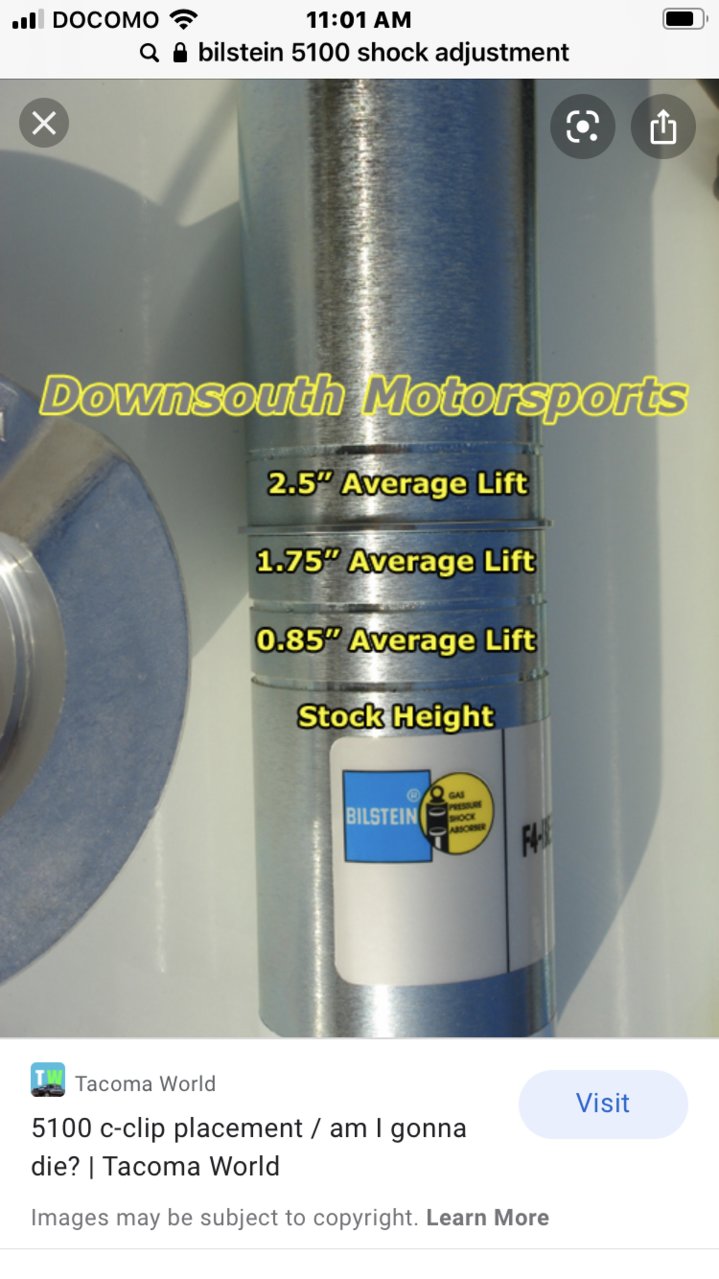

    I have the billstein 5100 toytec 3” lift add a leaf on a 2004 Tacoma 4cyl 2.7l 4x4. What clip should I put the strut on to achieve a 3” lift.

    Gonna go to shop in the morning should I put to 0 or .85

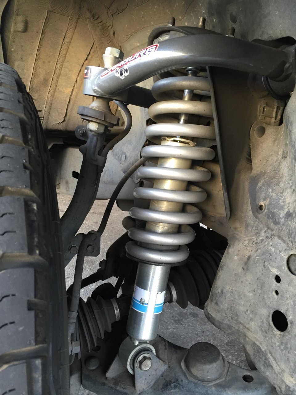

    Put it on the bottom ring for 3"
    Here is my truck on the bottom ring.
    I ended up putting it in the middle ring before I went with King's.

    I wasn’t sure about the clip. I e read people put on the 0 and then some on .85
  13. Jul 11, 2020 at 2:09 PM
    Guahan
    Guahan [OP] Member
    Jun 29, 2020
    #332945
    8
    Jake
    2004 2.7l 4x4 taco
    3”billstein toytec
    It did arrive on the bottom clip but like I said I am a noob and didn’t know any better.

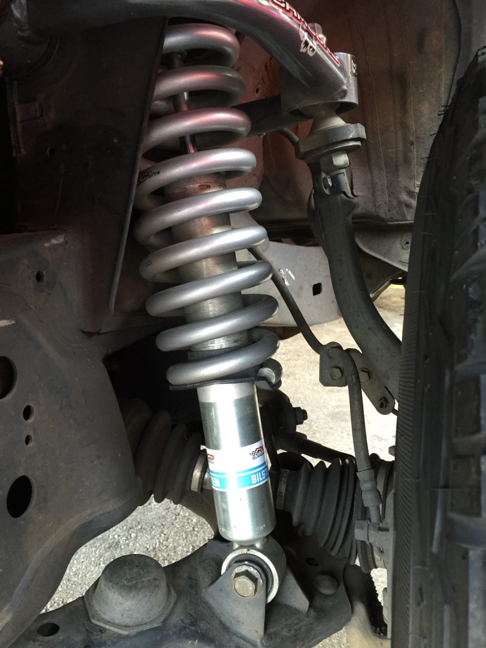

  17. Jul 11, 2020 at 10:49 PM
    #17
    Sicyota04
    Sicyota04 Slowly but surely.
    Jan 9, 2015
    #145940
    3,558
    Morgan
    California
    04 DC 4x4
    Yep. My first lift after a shitty spacer lift, was that Bilstein / Eibach coil 3” lift w/ 1.5” AAL. Same as the Toytec
    The Eibach coil provided 3” of lift on the bottom notch of the 5100.
    Then I went to Icon & finally King!
    :rofl::rofl::rofl:
    My truck is a DC with the 3.4 though. So more weight in the front. Not too much though.
    I thought I read that the Toytec / 5100 3” lift wasn’t recommended for the lighter trucks. Standard cab or 4 cyl
    Could be wrong though.
    Here’s what it looked like when installed.
    Good luck with whatever you set it at.
    Guahan[OP] likes this.
