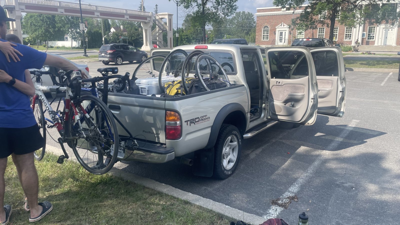

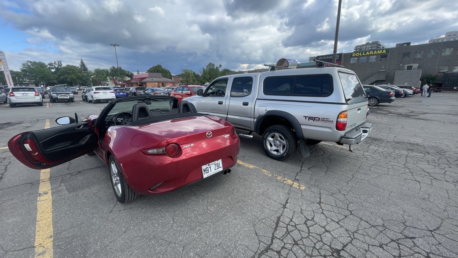

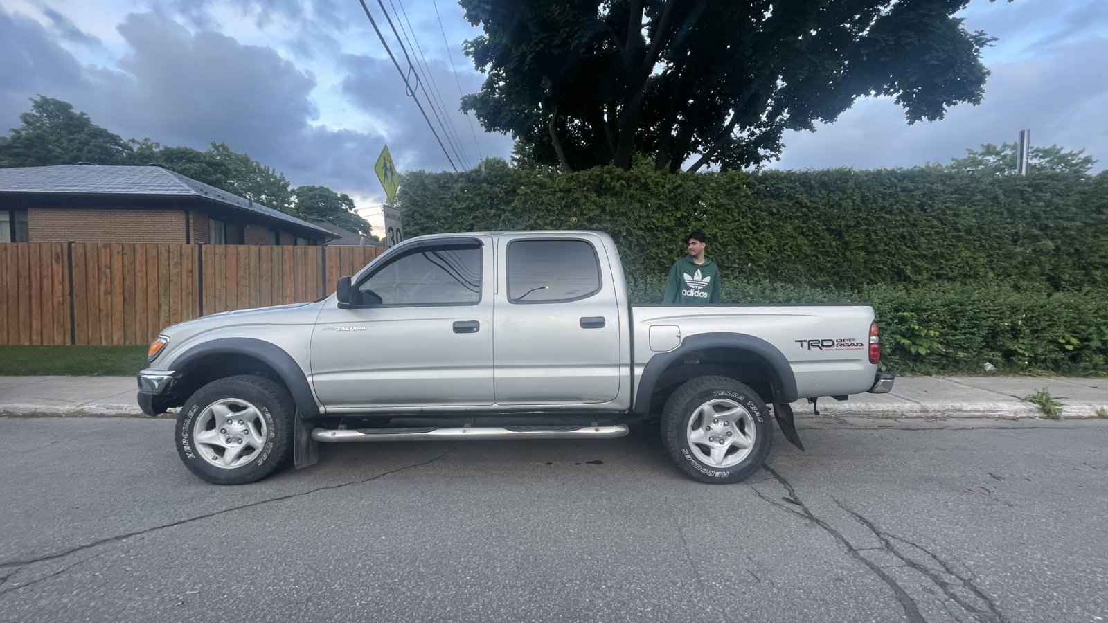

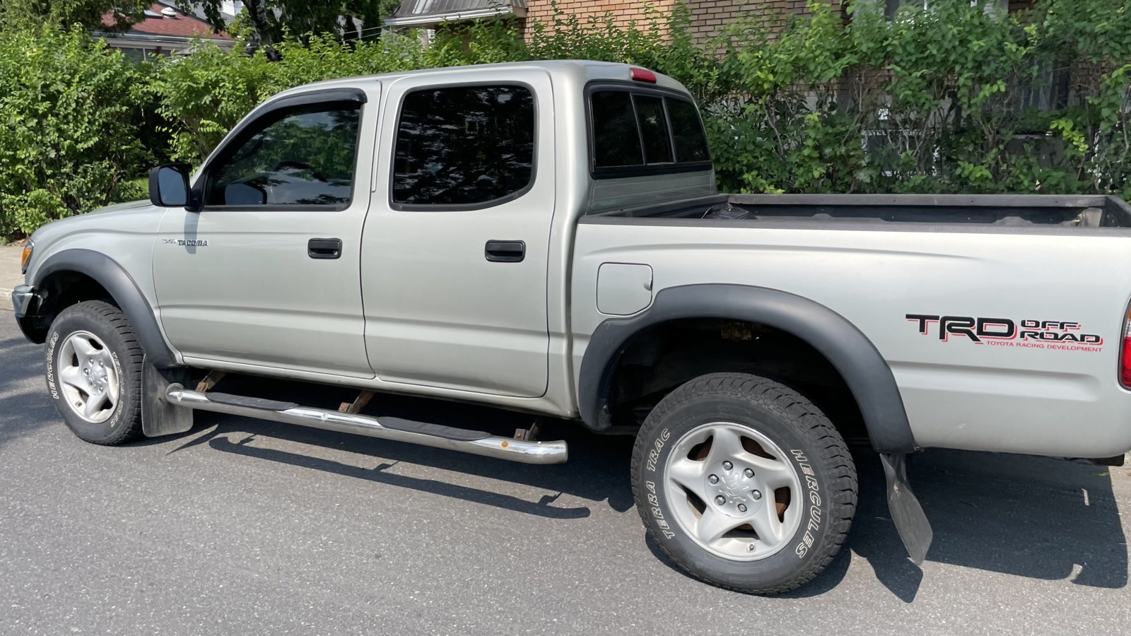

    Hello tacomaworld, been lurking all summer and found gobs of great info!
    here’s my 2004 double cab prerunner with 290km’s. I paid 6800$ CAD and drove all around Saguenay (Québec, opposite side of California) and in the woods fully loaded with 3 people and 2 dogs and all our stuff and bikes without putting a penny on it this summer. I love this truck now.
    Brought it to the most reputable shop in the greater Montreal to get the frame assessed; it’s in great shape! I asked him to take a looks at the truck and he’ll be doing all the parts that need love:rotten original shocks (for bilstein 5100’s, LBJ’s, steering racks and pinions, a frame crossmember, transmission mount, a gas tank, a few belts (forgot) and a small repair on the frame. He quoted between 5-7k which sounds reasonable considering the cost of OEM parts.
    here’s pics of her when I got her: guess what tire size she came in… IMG_5909.jpg IMG_6457.jpg IMG_6075.jpg IMG_5906.jpg IMG_5910.jpg IMG_6994.png

    Why is the side step so much lower on the driver's side than the passenger side?
    CrippledOldMan likes this.

    Excellent observation; I got the truck this way and asked myself the same question; I’m thinking the previous owner might have been vertically challenged or an old man, which would explain much smaller than stock tires and a lowered side step
