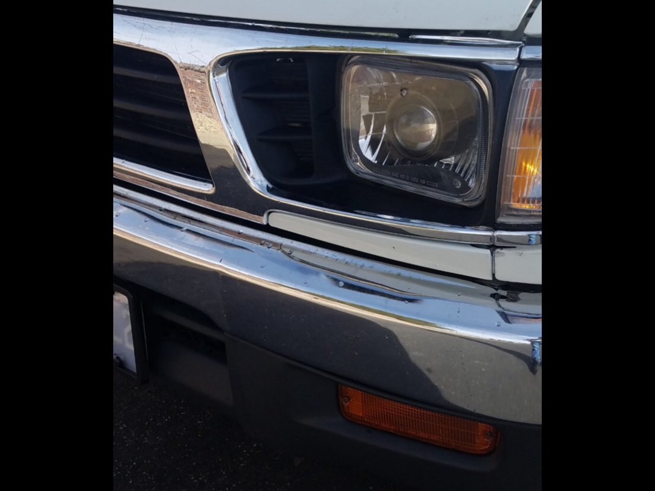

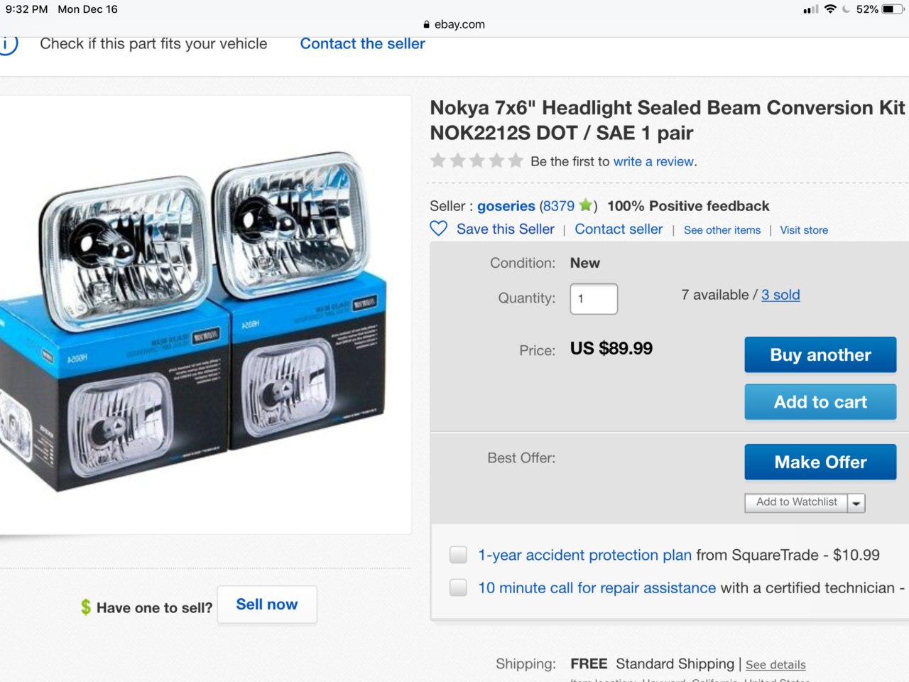

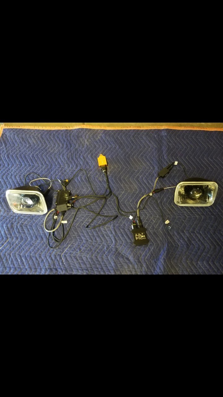

    I just did this swap with the 7x6 bucket.
    I got the Nokya lens,
    They are optical clear glass lens with thick aluminum metal buckets.
    Much better quality than plastic but harder to cut.
    The 7x6 is a small bucket and the back mounting section needs to be cut out in order
    for the projector to fit, so the horizontal alignment ring will not work and is a pain
    to get it lined up.
    But well worth it once done.
    I would definitely get the wiring harness too

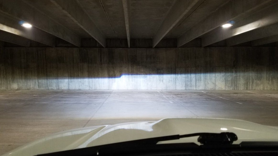

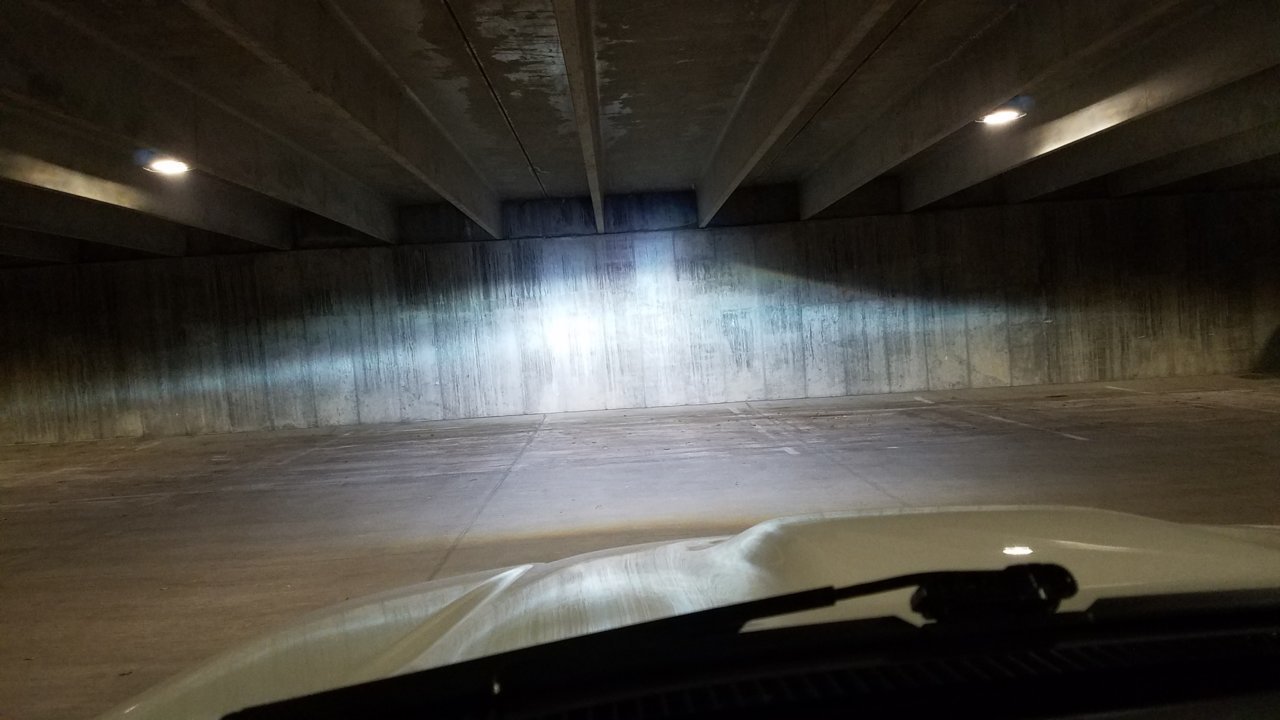

    Here’s a sample

  18. Dec 30, 2019 at 8:07 AM

    curious how those are to oncoming traffic?
    i know there are certain headlights on vehicles out there that near totally blind me at night!

    The 1st photo shows hi beam and low beam, the projector has a cut off as you can see so it is controlled.
    Regular lights lend to throw scattered light LED in particular. These you adjust and don’t do that.
    Look at the photos again with the low beam cut off,
    There is actually a set cutoff to not have that issue and you adjust the beam height to around 28” that is just below the on coming traffic
