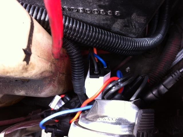

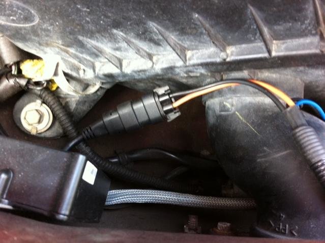

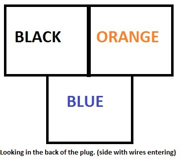

    Does anyone know if this is still an issue with newer kits? I just received a mini H1 kit and the plug on my harness looks like
    Black | Blue
    White
    And correct me if I'm wrong, but that plug is only used on one light, correct? And you just leave the passenger side unplugged?

    it doesnt look like the problems were localized to one set of projectors, kind of randomly hit or miss (99% of the installed kits ive heard about havent had this problem though)
    and you're right on the plug. Power comes from the battery so that one plug is basically just an on/off and hi/lo switch
