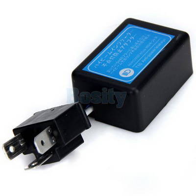

    Get one of these for the passenger side - it was something like $5 delivered.
    The problem with that is...how do you know when you've inadvertently pushed the stalk forward and your highs are on? In full darkness you could tell, but what about when it's still light out and you can't really see your own beams yet?
