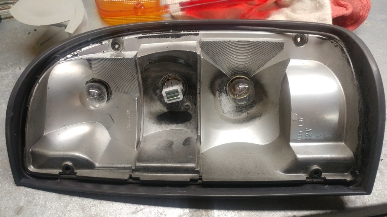

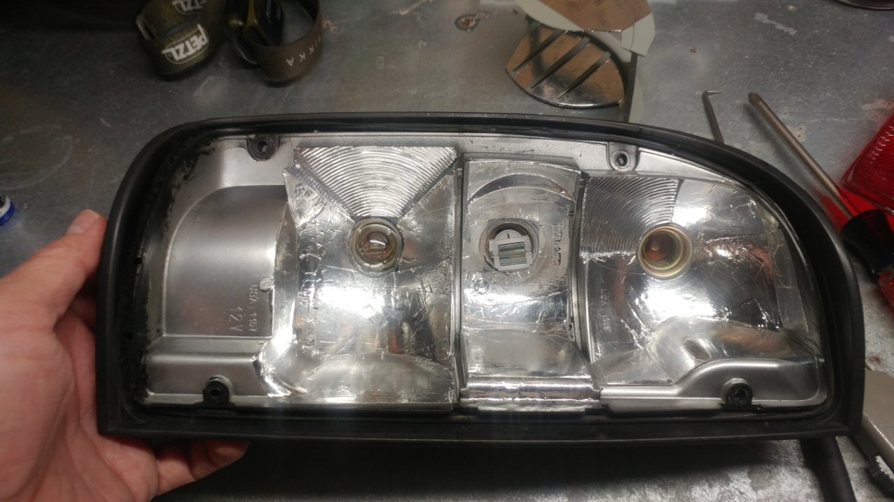

    I bought what they had at Advance Auto Parts. Sylvania I think. They are brighter than regular bulbs but the thing that made the biggest difference was lining the tail lights with aluminum duct tape. You can get it at Home Depot or Lowes.

    Good job!!Do you have any before/after shots? I think I'm gonna steal your idea.

    That's a good idea. I had good results repainting mine with silver BBQ paint.

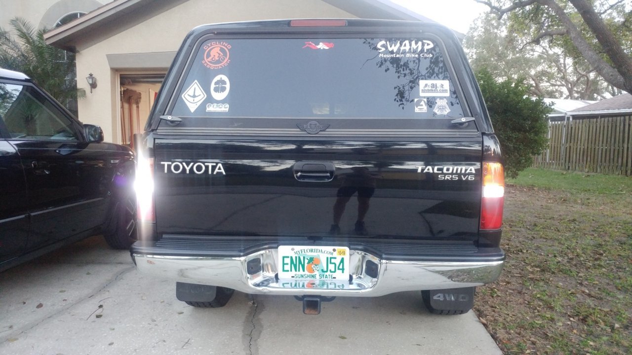

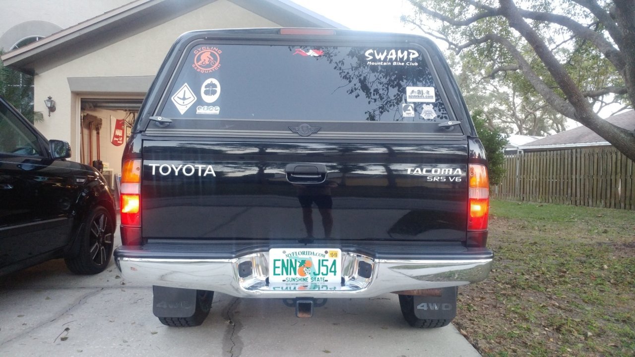

    Sorry for the slow responce.
    The first pic is the tail light comparison with bulbs before and after taping them. The second is LED vs bulb with the tape.
    To be Honest I couldn't see a big difference between the LED and bulbs for the tail/brake lights, but there was a huge difference between the two for the back up lights. 0112191749a_resized.jpg 0112191749_resized.jpg

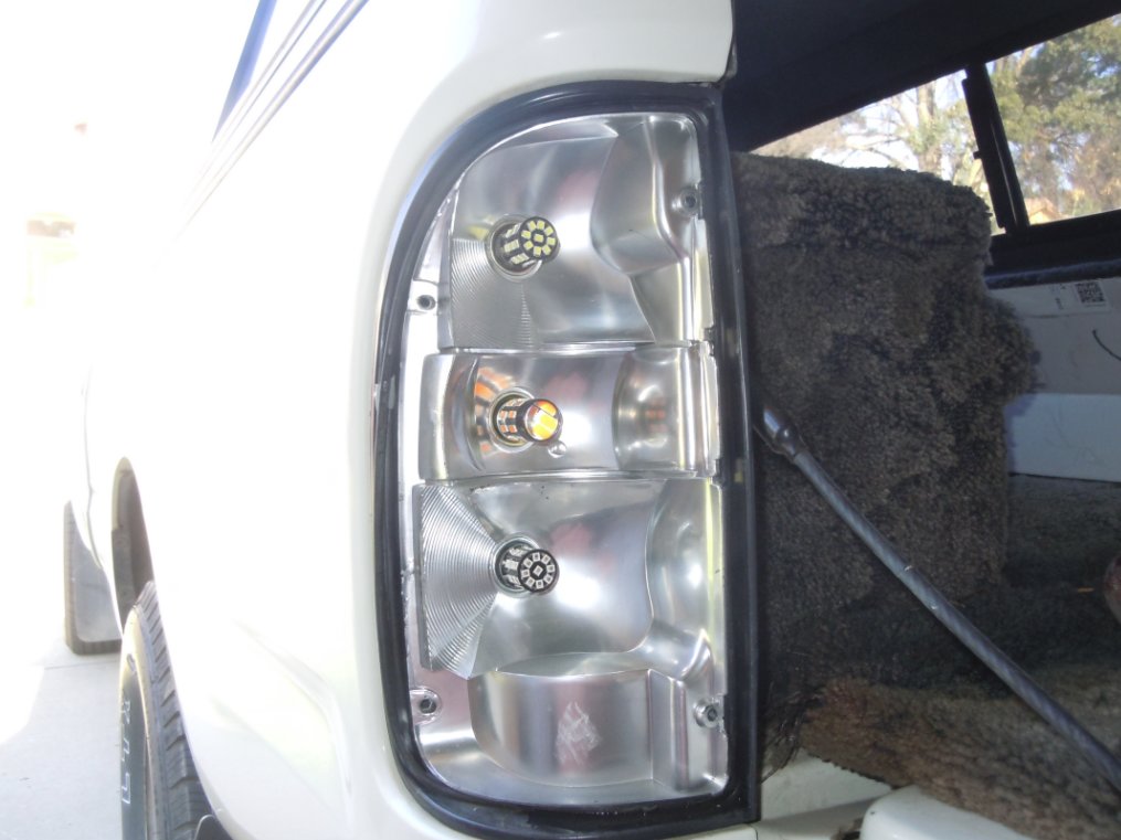

    What I did was: I replaced the stock thee-color glass with red/clear:
    swapped reverse light position with blinker and replaced all three bulbs with LED: white for reverse (top), amber for blinker (center) and dual intensity red for stop and tail (bottom):
    Then I dumped the plastic divider that was originally around the center bulb. The divider was to block the light from neighboring bulbs (stock clear bulbs) that could illuminate through to other lens. With all three bulbs being different color it is not needed. So the top part of glass being clear the reverse bulb is less restricted giving a bit better illumination. Additional benefit of using top socket for reverse is that top socket reflector is bigger and spreads light better then center socket.
    By the way swapping bulb positions was done by swapping connectors at the plug, not sockets :)
