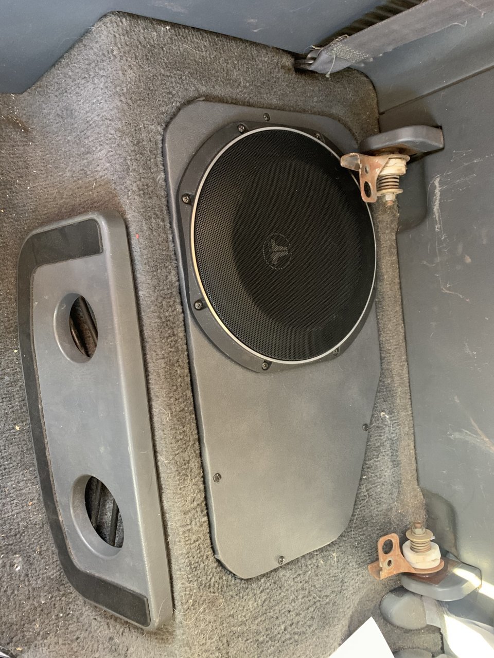

    Not too bad. A little fabrication involved. Just did this. Spent a few hours of my Sunday. Wanted to keep it hidden but functional.A7539C64-A368-43B9-98B3-F45E8268F992.jpg

    Used some matching vinyl to cover. Kept the frame and cover to return to stock if needed. I swapped the seat hinges right to left and flipped the seat upside down to gain 1/2” clearance for the speaker grill.

    Slight trimming of the metal under to fit a 10” JL Audio.

    That looks great to me. Was just going to ask if 10". Did you put an amp under the front seat or in that cubby hole too?

    Amp is mounted under the seat. I didn’t want to cut air flow for cooling. The other cubby is still for storage.

    @tobysan1966 When you say: "I swapped the seat hinges right to left and flipped the seat upside down to gain 1/2” clearance for the speaker grill" - could you explain this a little more? I installed a fabricated a wood plate and installed sub in the cubby as well and top mounted it like you did, and didn't have to cut any sheet metal underneath. However, I'm having clearance issues with the seat folding down on top of the speaker. So, to do that to the hinges, do you have to pull off the big plastic trim piece covering the cab to go to that hardware to remove it? When you did that, I can see how it would give you more clearance for sure, but did the seat still fold down like it is supposed to? Seems like it would not latch in place like it needs to if the are flipped upside down. Also, I'm having rattling issues with the seat and the bass, does yours rattle with the extra clearance? I appreciate any help you can give me with this. Thanks!
