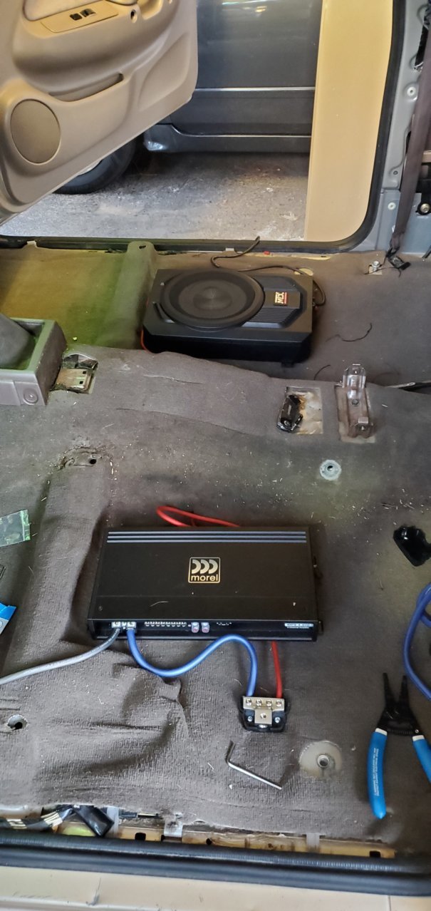

    Here's a picture of my amp before I re-ran the wire runs under the carpet and added some wire loom.
    - Amp sits under the passenger seat.
    - Ground wire bolts into a seat bolt, I recently switched to using the rear left bolt on the passenger seat (on the transmission tunnel).
    - Power wire is run through a fuse immediately after the positive terminal, I used the Rockford Fosgate fuse holder below. There is a rubber grommet on the driver's side of the firewall that you can use to run your power cable, just poke a little hole in it. I then ran the power cable under the driver's scuff plate, under the carpet towards the center console and then exiting the carpet near the amp.
    - The remote wire, and audio signal wires can be run from your stereo down the center console and out the side or rear of the center console.
    - I have my subwoofer (Pioneer TS-SWX3002) siting on the rear passenger jump seat. The low profile sub sounds good for the size, but I'm planning to build a box so that I can place stuff on top of the subwoofer if I need extra space in the rear.

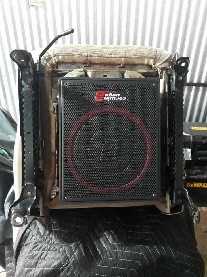

    heres mine m ounted to the passager seat, i didnt want it on the floor i have a 3 year old who will spill life its self...

    Got a model #?

    on the sub?

    yeah, but I found it
    Thanks though

    i believe theres only 1 CV 12" sub of this type.

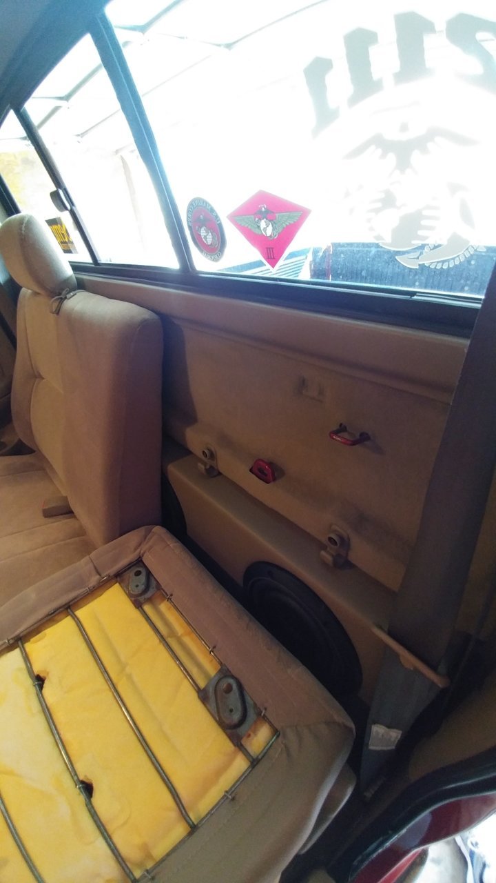

    I've got a custom made sub enclosure with dual Pioneer 8" shallow mount subwoofer in my 02 DC Pre Runner . I also have a Alpine MRV M500 amp under my pass seat and a Alpine MRV F300 amp under the driver's seat . The Head unit is a Pioneer 8400 and my system sounds awesome
    Sub enclosure ....
