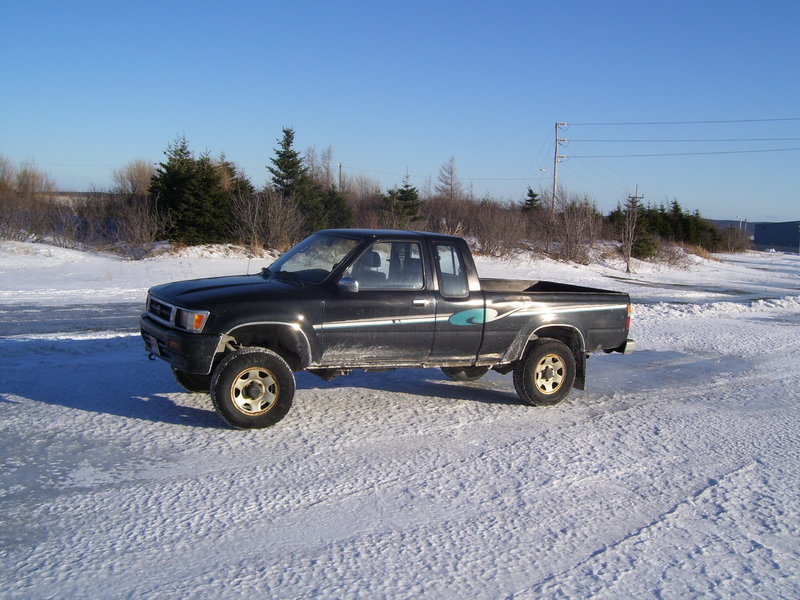

    I have had a few Toyota's over the years starting in 2006 with a 1992 22re truck that I LOVED ! I did the cam chain and adjusters and some other items. But i was doing allot of highway driving and the lower control arms were getting bad :( The truck had a MAJOR case of rust and it was in need of more work then i could give it at the time. I tried to keep it but had to let it go.

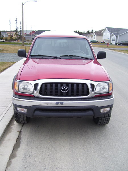

    After driving the 22re for a few years I found a 2002 Tacoma v6 Std 4x4 for sale in 2010, this picture is the day I bought it with 130257 KM on it :)

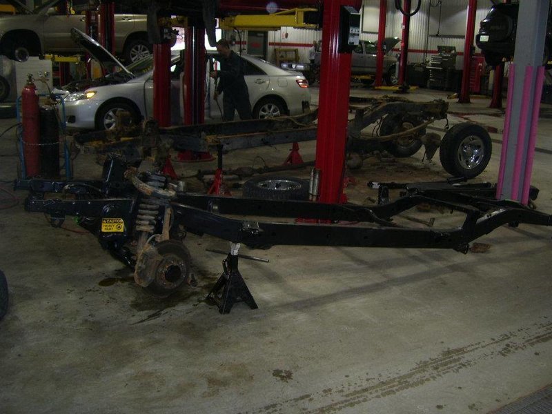

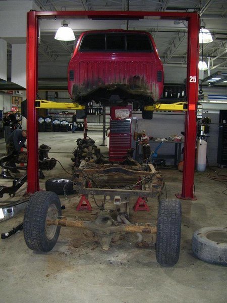

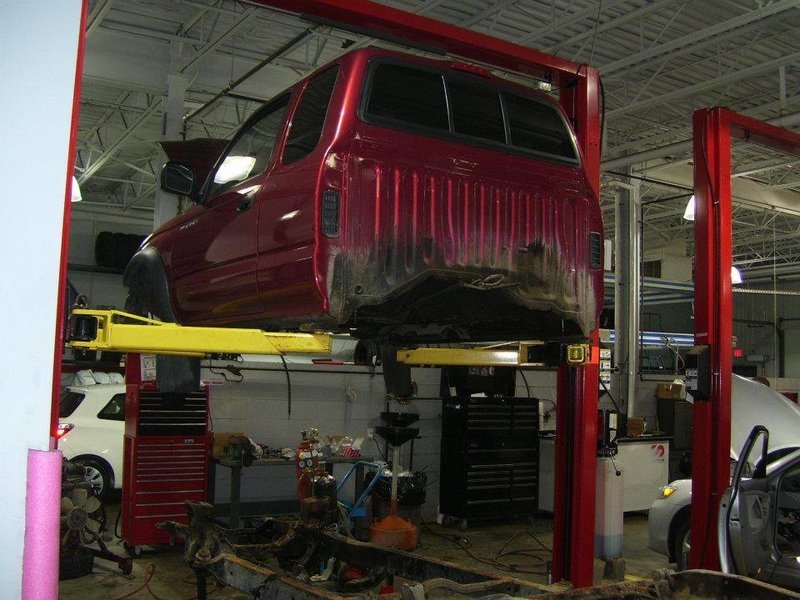

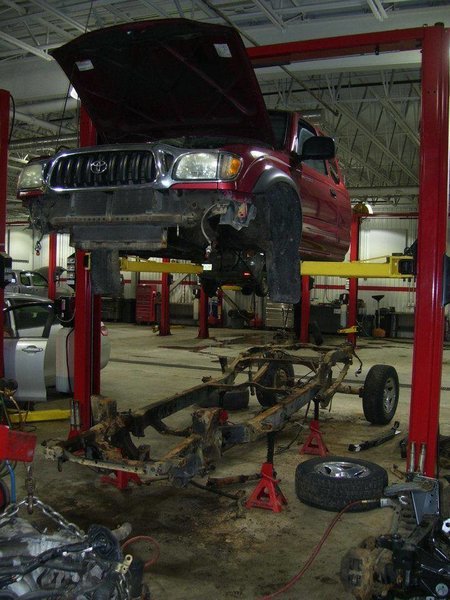

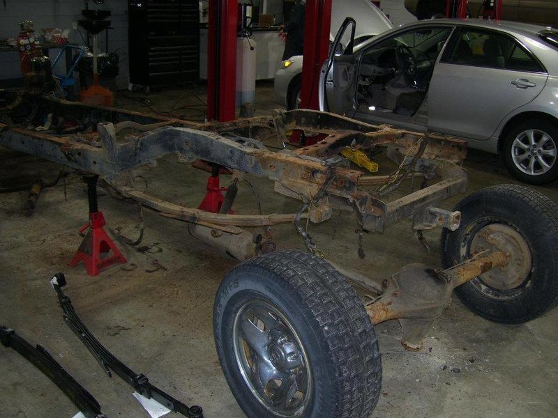

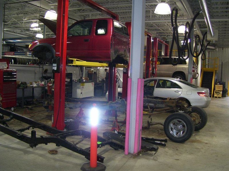

    So where do i go from here ?

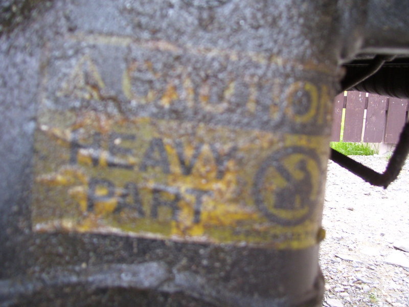

    I remove the cap and sell it, dive it for 2 years without doing anything other than oil changes.
    Go into to Toyota dealer and they inspect my frame and it passes so i get the FREE undercoating (Free Mess) two months later my hand brake cable broke so as i was investigating and trying not to get covered in the free mess i see that the frame has separated by the spring hanger.
    I call the dealer and they told me to bring it in again so they could look at it ...... HUMMMMMMM weird they did not pick up on this.... Whatever two weeks later i bring it in and leave with a rent a car for a full month while my truck gets a new frame, springs, lower control arms, and a bunch of other stuff. I was told Toyota Canada spent $16000 on my truck, I told them If they let me i would use that money and buy a new truck. No dice 14590495_10157427118735417_2595266177087288627_n.jpg 14632880_10157427118465417_3673023741949821738_n.jpg 14666042_10157427120240417_1064658026018403847_n.jpg 14666255_10157427119780417_2781069509977724688_n.jpg 14671068_10157427119110417_5321531967215544974_n.jpg 14705724_10157427119455417_949664503423107487_n.jpg
    Manfred, YDCtaco and Bocsy44 like this.

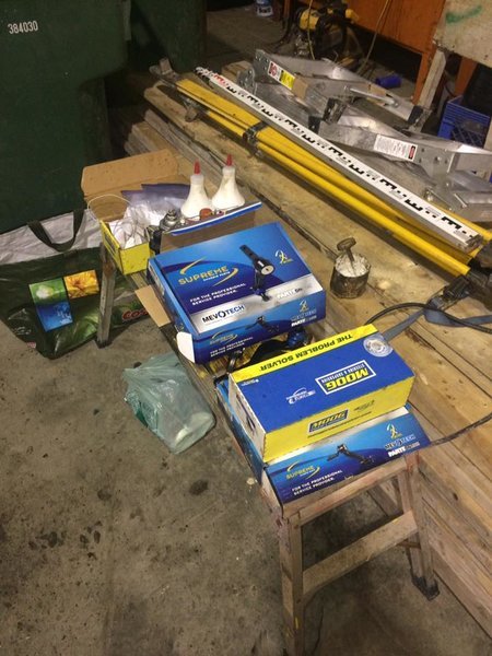

    100_1989.jpg 100_1992.jpg 100_1996.jpg 100_2000.jpg 100_2004.jpg 100_2013.jpg 100_2044.jpg 282763_10151790932435417_808674360_n.jpg While the dealer was doing the frame i had a extra leaf put in the rear springs. After the new frame i had all kinds of issues where everything was disturbed it brought almost worn out parts to the end of their life.

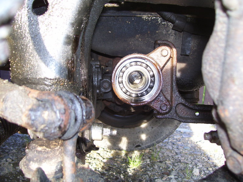

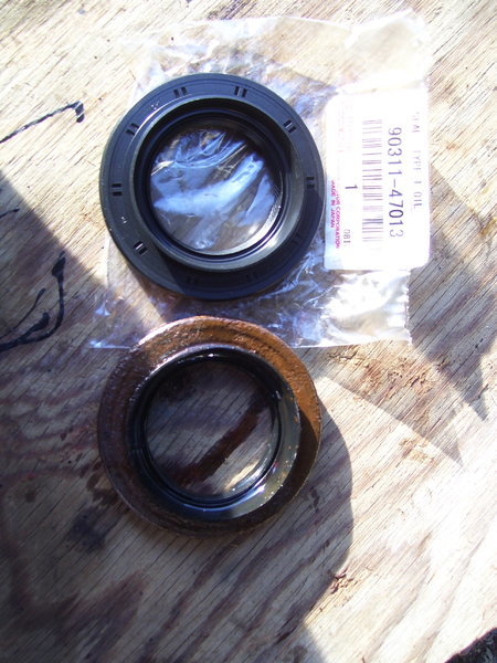

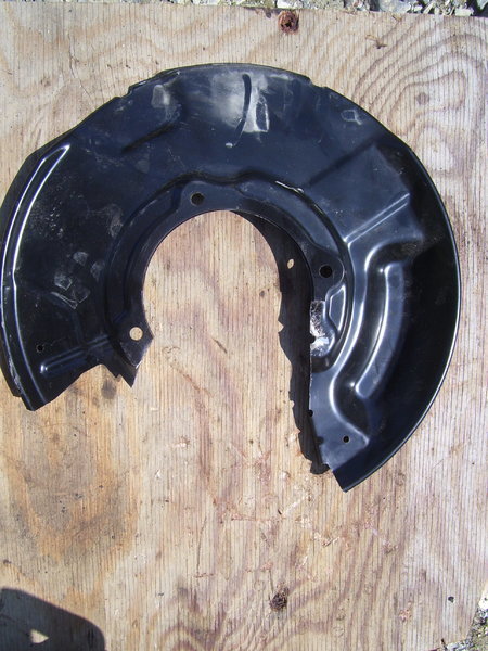

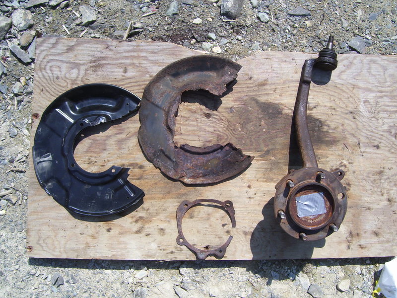

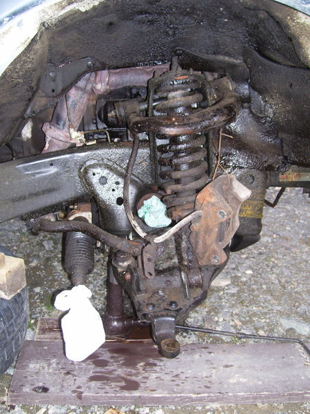

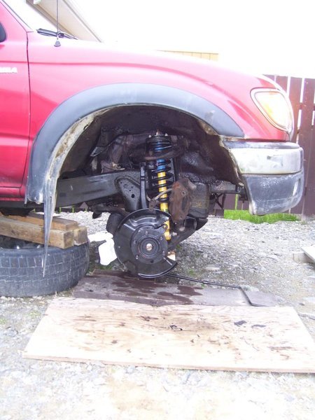

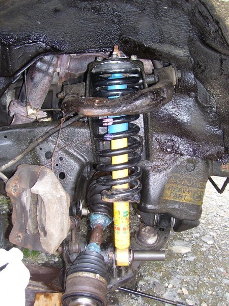

    When i got it home my gas tank started to leak
    The tank straps were also way to thin
    Reinstalled the tank and my sending unit for my gas gauge only works from full to just below 1/2 a tank
    The muffler started to leak in all joins and in the muffler itself
    Tie rod ends were worn
    Tires were at the end of their life
    With the new extra stiff springs in the rear i noticed how soft the front suspension was
    The backing plate for the front brakes was gone

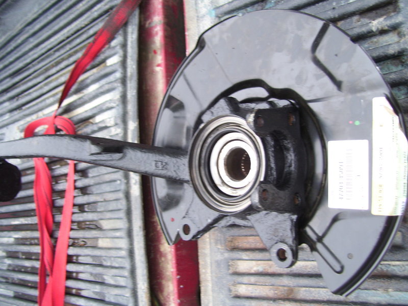

    Passenger side front diff seal was leaking
    * All the above issues were not caused by my dealer, they were due for replacement
    So.....

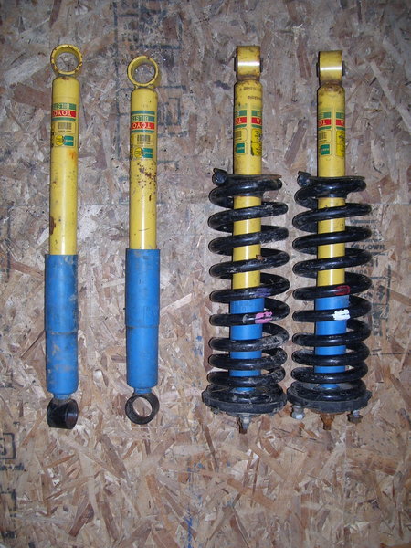

    Tank came out and got fixed and coated, i made some new tank straps.
    I ordered a Magnaflow cat back exhaust Brapppp
    Installed some slightly used TRD shocks front and rear
    New rubber 265 70 16 general grabber AT2
    Went for a front end alignment was told that the inner tie rod end was gone
    All new upper and lower ball joints and inner and outer tie rod ends (the good ones)
    New diff seal
    New backing plate

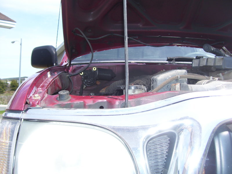

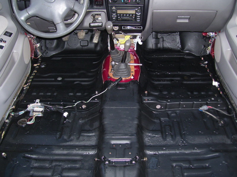

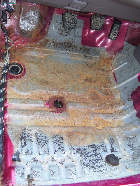

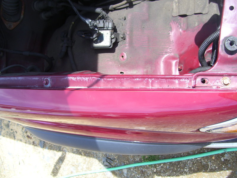

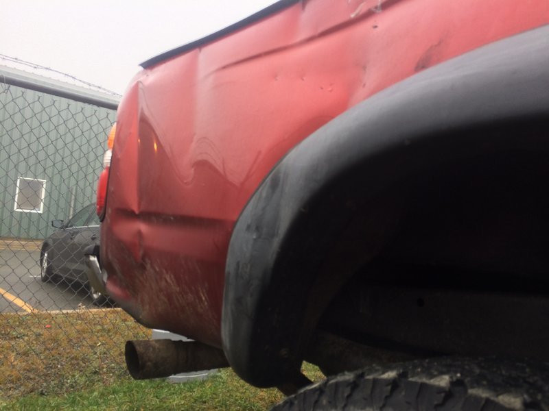

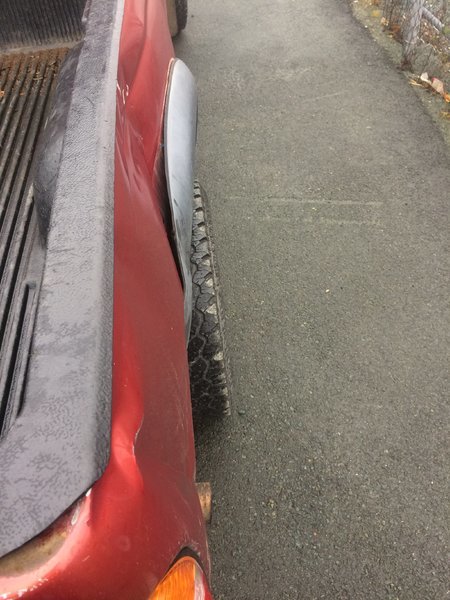

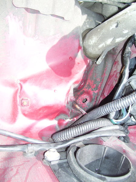

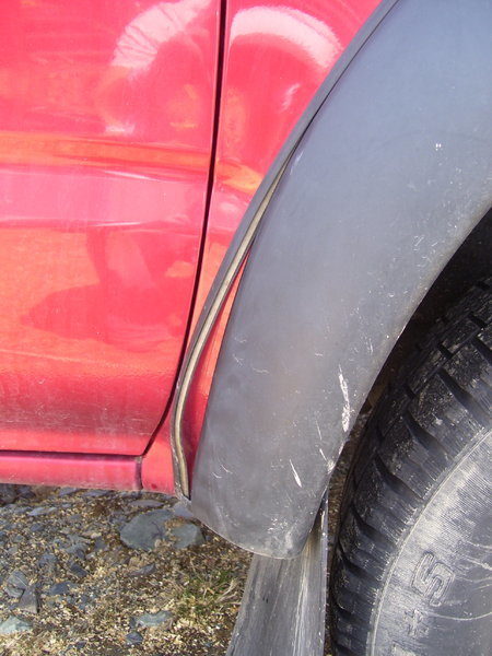

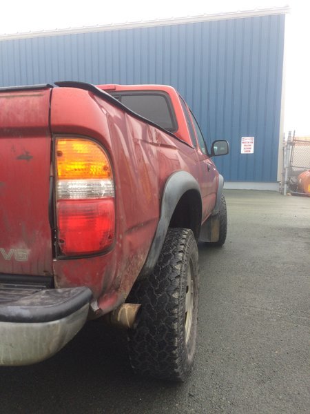

    My passenger side floor was getting wet when it rained, so i stripped the interior and started to wire wheel the rusty spots.
    I noticed a small bump on the pass side floor and took notice but continued to prime and paint, reinstalled with out any carpet as i have a dog and it is easier to clean this way.

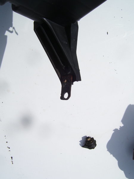

    Time to look into the deck plate mod, ordered a K&N air filter went to install and this is where it went down hill ........
    The ear for the air box that holds it to the frame was cracked off weird
    Their was bolts missing in top of the pass side fender holding it on and a rubber hood support
    Removed the air box and there was a big crease in body under the air box
    Further investigation
    salvage yard bumper
    Head light
    after market pass side fender
    new rim
    explains the bump in the floor, slight vibration at speed, dented gas tank ...
    This truck was in a accident .......

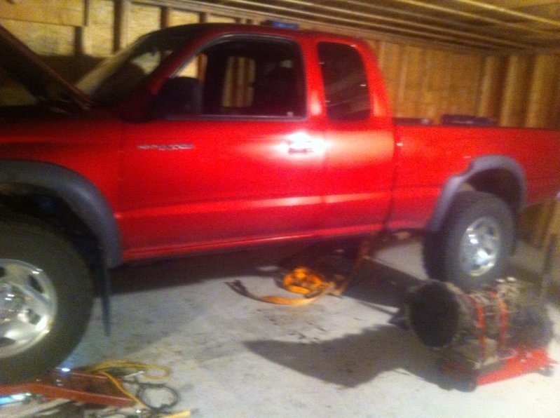

    Ok i am over it .......
    Drove the truck

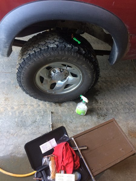

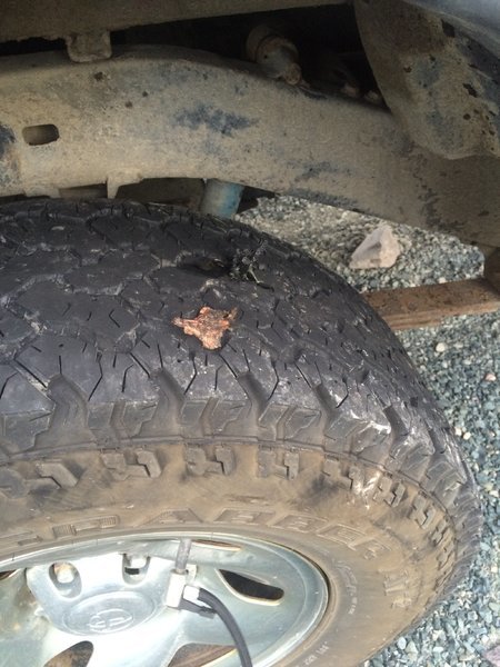

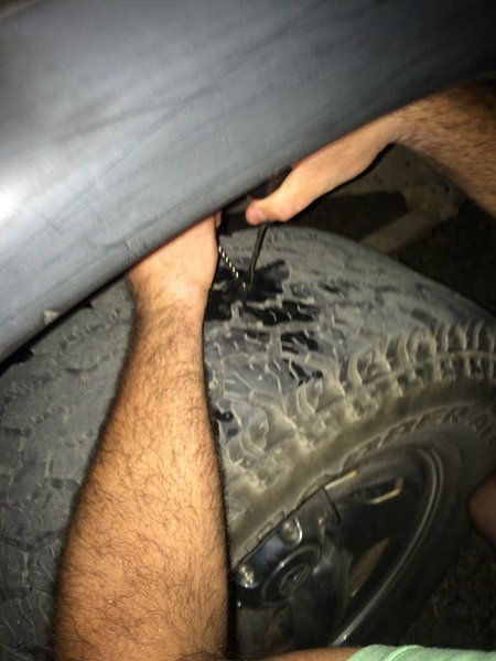

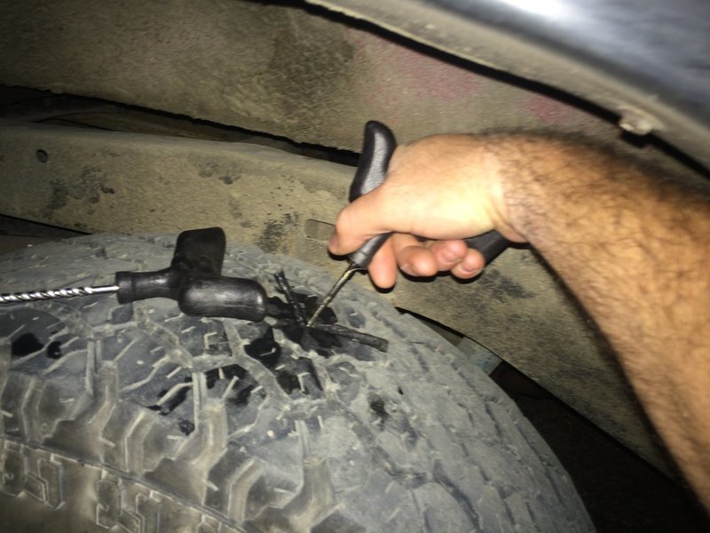

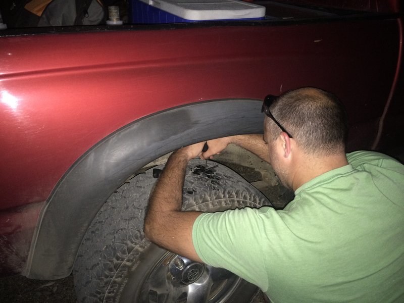

    Ok so where were we ? .... I guess then next thing i should talk about is my luck with Tires .... or just one tire.
    FYI i know that this is ALL MY FAULT and a plug is not the right way to fix a tire so here it goes
    Arrived late one night to my remote camp and pulled in my passenger side rear tire ran over a survey peg (re bar) that was in the ground. My tire started hissing. Out came the plug kit
    Next morning out came the breakfast beer and i drove that sucker in the ground
    Happened Again on the Highway .... More plugs !
    And if anyone if following i have put more plugs in this one tire then ALL the other tires combined.

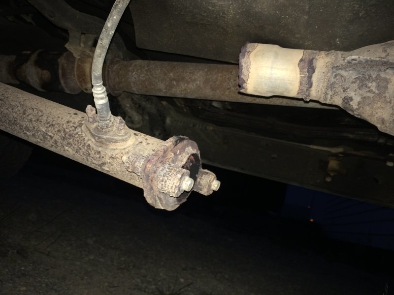

    Moving on ......

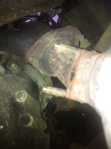

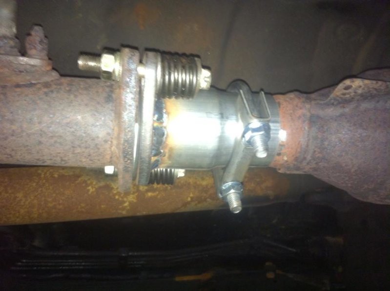

    Had some exhaust issues along the way ....
    The joint where my cat back mounts to the original exhaust keeps rotting off
    happend 2-3 times now in the same spot !
    The NUTS rusted off the O2 sensor and blew it out .....
    Man do i hate RUST !!!!

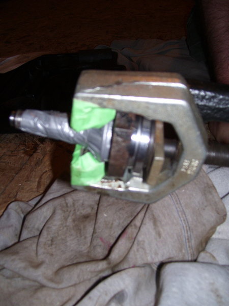

    I guess this was the start of it ....

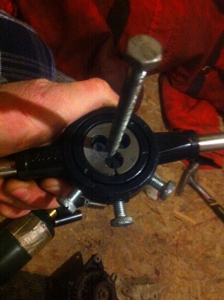

    My belts started to squeal ........
    I looked at the compressor belt and noticed the compressor pulley was not running straight !
    Ac had left long ago so i priced a pump ...... and off came the belt !

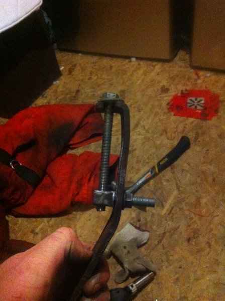

    Problem solved, until winter came my belts started to squeal again FFS

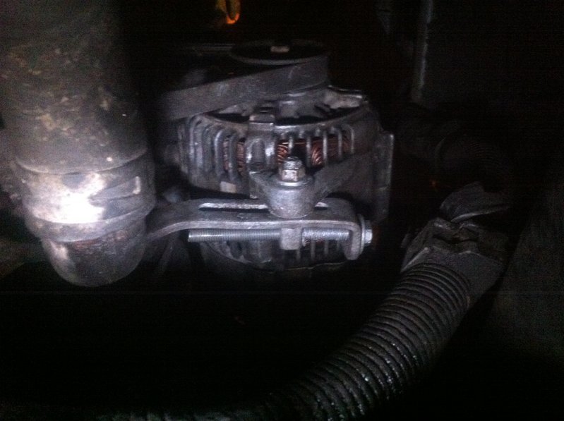

    I took a wrench to the alternator adjuster and sure as shi# the bolt broke off, took it all apart in the dark, in the driveway, in the winter, on my back in the snow ...
    Found a bolt in the bin and had to run a die over it to take the shoulder part off and then trim to length reassemble and adjust belt.

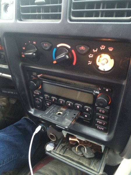

    So I found some more pictures and I added them in almost the correct places.
    Keeping it OLD skool with the OEM tape deck, cd, radio combo !

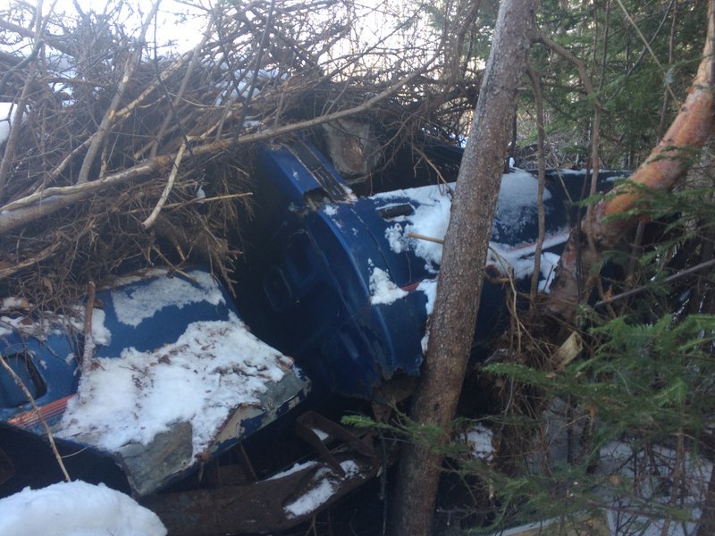

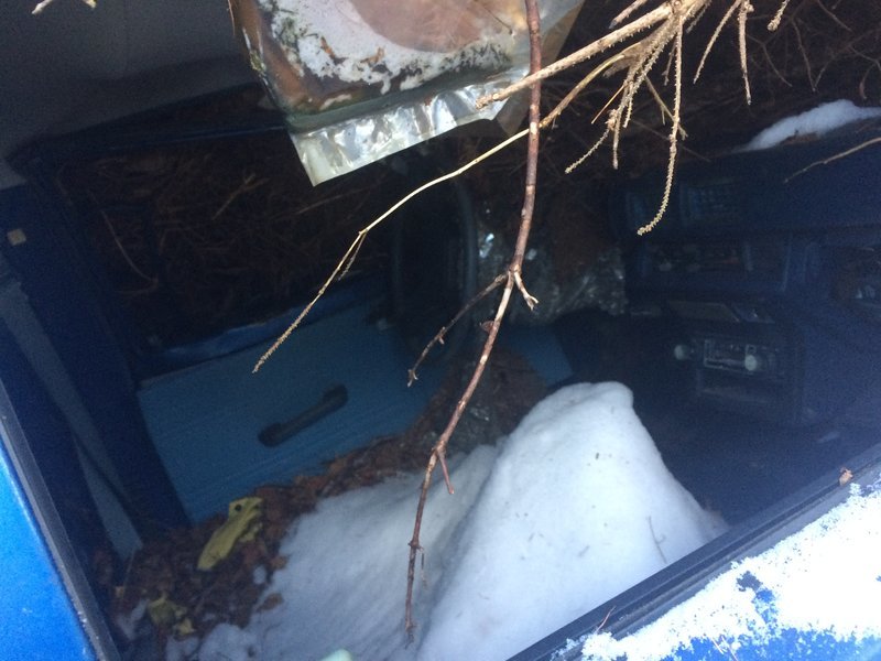

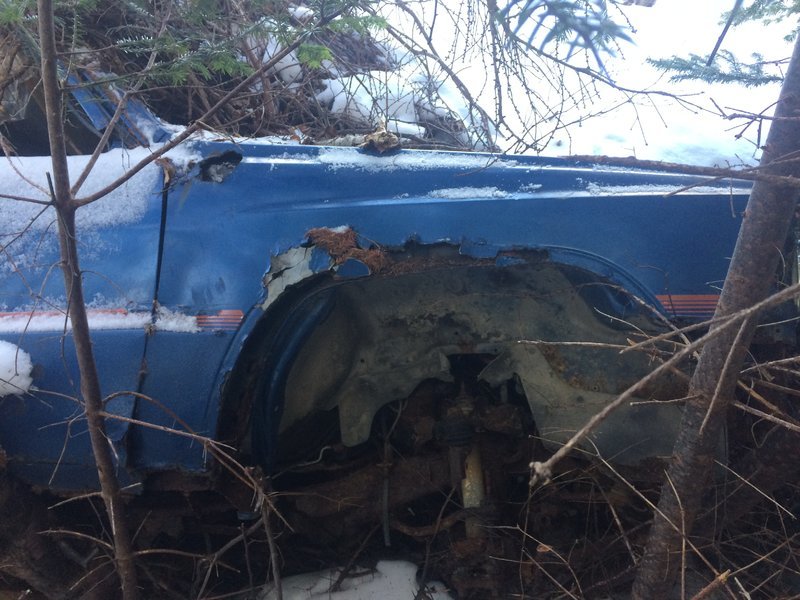

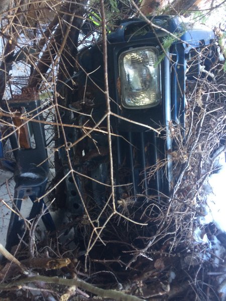

    ADD got me ..... so I went to look at a early 80's 2wd truck in the woods. It is -29 c out side with the windchill so we did not stick around. These trucks are non existent around here. Rare find.

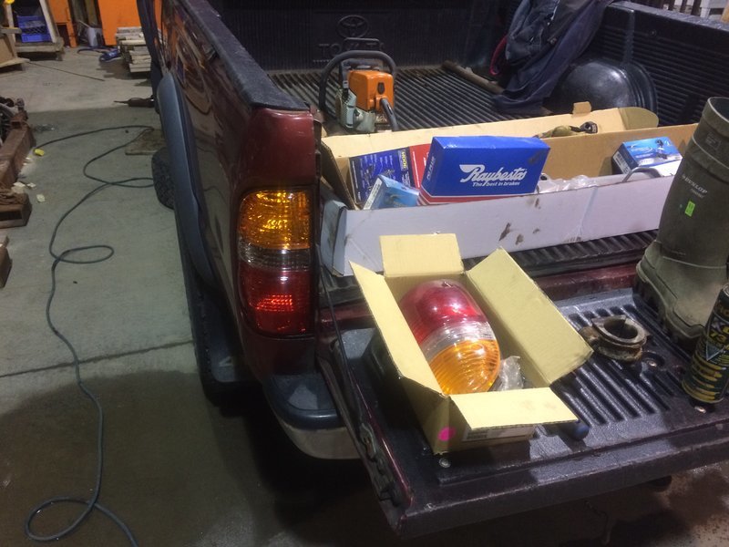

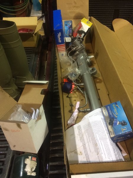

    Way way back when I was doing some work I noticed the power steering rack was leaking, so I filled it up every now and then.
    The temps dropped and the squealing belt was back.
    Leaving at 5:40 Am to go to work with what sounded like a bag of cats under the hood probably made me popular in my neighborhood.
    So I tried 6 bottles of power steering pump leak stop ...... did not work .... puking it all over the underside of my truck .......
    When the temperature doped to the point of snow i guess the THICK STOP LEAK did not want to pump so i had almost zero steering, but when it heated up everything was fine.
    with this and some other small issues i decided to take the truck in for a refit ......
    By the time i got all the parts lined up to do the job my pump was making a noise all the time :(
    Parts ordered
    New powering steering rack
    New pump
    New Tires
    New OEM Toyota belts
    A week before this was all about to jump into my truck a RT180 crane made contact with the box of my truck :( Its only metal and no one got hurt.

    So lets recap
    1. I need new tires (remember the plug story) also has a leaking rack and squealing pump
    2. Tried stop leak and when its cold it did not pump, burnt up my pump
    3. I want a front end alignment with my new tires
    4. All ball joints and tie rod ends have the boots torn and are puking grease (good thing i bought the lifetime ones)
    15781205_10157835532160417_8795342736038606584_n.jpg IMG_1972.jpg IMG_1978.jpg
