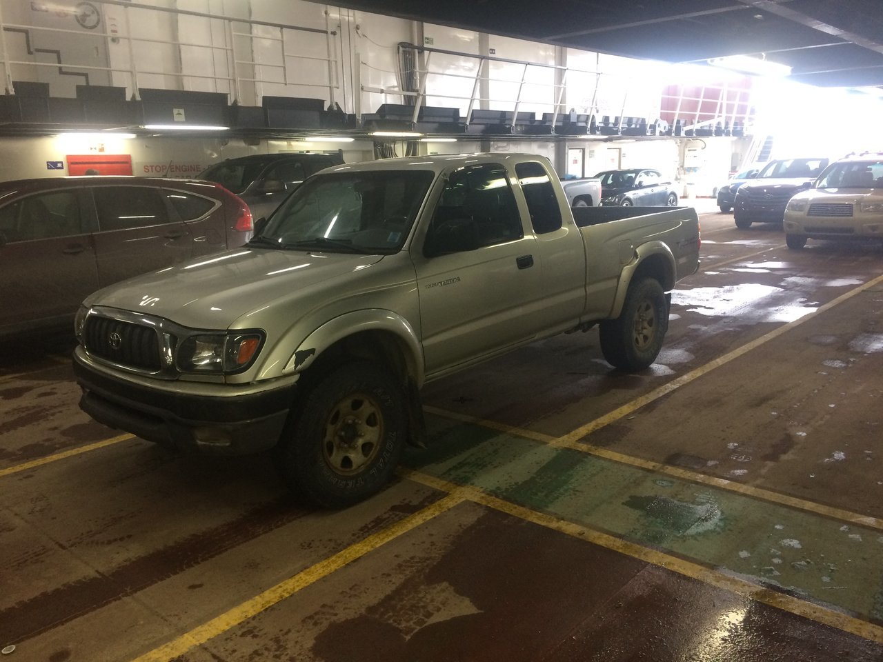

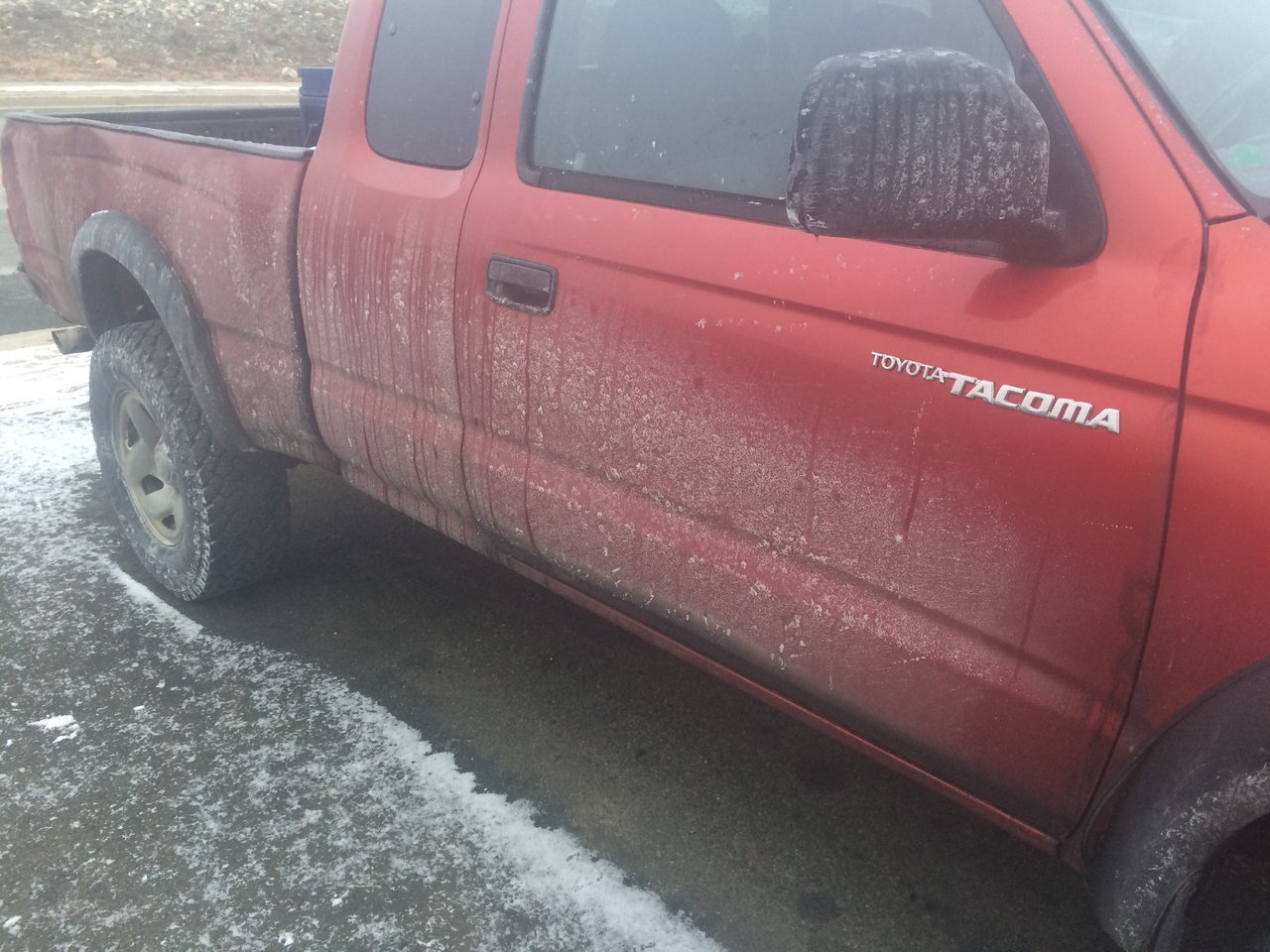

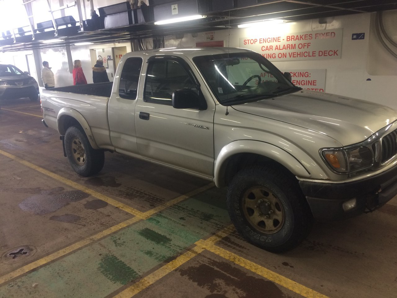

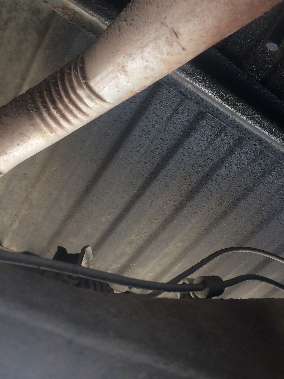

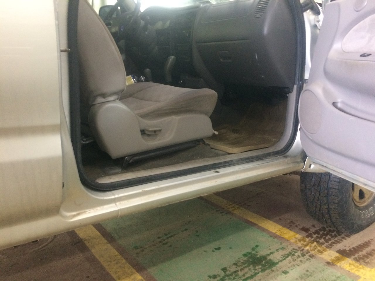

    Someone send this man a sample can of FF once you try it there is no going back. I buy this for $80 and use the whole can on my truck
    Soooooo the bed on the silver truck is good, this is the whole reason i bought it lol. It has grown on me hi ho silver !
    My theory or what i tell my wife is the silver truck is complete and in good shape (also is a auto so different trans, t case, driveshaft, computer among other things), If i get the wrecked one (standard with manual t case exactly like my red truck) i will take the parts i want and ditch the rest. even without the damage the cab on the wrecked truck was bad in spots with a bad frame.
    Or ................... i am a hoarder of Tacoma's

    in my opinion the silver truck body is in good shape for NEWFOUNDLAND

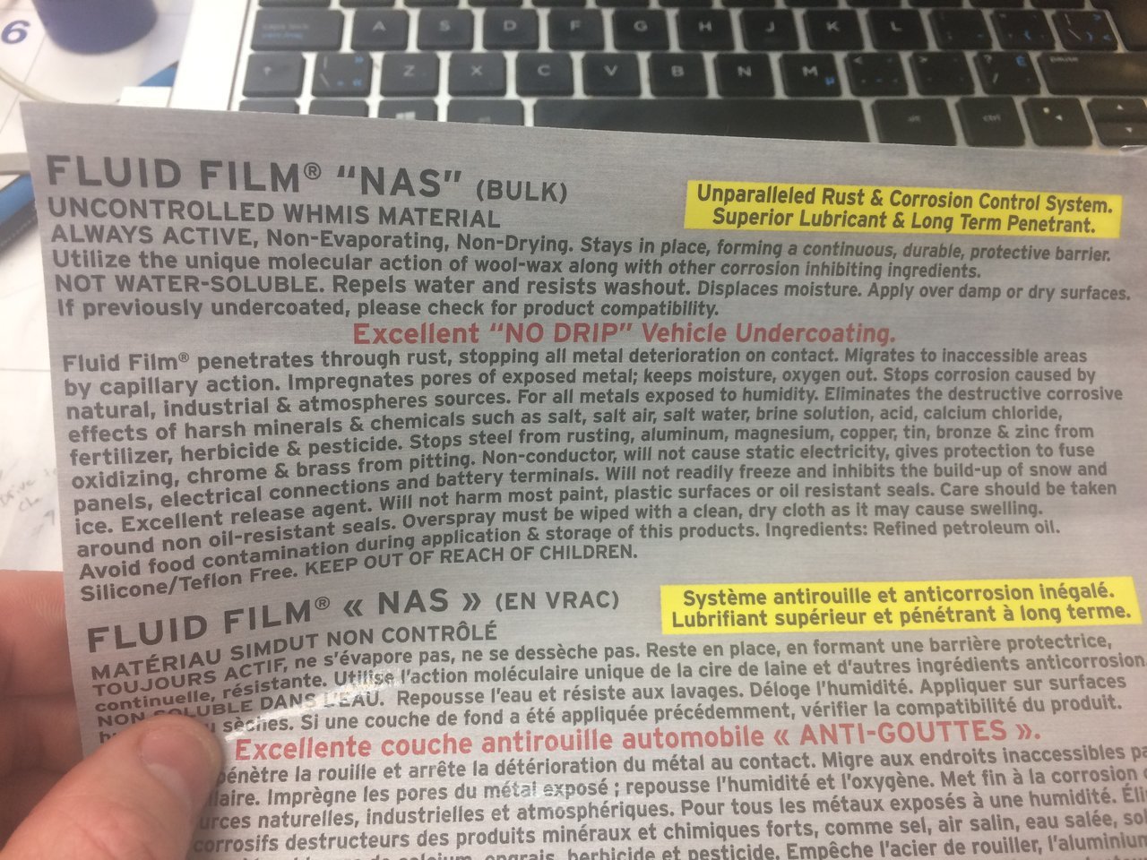

    Please do tell more about this fluid film stuff. I mean, Ive heard of it, but kindof assumed it was for rust prevention - and if youve already got rust starting, maybe its too late for that? But clearly I'm wrong .
    My 2003 has surface rust on the frame and .... well all of the under side. If theres something I can do to slow this down and extend the life of my truck ... I'm all ears!
    And Ive never seen rust like what youre having to deal with out there ..

    Of course putting fluid film on a surface already rusted will slow down the rusting process. In my case I get a rustproof treatment each year at fall. They spray a thick oily stuff on the frame, under the floor, on the insode of the hood, inside the doors, rockers and fenders, where moisture can build up and cause rust, and make those components rot. I am kinda surprise that you don't deal with that much rust being in Alberta lol I know the air is less humid, maybe it plays in the rust game :notsure:

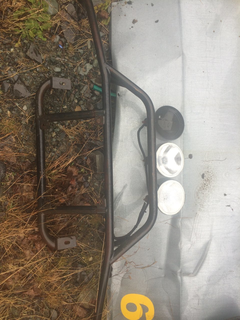

    Got this from a friend to copy it for my 1st gen. It still uses the stock bumper as it mounts to the top. My bumper is shot :(

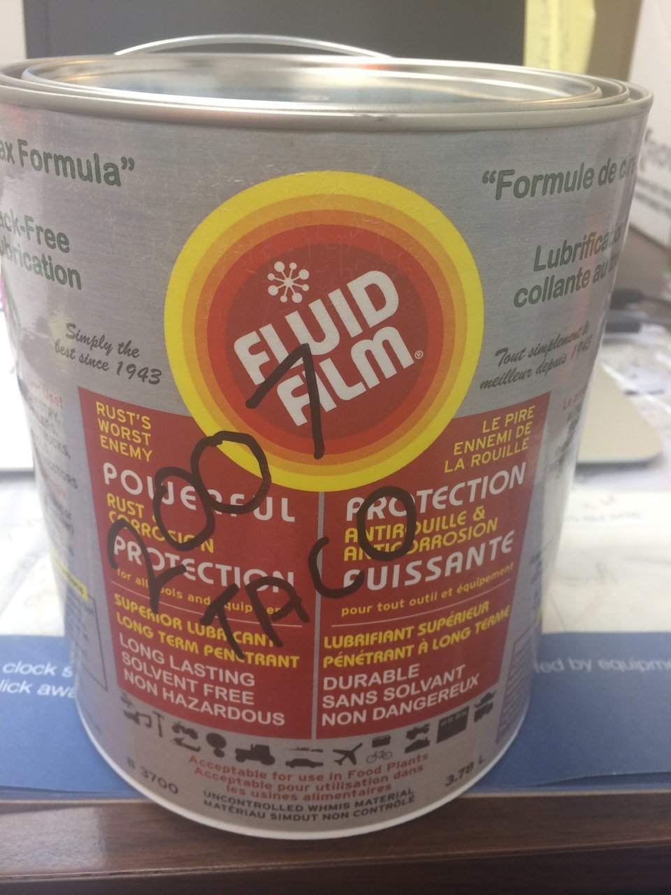

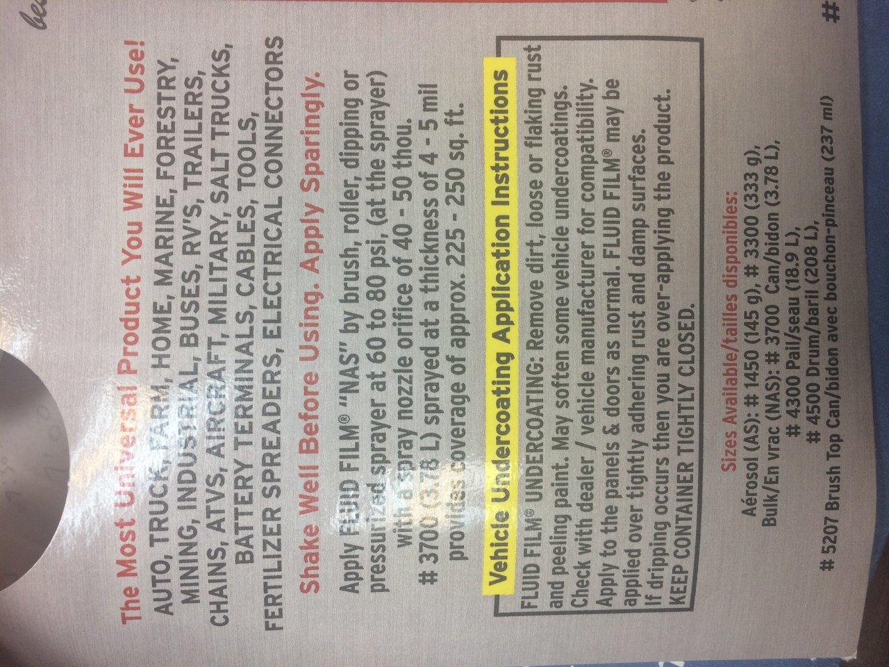

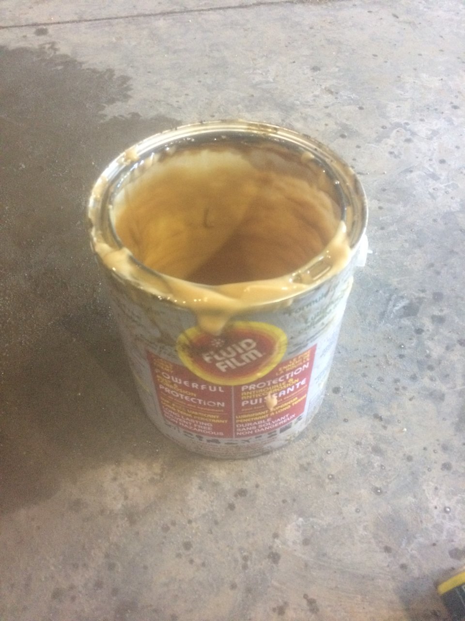

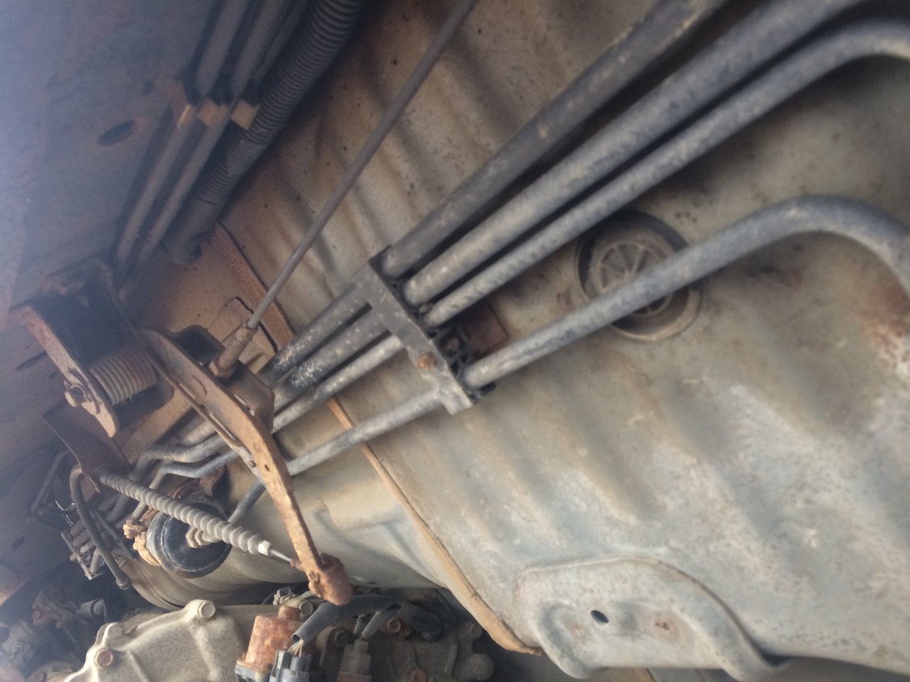

    Sorry I thought I replied but I believe in this so much I just bought my second can for my 2007 that is in getting a new frame. Apply over rust, or while wet and it migrates :) have a read
