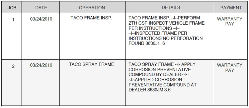

    I just bought my first Tacoma today, I inspected the frame & it was in good shape. I'm already looking out for the future of this truck. The service records indicate the frame was inspected on 03/24/2010 & sprayed with undercoating that same day on 03/24/2010. This was all done by the Toyota dealership.
    That said, what does this mean? If I brought it in to get inspected could I get a new frame or another undercoat? Please advise.

    It's 15 years from the "in service date", not the spray date. The undercoating was required to keep the extended warranty on the frame in force.

    I see you are driving a 2001 Tacoma. Depending on the date your vehicle left the original dealer to the first owner, your extended warranty may very near the end. Have your dealer check it out right away.

    Yup, Left the dealer 05/2001 The frame still in great shape but nonetheless If I did get it inspected Toyota won't do anything ehh?

    Why did Toyota require the undercoating? Lots of speculation here. By doing so they ended the warranty for everyone that did not have the undercoating applied before the deadline. It also gave then a roster of the vehicles which retained the warranty, and a definite limit on their possible liability for replacements. The undercoating did not provide any real protection to the frame, and quickly began to flake off after application.

    Rust perforation of the frame in any one of about 12 key locations. In 2012, my '01 failed the inspection when it went in for the undercoating, and the frame was replaced. My '03 was undercoated in 2011 and is covered by the extended warranty until 2018. It goes in for inspection every year, and so far has passed every time. Once the warranty ends, I will begin to use fluid film or the like to preserve the frame, and I will probably do this even if the frame is replaced. It couldn't hurt when you live in the the road salt belt.
