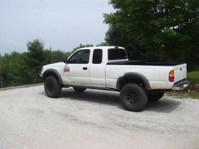

    wow dude that looks way good im especially digging the rear window how much did it cost to get it in?

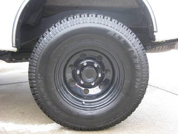

    2ktacopr3runn3r, what rims do you have? Something about them looks odd like the holes are too small or the center of your rim is too small?

    they are wheelers wheels, from wheelersoffroad.com. they have 7 holes instead of 8 and are custom made so that when those holes are cut there is not lip on the backside which is what hits the brake caliper

    agreed! those wheels look really sharp. i love the white truck/black wheels combo. i just installed eagle alloy series 100s (15x8) on mine...
    I've got black lug nuts on there now... the chrome ones were just put on by the shop as temps until the black ones were delivered.
