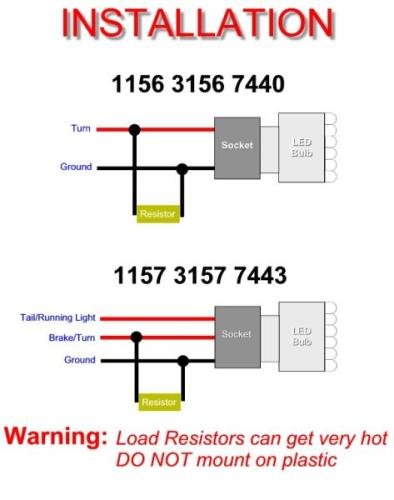

    can you explain how to install a load resistor instead of modifying the flasher relay?
    thanks
    cadman

    I'm not Matt, and I have no first-hand experience installing load resistors :eek:, but here are a couple of diagrams I found when I considered doing so several months ago. (I ended up going with Beau02's "fog light mod" instead.)

    I have never installed load resistors either, but you are just putting the resistor in parallel with the turn signal filament. The pictures Norton posted show this. You should only need one set (two resistors) regardless if you are replacing all four turn signals with LEDs or just two. If you replace all four, then you need your load resistor to draw more current to equal what your turn signals were drawing. Like the diagram says, they will get HOT unless you go with a very large sized (lot of surface area) resistor. The blue clips in the picture are the quick-splice connectors that let you "tap" into the existing wire without cutting it apart and soldering or using wire nuts. They work well, but you have to clamp them together just right for a good connection.
