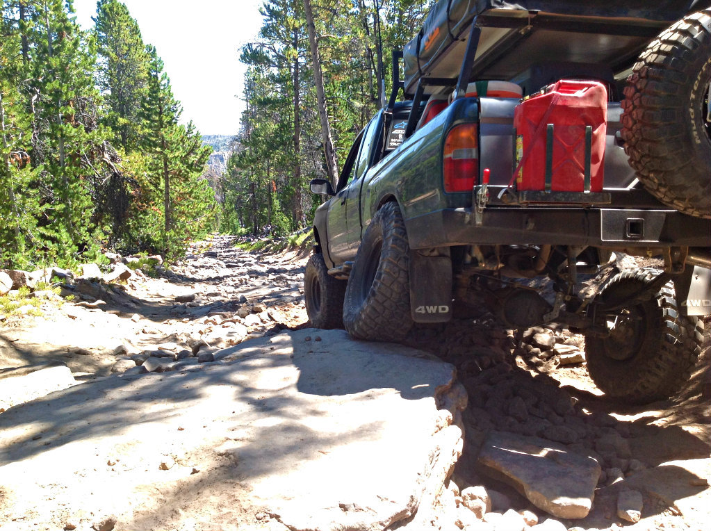

    yea of course..im still in the stock location..plently of flex.
    Still going to relocate though..

    oh really thats tons of flex i should maybe look into a leaf pack or longer travel shocks first then?
