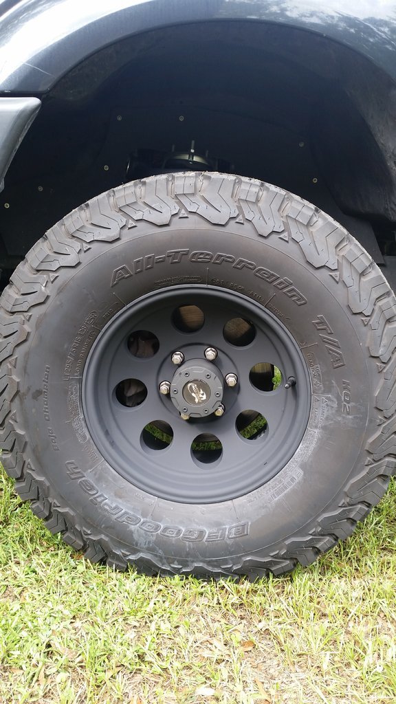

    They indeed fit:)
    Procomp 69 series rims...when called 4wheel parts to order, I just told him they were for an 02 Tundra. 20171007_111508-1.jpg

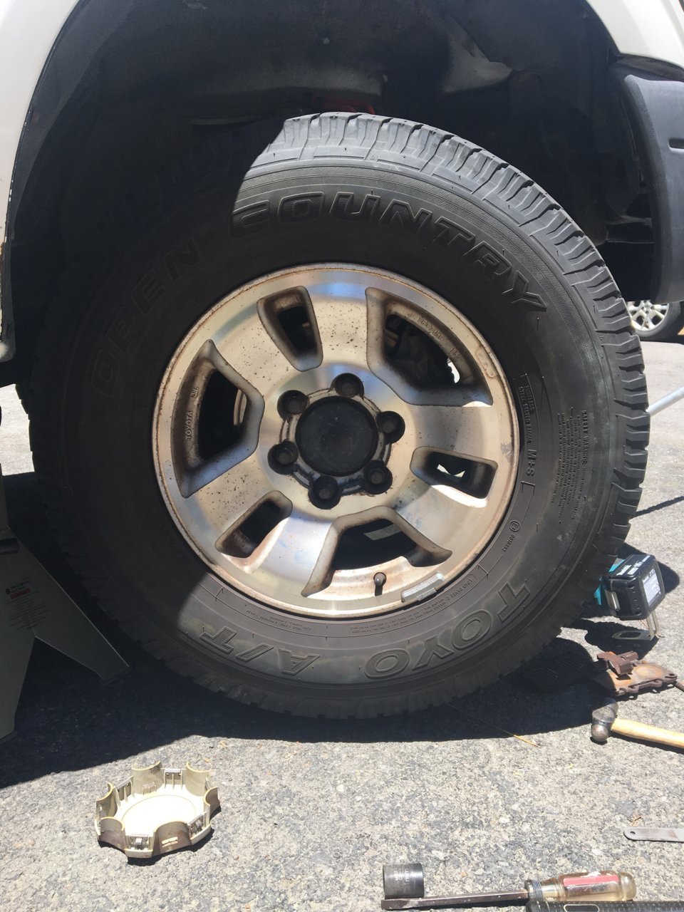

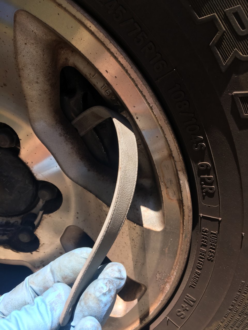

    So, I am trying to get Toyota 16s rims (not originally Tacoma’s, maybe 4runners?) to fit together with S13WE calipers and 199s rotors... and it fits!...but the gap between caliper and rim is not wider than an 1/8”.
    Now here is when I show my fears...does the shape of the rim change enough (let’s say, when cornering at high speed), to start rubbing the caliper?
    I guess I’ll test drive it, to find out!
