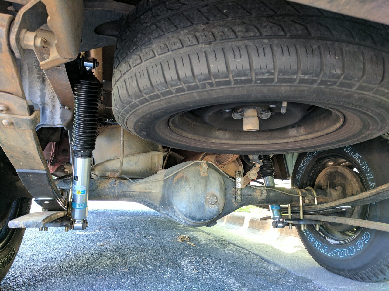

    I went through the same thing with my 5-lugger. I wanted to get Bilsteins for the rear and took a chance on 5125's since the ones for the Tacoma provide a little more lift than the 5100's. You are right that the eye bushings in the shocks don't fit. I cant remember where I found this information, but there are some Energy Suspension eye bushings you can get to make them fit. I am assuming these would work for 5100's as well, but I am not sure. Here's what I picked up:
    Energy Suspension 9.8108G 3/4" Hourglass Shock Eye Bushing
    Here's a photo of them mounted:
    I got the Bilstein 33185590 Shock Absorber for the driver's side, and the Bilstein 33185606 Shock Absorber for the passenger's side. I got the idea from Wheeler's Off-Road website. The passenger's side shock has slightly more travel and is longer extended. You could go with shocks the same length, though. I measured the stock ones at ride height and the passenger side was ~0.75" longer, but when removed from the truck both sides were the exact same part with the same exact travel. My thinking is that as long as you have enough travel you can match up both sides with the same shock, but the extra travel may not be utilized on the driver's side as a result. Some kits have the longer shock on the passenger's side and some don't. Maybe I solved the mystery... don't know, but it worked out for me. I hope that helps!

    I may be wrong but from looking at your picture I think you installed your 5125's upside down... I know the 5100 are installed with the boots up and from what I've researched and per Wheelers off road the 5125's are to be installed with boot down (label should be readable/ right side up).
    Bootselectric and z_thompsonpa like this.

    Wow, thanks! :) I probably never would have known had you not said something. I totally overlooked that during the install. :annoyed:
    That explains why the drain holes in the boots were in the top (in the photo). I ended up punching my own (bottom in the photo). I still have the instructions (which I never read) that came with the shocks to help verify, but glad to know somebody is looking out.

    lol... I wasn't going to correct him.
    I remembered my reasoning for installing them upside-down... It was the orientation of the stock shock absorbers. I also remember thinking that the logo being upside-down was a little odd.
    Would you guess the Bilstein instructions included in the packaging don't mention anything about mounting orientation?
    They only mention installing them wrong is dangerous.. a full page of safety warnings and then repeated in all the languages of the world... Useless!
    I have since confirmed what @Shubin stated, though, here.
