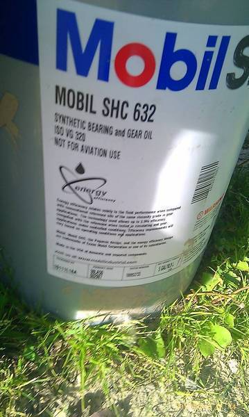

    2011 trd off road
    anyone know it this gear oil is ok? No lsd. we use all the time in mining equpment, gear box ,planatary gear. seems to work good for that
  16. Oct 28, 2012 at 10:44 AM
    #16
    aficianado
    aficianado Well-Known Member
    Oct 27, 2009
    #25015
    8,424
    bay area, california
    2006 access cab. 4x4, TRD-OR + 2023 TRD off-road.
    back to bone stock.
    Does it say GL-5 anywhere?
